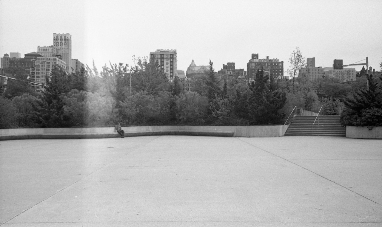

  1. Okay so, a month ago, when I had my M3 serviced (again), I wrote the following post: So the 2nd and 3rd issues (since they are owing to the same reason) I mentioned in the previous post still remains even after the service this time round. The photo I uploaded here is one of the 76 frames that I only took a bright sunny blue sky to test the performance of the shutter. (I’ve used two rolls only for this, they look practically almost the same so I only present one here). The settings were f/8 and 1/1000s (ISO 400 film), and the lens was Summicron 50 mm. We can assume that vignetting can be ruled out. You can see the left upper side of the frame is much darker than the other part of the frame. The right side of the frame is also slighted darker probably because of the same shutter issue, but it is not as severe, so let’s ignore that for now. What I wanna ask you is, if you were me, would you just ignore this shading issue and just use the camera or try your absolute best to fix this? Somewhere in RangefinderForum, I read someone saying “even at Leica, the tolerance limit for the 1/1000 shutter speed is 20% as it is prone to be out of calibration”. (Link: https://rangefinderforum.com/threads/leica-m-1-1000-uneven-shutter-issues.79230/) Also, the experiment was conducted under a very extreme conditions, so I presume in practice it won’t be as noticeable. Additionally, I’ve seen many people saying that even for newer Leica M film bodies, the 1/1000 speed tends to be an issue quite frequently. Considering all this, does this seem to be an acceptable condition that you’d use this camera after biting the bullet, or would you try your absolute best to fix this issue by trying other servicemen as many of you suggested? I’d like to see what you guys think. Thank you.

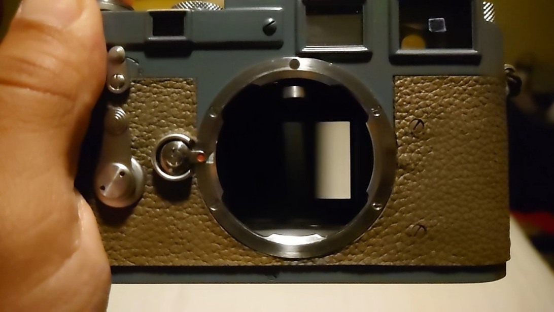

  2. I'll try to make it short so that people actually care to read. I wonder how many people, M3 users in this forum, have experienced shutter-related issues with their M3. In my case, I've had: a problem that the images have some faint horizontal lines across the frame uneven exposure across the frame (i.e. broad vertical lines/shades) Shutter capping (i.e. complete darkness on either the left or the right side of the frame) Important point I want to emphasise here is that I've always had a Leica-certified serviceman fix my camera (Camera Doctor, Mr Kim; I live in Seoul, Korea, if you know you know). happens owing to the dust particles stuck between the shutter curtains, according to the serviceman; a simple cleaning job will fix this issue, he said, but even after doing so, it happens quite often. (Refer to the first pic, in the foreground, you can see it more clearly) happens a lot, especially at the higher shutter speeds (i.e. 1/500 and 1/1000 s). This happens in various styles, but the most common one for me is that the left side of the frame appears a bit darker than the rest of the frame. I know this happens because the shutter slit distance is not consistent during the movement. (Refer to the second pic, you can also see a faint horizontal line as well, probably owing to the first issue) happened only once, and the weather was very cold, almost close to 0°C. The camera was serviced, and it has never shown the same issue (just yet), although I have yet to test at such a low temperature. "2" happens the most and irritates me the most, but my serviceman said it is inevitable since the camera is very old, so the inside mechanism has been worn out, which causes the inconsistent functioning. I then asked him would I be better off buying another M3 body, but he said my camera is actually in good condition considering the age. What I want to know from the M3 users is how many of you have experienced this problem with the shutter mechanism, and how did you deal with it? Would be nice to know if this is a common problem that I just need to concede and carry on, or if I've got the shit one and been unlucky. This is not a scanning issue as this same problem appears on different pics as well. This has been a problem for me, I’ve posted a similar issue about a year ago: here (Reddit post) And then as you can find in the comments of the post, someone else reported a similar problem. It happened with an M6. M6 with the same problem (Reddit post) I honestly just wanna use the camera and enjoy the photography itself without worrying about how the image will turn out every time I send the films to the lab, because each time I found some faulty photos, it just takes me back and makes me not want to do this hobby anymore (let alone the increasing price of the films). Since I love 50 mm so much, getting other M-bodies is also not really a solution for me (again, that will cost me a fortune as well). Thanks for reading this long complaint. I hope I can find some answers and peace.

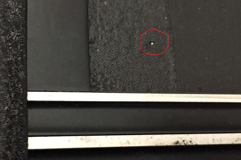

  3. I just got this very clean M3 and I’m experiencing these unusual light leaks. I have shinned a light inside and tried to find the source, but I can’t figure it out. I thought it could be the curtains, but they look brand new. Any ideas?

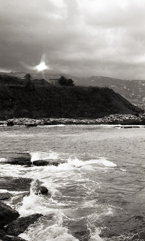

  5. About a year ago, I had my M3 CLA'd after sporadic shutter problems caused results like the overexposed bar in the first example. After about 10 rolls of film, the "bars" are back, (happening once per roll in the last couple of rolls) along with the over exposed "bar" at the far right of the frame shown in the 2nd example which I believe are limited to exposures made with 1/500th or 1/1000th of a second. The latter problem can actually be seen by dry firing the camera as a bright "slit" on the right edge as the shutter is closing is observed through the open back. My question is should this be happening so soon after an CLA? Is there something inherently irreparable in the shutter mechanism?

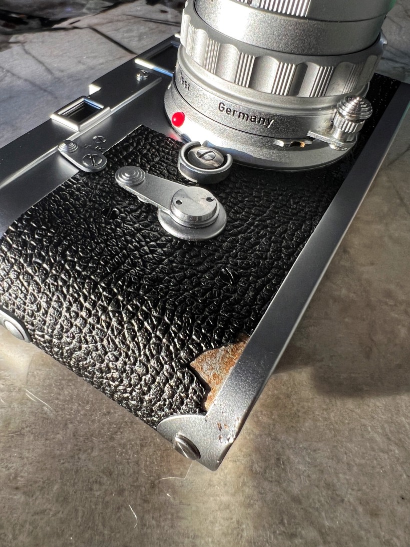

  7. Hello All, About 4 years ago, I came into the possession of a Leica M3 (Double Stroke, 735 xxx) after my friend found it in his grandfather's basement. Anyways, I immediately noticed that the vulcanite had already started chipping off the body due to the conditions which it experienced while not being used for nearly 15 years and I (of course) I wondered if there was any way to remedy the detection of the vulcanite. Now (four years later) I'm wondering if I should re-vulcanize the body or if I should leave it alone. My main issue is not the fact of shipping it overseas to be restored, but rather the value lost. Will it lose much value if I were to carry out re-vulcanizing the body? Or Should I not even consider this and just leave it alone? - Kevin

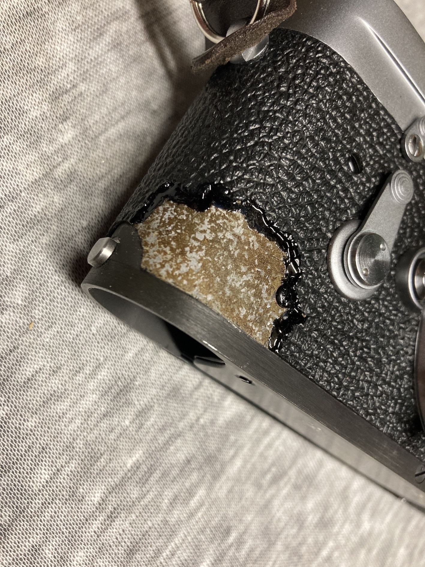

  11. After learning here about Milliput epoxy to repair missing vulcanite, I did a first repair yesterday on my M3. I'd put a kind of superglue along the broken edge while waiting for the epoxy to be delivered from the UK. For the repair, I cleaned exposed metal with goobegone and scrapped lightly with a small flat blade jewelers screwdriver. The Milliput mixes and goes on fairly easily wearing rubber gloves. I used a flat end of a chopstick that was moistened with water first for the coarse application and then used a wet cotton tipped ear swab to smooth it out. The attempt at making the textured surface was with metal dentist teeth cleaning tools -- which only sort of worked... Photos are attached. To try and avoid future vulcanite damage, I picked up two OEM leather cases on eBay and modded one so that only the body part is left on the camera. One side benefit, one that may not be the reason for a leather strap sewn into the inside of the case, is that I'm using it to hold the film box end. Rod

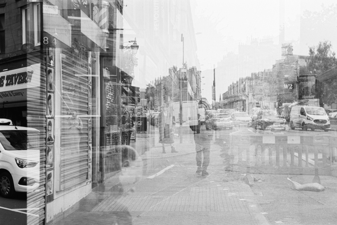

  13. This is my first forum post. Apologies if this is the wrong forum for my question--please tell me if I should post in another forum for this. I inherited my grandfather's doublestroke m3 and started to return to film photography with it. After reading lots of reviews, I bought a new Zeiss 50mm Planar f/2--it is generally reviewed as exceptionally sharp. I just got back my first few rolls of film think that the images all suffer from a softness. I know there are several variables at play here, but I wanted other opinions on how to trouble shoot this. The images were shot on Kodak Portra 160 and professionally developed. I scanned using my Epson v600 with silverfast 8, 3200 ppi. I also have a medium format camera and have gotten extremely crisp images using the same setup. The leica/zeiss images all seem soft to me. I'm wondering if this is 1) a focus issue, 2) some defect with the lens (purchased new over ebay from Japan), 3) a scanning issue, 4) this is normal for 35mm film scans and my expectations are biased by coming from medium format. I do no think the softness is due to camera shake because I'm seeing it in all images and they were mostly taken at a shutter speed faster than 1/125. thanks for any advice. Here is a sample image: and here is a 100% enlargment.

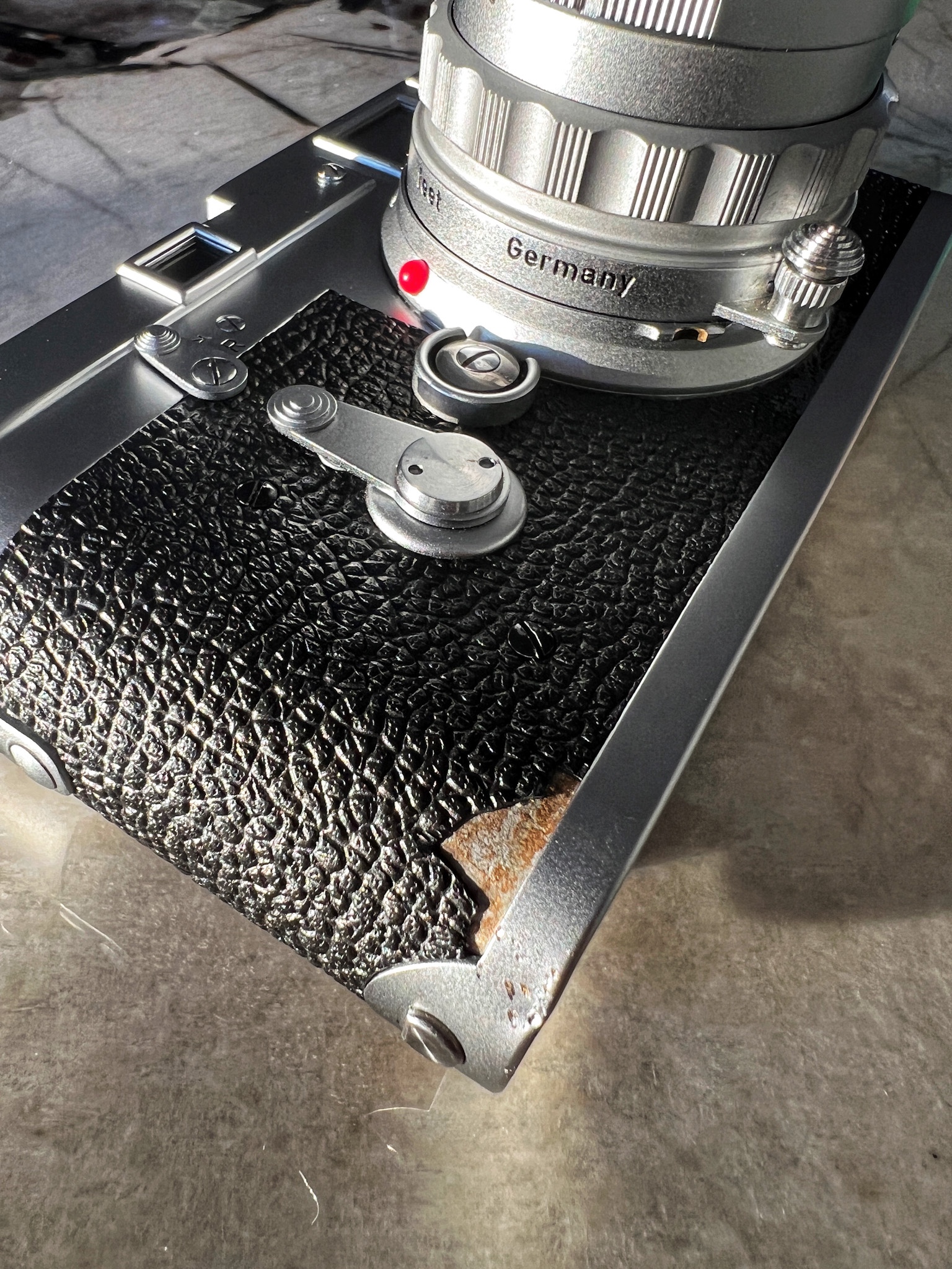

  19. I recently bought a one-owner M3 DS with a DR Summicron from an estate in Chicago. The camera and kit are absolutely lovely. The only issue is that the vulcanite was flaking off with every time it was handled. I finished peeling it all off, mostly with my fingernail, and cleaned the remaining adhesive off the body with acetone. I ordered a dark blue leather replacement cover from Morgan at cameraleather.com. He was responsive and helpful and I had the new leather in my hands in about five days from the date of order. Exceptional service! And the leather... oh my... it's gorgeous. Total install time was about ten minutes, and that with me trial-fitting it and figuring out how I was going to do the install. It went perfectly. it was simple and easy. And I think it looks amazing! My first M body was an M3 in 1974 that I promptly traded back in for an M2 that developed a severe case of fungus when I lived on Guam. Since then I've had an M4-2, M4-P a couple of M4s and another M3 or two (and an M8 and M9P.) My vision got so I couldn't focus the M4-P/M8/M9P well any more so I sold them in 2016. A conversation with a friend recently about the 1:1 finder in the M3 and the differences from the later finders got me to wondering if it was different enough that I could still use one, and much to my surprise, I can see the focusing patch quite well in the M3. It pleases me to have an M again.

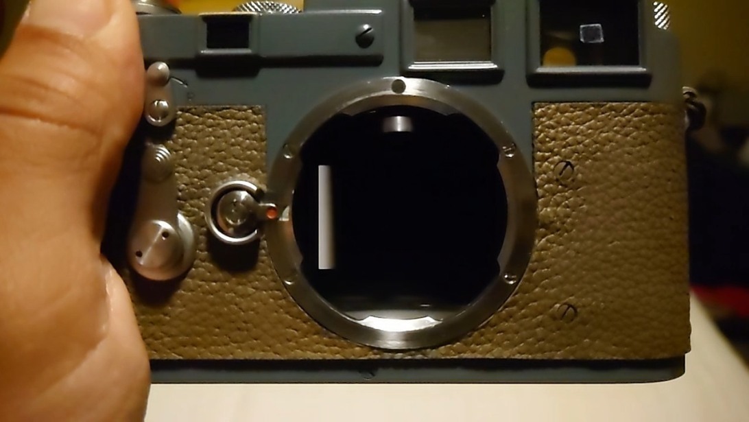

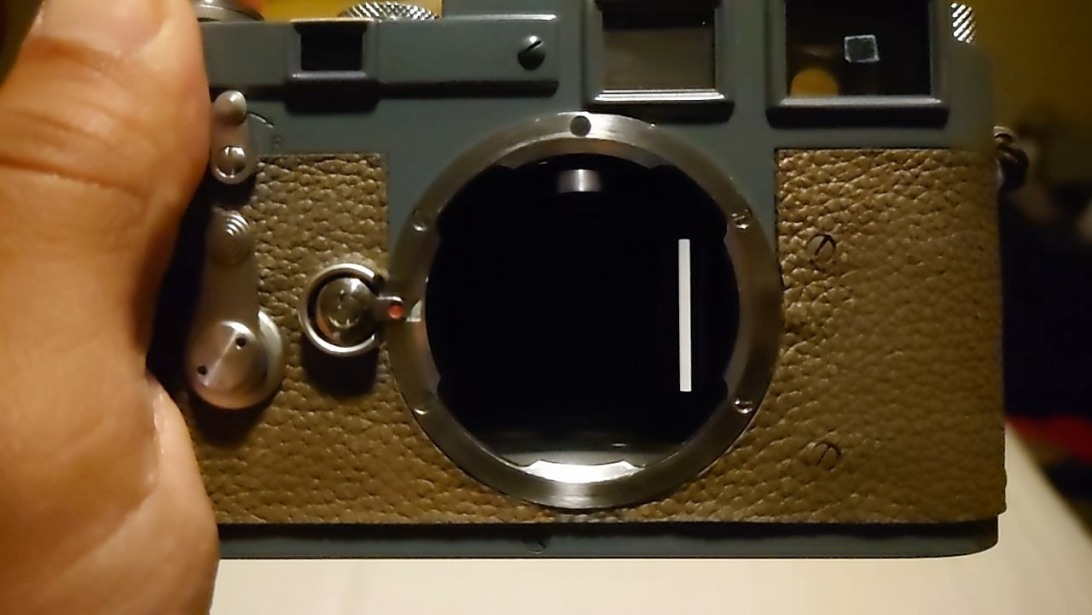

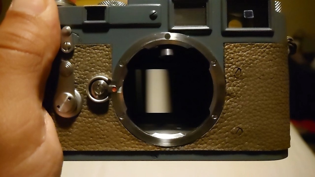

  24. Hello friends, I seem to have an issue that is not entirely rare. The cloth focal plane shutter curtain seems to stutter, or even bounce. I have searched this issue prior, and I guess "bounce" does seem to be the syntax for this certain phenomenon. I have included a clip of the shutter at 1/500 from a slow-mo video I attempted to take on my phone. I also scrubbed the video and took a screenshot of every frame that contained the movement of the shutter in the video. And to my surprise, by looking at the past two frames, the shutter does indeed appear to "bounce". The shutter seems to travel the full distance, with the second to last frame capturing the almost fully relaxed shutter. But then the last frame shows a larger gap of light appearing again. Not ideal. I noticed on a couple photos I took, a bar of overexposure on the right side of the frame. Since this issue is well documented and the solution known (CLA baby) my purpose for cluttering this forum with a much too common ailment was to possibly learn what could cause this? To make this already long winded post windier; I purchased the camera from Shueido Camera back in March 2022. It was supposedly CLA'd before sending out. The camera did come in, visually, absolute pristine condition. The first test roll I shot didn't seem to have any issues. But then I went on a 10 day trip to Iceland. Almost none of the photos I took in Iceland had the bar, but with overcast, cloudy days, I was most likely shooting at 1/250 and lower. (From what I understand this issue comes alight mostly at 1/500 & 1/1000 (increased tension for high speeds?)) Upon returning to the land of America, I shot some random pictures around me to finish off my last roll from Iceland. Almost all the photos exhibit the nefarious white bar of sadness on the right edge of the photo. Now, this is Florida, during midday, in summer, so one could assume almost every photo I took was at 1/500 and 1/1000. Could the Leica's foray into the land of Fire and Ice been too much for it's old bones? Could the 10 days of constant cold (I camped for the duration of my stay, so my new buddy did not spend much time in a comfy, first class, heated environment) affected this old tools mechanism, summoning the frosty ghost of over exposure? Thanks for even reading this phone typed, mental diarrhea. I know I have to get it CLA'd, but it is just simply a bummer that a camera would need a second CLA in one year. I'm hoping to figure out how this may have been caused so I may avoid bringing this problem back in the future. MOV_HFR_120F_20220723012348~3.mp4
