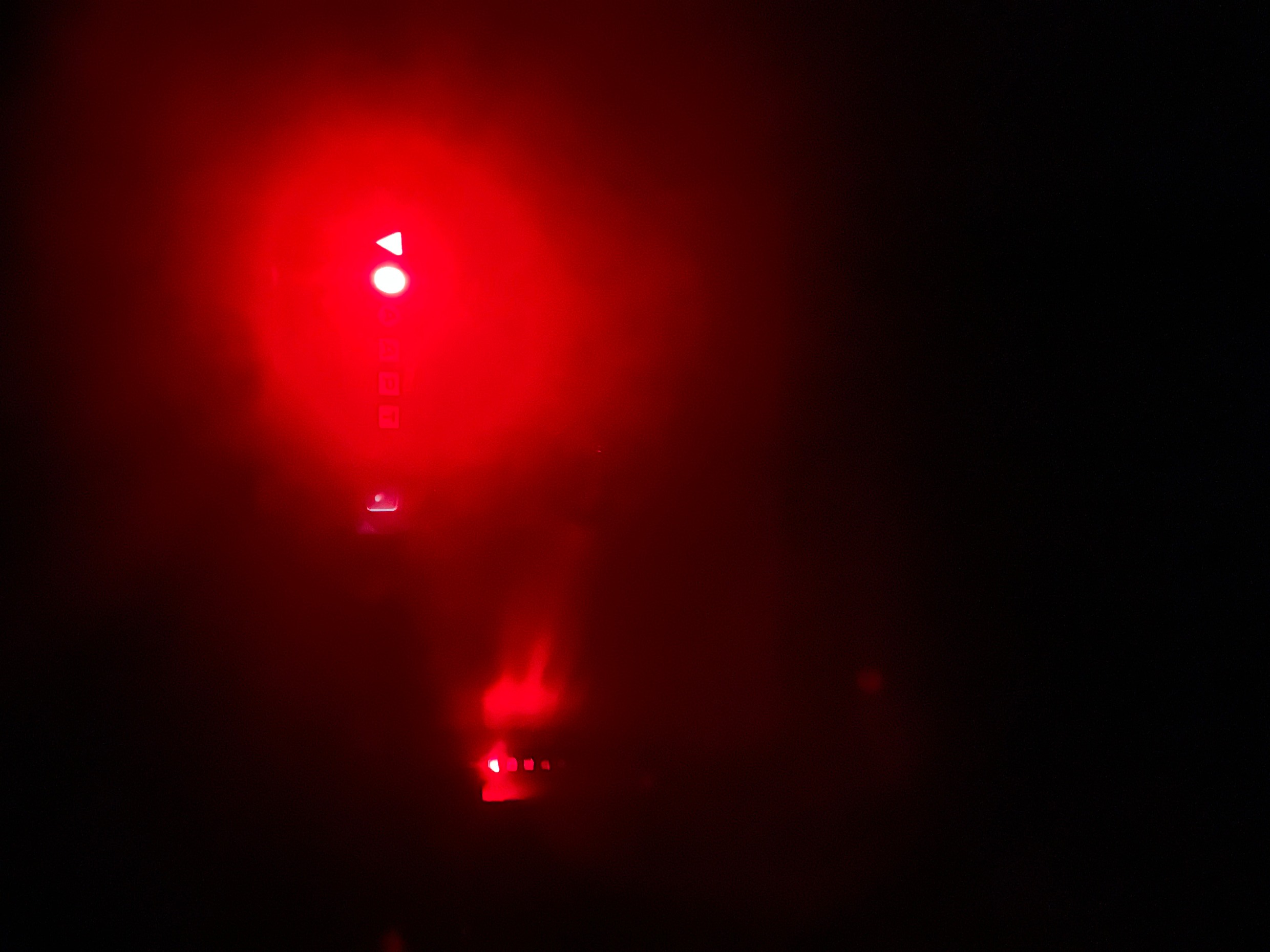

  1. Hello, I have had an r4 for a while now and have encountered a problem where the meter does not fully turn off. A can be seen by the images attached, when noting is pressed on the camera, the mode light stays on. whenever a button is pressed, the rest of the meter turns on and the brightness of all lights increases. The camera has no other electrical issues and has new batteries. serial number 1613662
