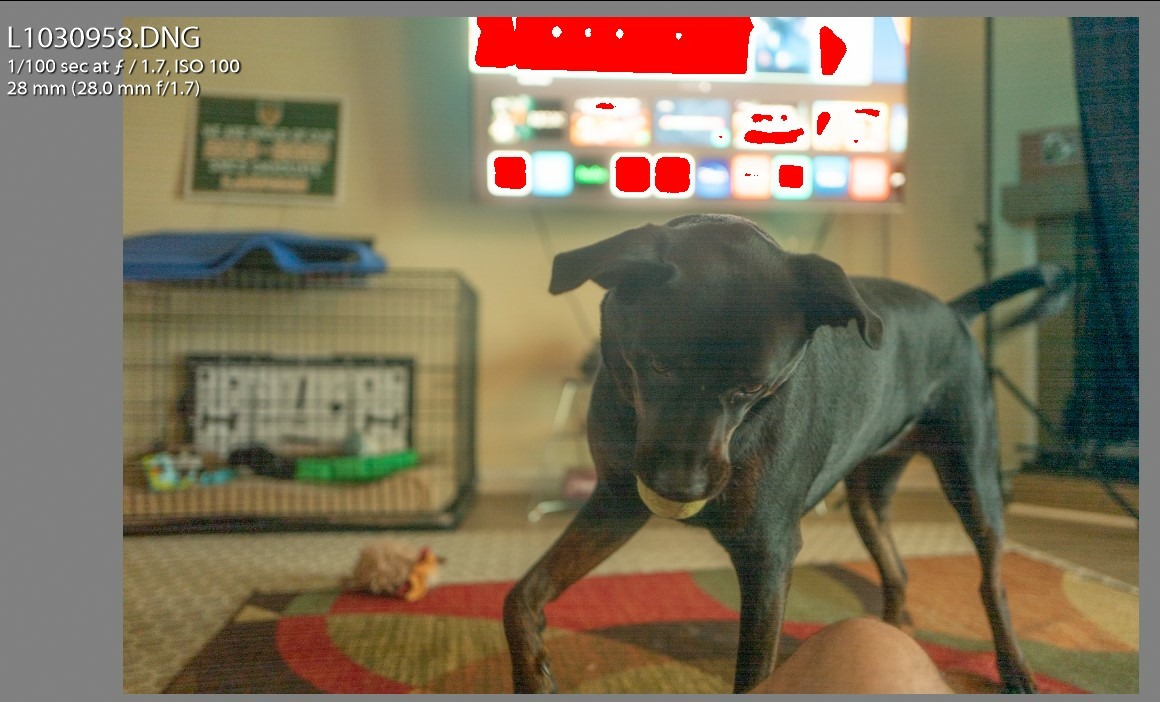

  3. I took a very underexposed shot and tried raising the exposure 3.4 stops, and I expect noise, but what are these horizontal lines? Is it normal? This was taken with my 'new' used LeicaQ. Is this expected? I've never seen this before, and I've definitely shot underexposed before. Should I return this camera? Is it defective? Thank you!

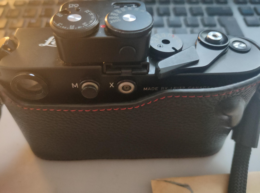

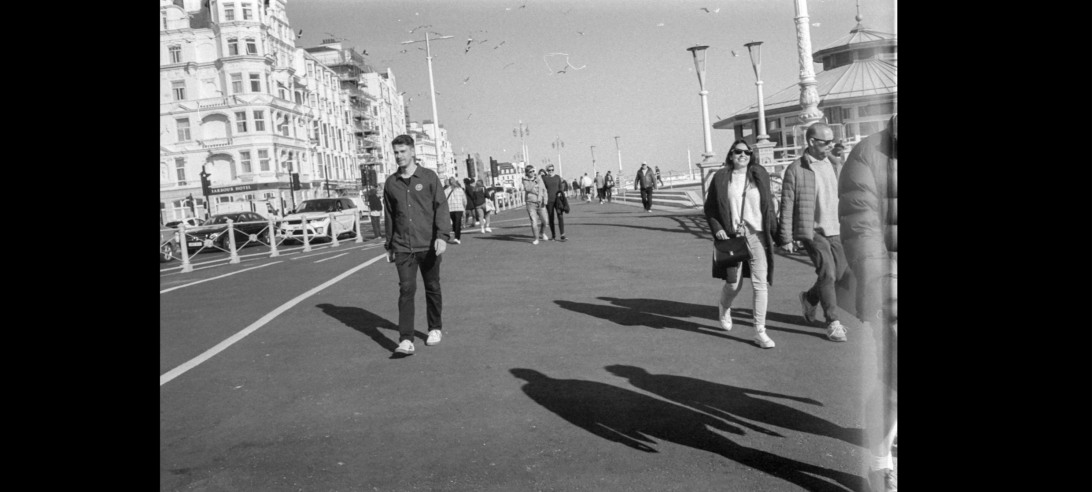

  5. I was wondering if anyone could shed some light on a light leak issue I have with my m4p. I use my camera for street photography, so I walk around with the lens cap off. I also have the camera in a leather half case, which covers the back door. I seem to get a light leak on random frames, from the bottom right hand corner. I figure it can't be the door as the rear of the camera is covered and the sills look in order. Has anyone experienced similar faults or have any remedy suggestions prior to sending it off for a repair?

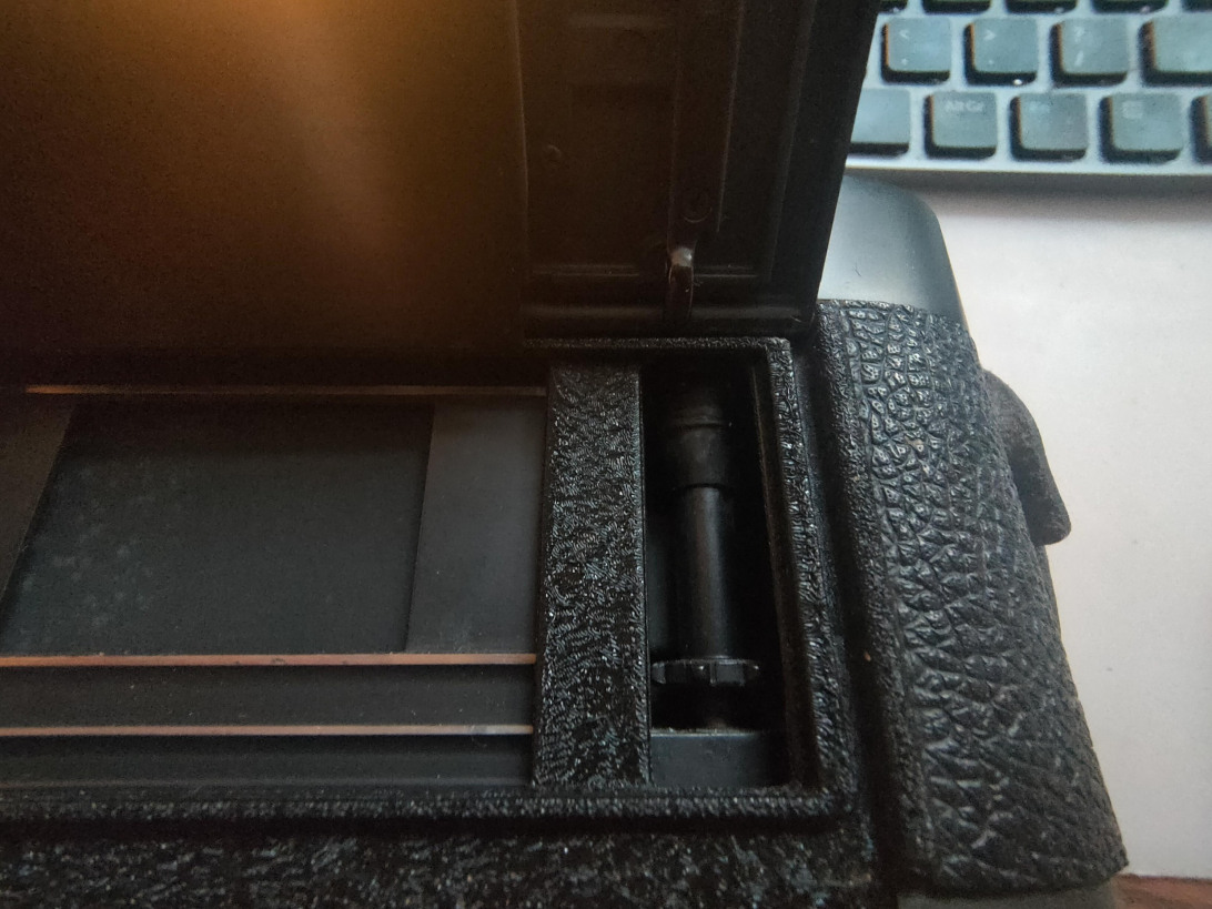

  7. Hi all, Just had my M6 CLA’d due to a light leak around the shutter curtains. They are demonstrating some curling and leave a light leak when a frame is left in the gate for too long. The tech replaces the baffles among other things but I can still see a bit of light at the edges when shining a bright light. He claims that is normal and his other Leicas also have this. Can anyone attest if that is true by checking your shutter curtain edges when shining a bright light inside? much obliged Boe
