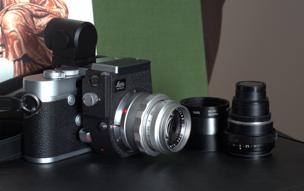

you need to move forward your 280 lens about 40-41mm depending on the mount (1mm for the 39 LTM to M mount).
Or like me use the Visoflex III to fill the gap ...to use Visoflex lens which the Telyt 4.8/280 is from this original family (link to the Visoflex lenses (of Wiki).
this list of accessories to have an idea of the complex original Visoflex using ( this link ... )
even then I don't see easily which one to use as 40-41mm ring
or maybe stacking four OUFRO (1cm ring)

Hello,
look at my picture in post #9 : the final component is a ring from Novoflex (you can see the brand name on it) : it is called LEM/VIS and is currently listed by Novoflex, even if different from the old version that I have : the current version is a set of stackable rings : when complete, it has the length of a Visoflex II/III (like my one, which is single piece) ,
At the bottom of this page from Italian dealership you can see exactly your Telyt 280 with the ring set https://www.novoflex.it/pagina.phtml?_id_articolo=1968-Adattatore-per-Visoflex-IIIII-e-tubi-di-prolunga-in-un-solo-kit!.html  ; Novoflex are well built accessories, no cheap but trustable. Maybe on ebay or similar you can find the previous version like mine... in my opinion it is more nice to use for a long lens, where the need is simply to have the Visoflex equivalent length : the current version is more "flexible" because you can use its single rings as extensions for macro with normal M lenses (like 50/90/135) - they act like the old Leitz OUFRO.
The Visoflex mirror box is a sort of must for lovers of Leitz collectibles 😎 (and mandatory for no-EVF Leicas) but...well... not easy to manage as a ring is 😉
