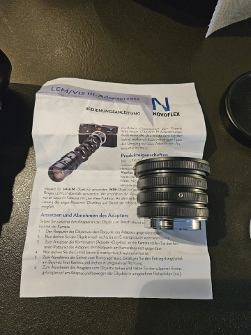

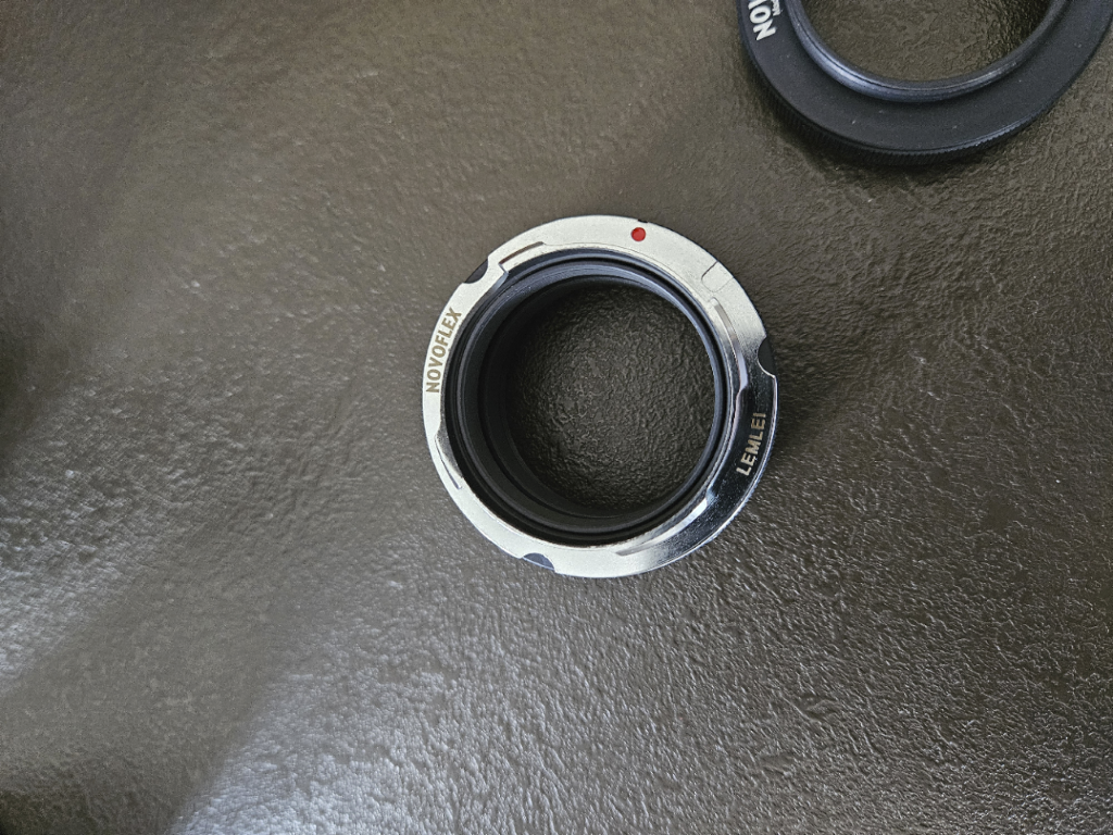

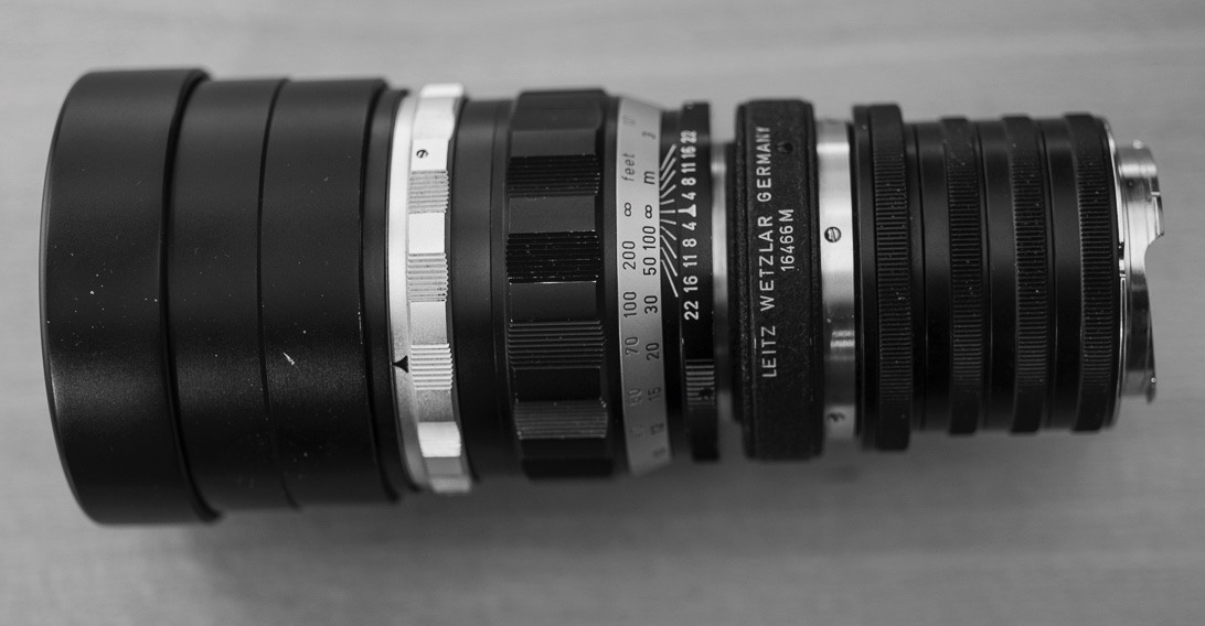

Here you may see the combination of lens (in my case a 200mm Telyt which has the screw mount like your 280mm) - 16466 (OUBIO) - Novoflex LEM-VIS and Novoflex LEM-LEI which attaches the whole thing to the camera:
OK
Perfect
Thank you very much for these photos !
I appreciate.
