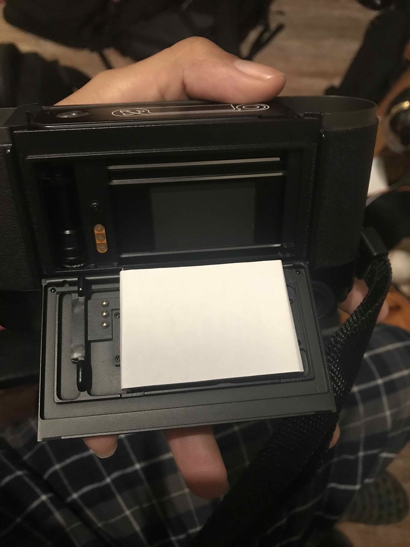

I'm starting a new topic regarding the issues found in my newly purchased Leica MP, the purpose of this is to share any ideas that could lead to a solution,
this is not a rant about Leica lack of QC which we all know is becoming an issue.
After receiving my camera I run a roll of Kodak TriX 400, after developing the film I found a trace of scratches, I did several test with other films which I didn't develop (in case the scratches were being caused by my development process):
Bergger Pancro 400,
Ilford HP5+.
They all show the same type of scratches.
This is an undeveloped roll, https://ibb.co/RbxynrM
https://ibb.co/8xkfs17
I found several threads with people claim the source of this issues was the pressure plate so I checked mine in order the find anything that could be the reason, the screws in the plate don't match the position of the marks in the film and the surface of the plate in my camera feels smooth and flat, I wondered if maybe the reason could be the bridge that has the connection for the light meter but after more inspection it was obvious that the plate keeps the very flat and it does not touch that area.
I did another test in which I rub some film on the surface of the plate, to my surprise the film was very scratched, I did the same against the plate in my 1958 M2 and it didn't do a single one.
I also did a couple of prints to verify the scratches appear and unfortunately the scratches are visible even on a middle size print.
This is the print, the scratches appear in the top and the bottom https://ibb.co/VpKsdfb

almost all the scratches are straight lines that go horizontally from beginning to end (one of the pics I posted shows it clearly), more in the center and a bit above the sprocket holes, I suspected the 2 other places (metal bridge with the contacts for the LM and the part just before the film gets back to the canister) neither touches the film, I verified this by running a roll after removing the plate after the first 5-7 shots were taken (just to ensure the film was well align), I also did a similar experiment removing the back after some shots and going until the end and rewinding the film, in this case the film touches some parts of the 2 places I suspected but the film does not get scratched, only a few marks here and there.
Finally I put some electrical tape covering the plate and loaded some film just about 10 shots, I could see some marks showing the ends of the tape but the scratches didn't show up.
I'm also wondering maybe the plate surface is not the main or only issue, but maybe there just to much pressure from the plate.

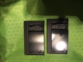

I'm uploading a video to YouTube, is not the best quality and its a bit hard to see but I filmed myself just basically rubbing a piece of film against the plate of both an M4-2 and my MP, I don't apply any pressure and its visible from the light reflection that the film is heavily scratched in person looks much worse like if some very "soft" sandpaper was applied, will post the link to the video here once it finishes uploading.
The best way to test this theory would be of course changing the plate but I don't want to do anything to the camera before I get any news from the dealer, using a back door from maybe a M6 of M7 should also do the trick.
