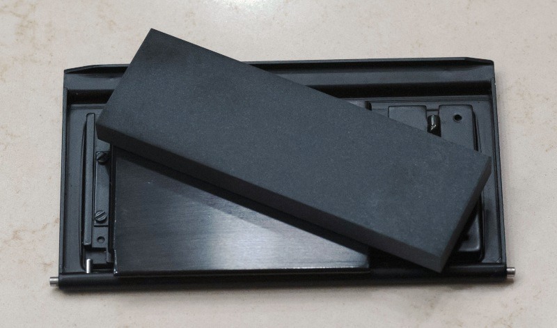

In the 1960s it wasn't unusual to get fine scratches on the back of film from a new camera. We always fixed it ourselves, with a small, extremely fine hard Arkansas honing stone of the type used to hone a mirror finish on surgical knives. A new stone is perfectly flat and feels completely smooth. Film scratches on a new camera were nearly always caused by a slight raised finish on the pressure plate, usually nothing you could see or feel. A gentle wipe or two over the plate with the honing stone would remove any raised bits without appearing to do anything or even remove any black finish from the plate. But after that, and wiping the plate with a clean cloth to remove anything loose, you would no longer have film scratches...
Once the replacement arrives, I’ll probably give it a try, for now I’m afraid I will cause more damage and lose the guarantee
