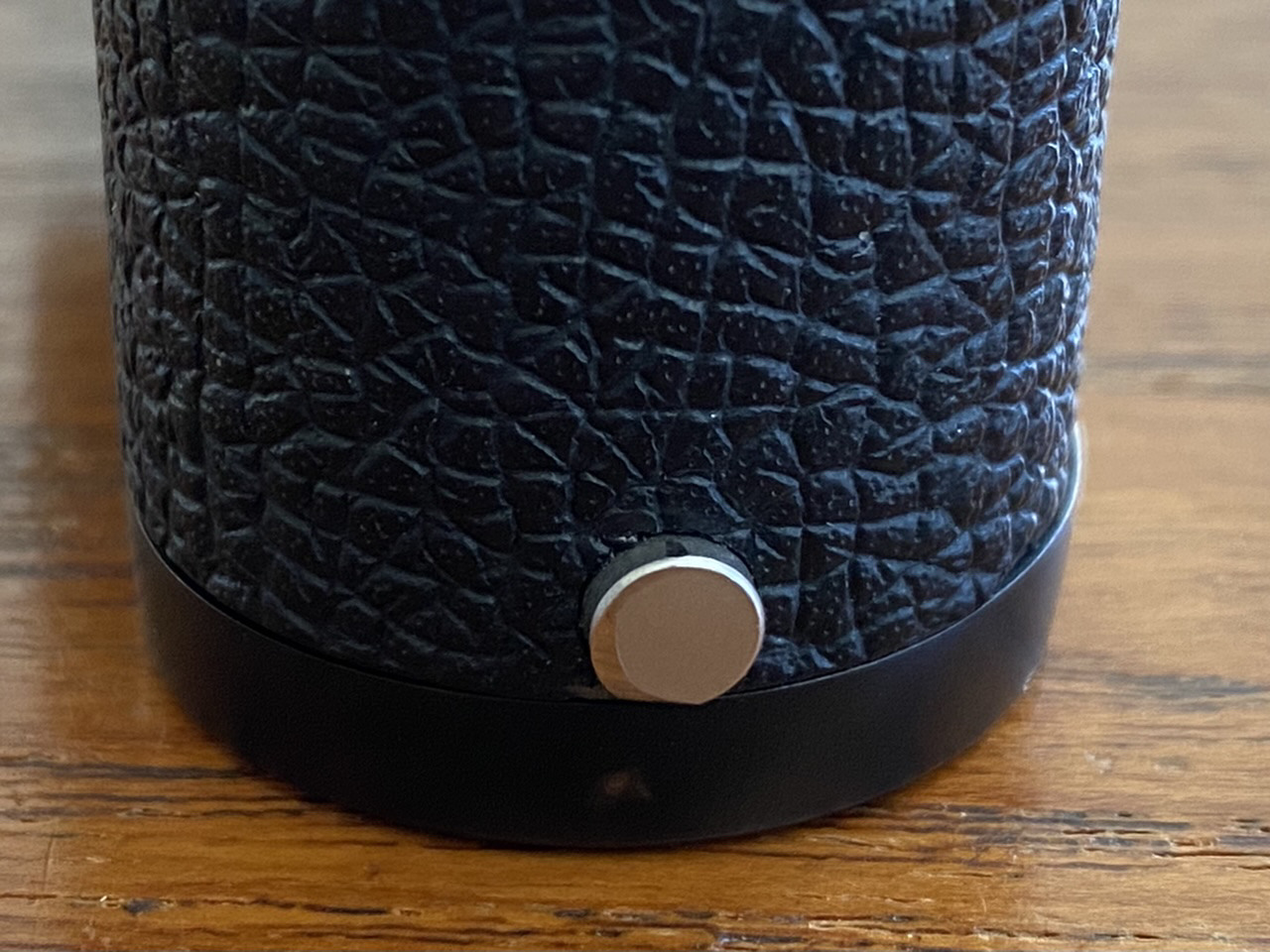

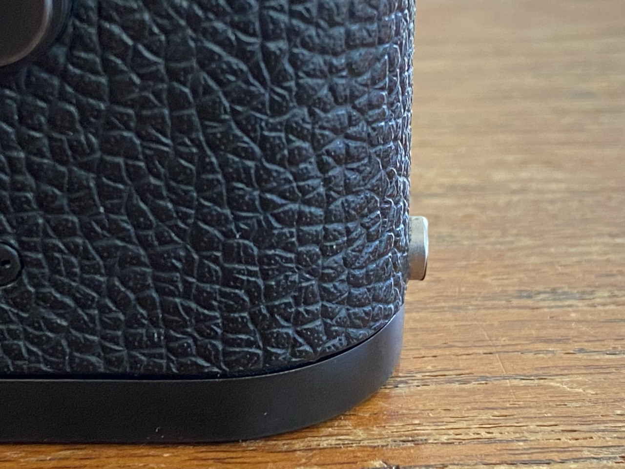

  5. Hello forum members! This is my first post (although I have been lurking around for quite some time). My M4-P (very late serial number 16927xx) has an extra nipple or rivet on the rewind knob side of the body. M3 and M2 bodies, as well as barnack leica's such as the iiif, also seem to have this rivet, but I have never seen it on a M4-P (or M4 for that matter). My questions are: What is the function of this rivet? It does not seem to 'do' or hold anything. What purpose did it serve on the M3/M2? Why does my M4-P have one while it seems to have disappeared from m-bodies since the introduction if the M4?

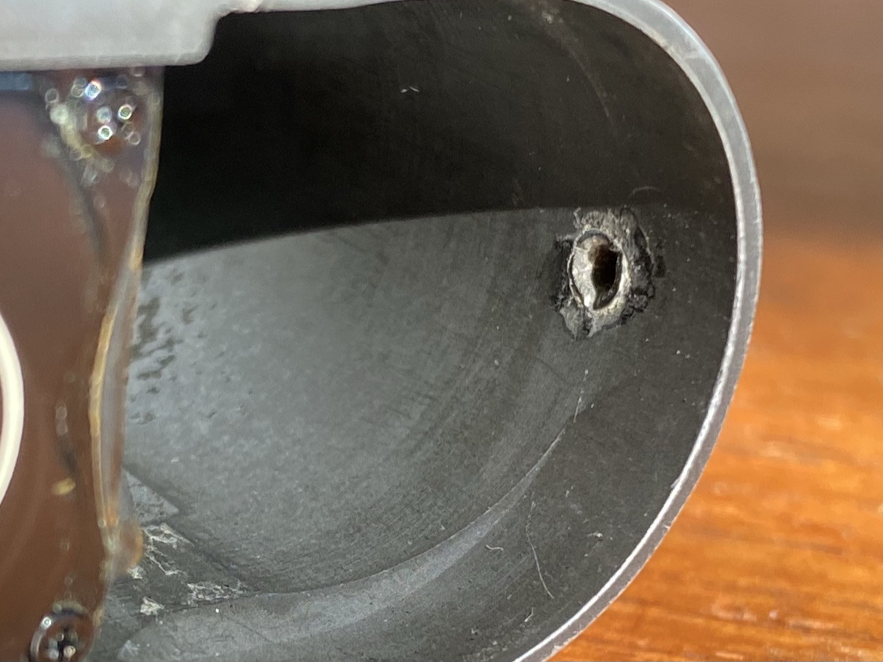

  12. Hello, I just got a mint condition M4-P from a reputable seller. Looks excellent except there is some haze in the viewfinder. It's not noticeable when looking through it but this is when pointing a strong light on it. The seller said it's not hazy enough to justify a cleaning and it's a common issue on this camera (but it was not advertised). Do you think it is cleanable with CLA or is it something more serious like a semi transparent mirror issue ? I keep it if I can service it but if it's unreparable or if it cost half the camera, I don't want to. Thank you for your help and merry Christmas :)

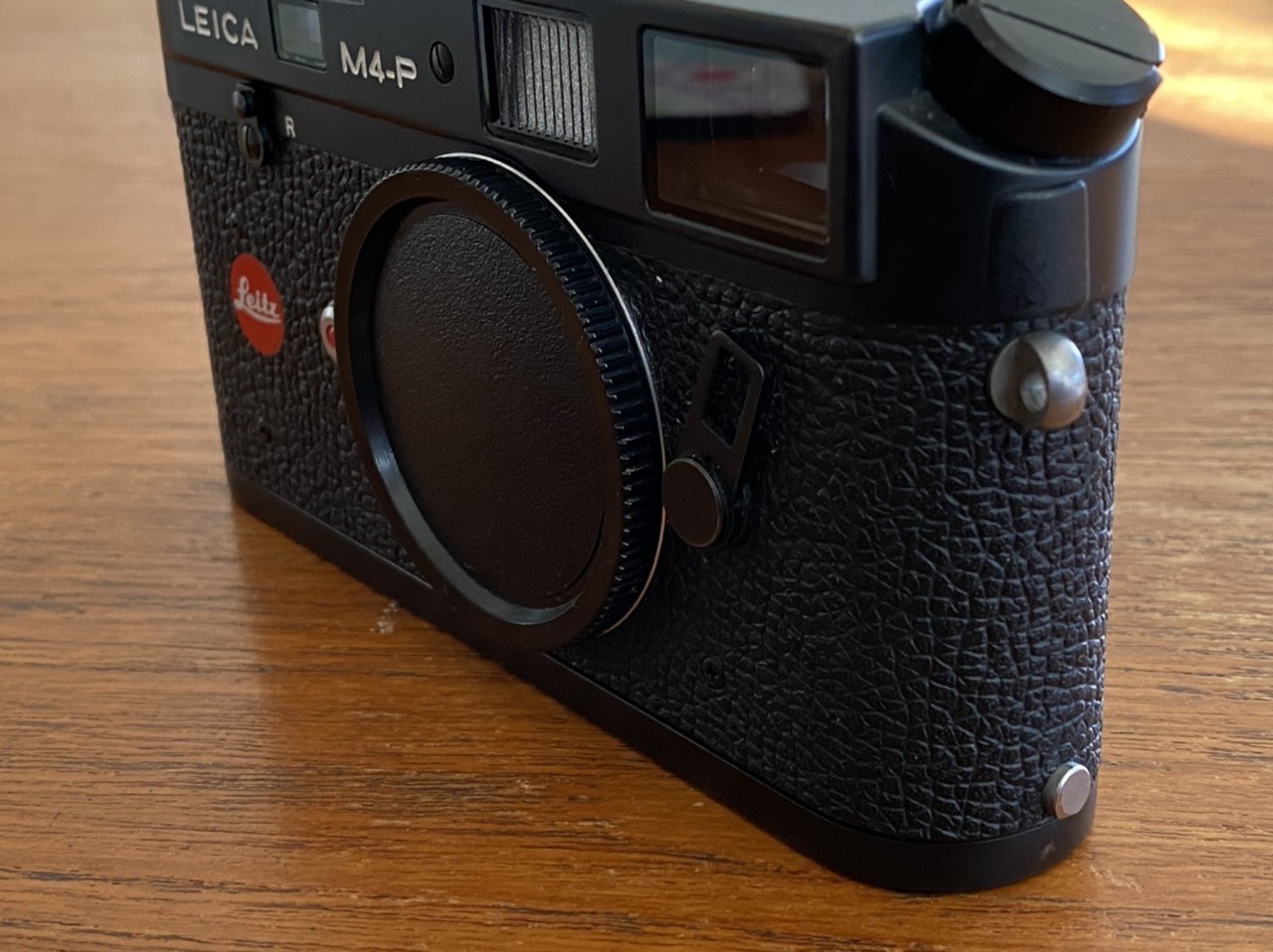

  13. Hey, I recently picked up a mint condition Leica M4-P. Inspected the body and it's pretty close to flawless and no large dings or dents. However the eyepiece seems like it's not centered properly horizontally. It this normal or is this a problem with my camera that needs to be fixed? Hoping someone can help me with this! Thanks
