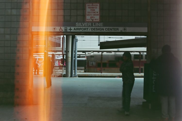

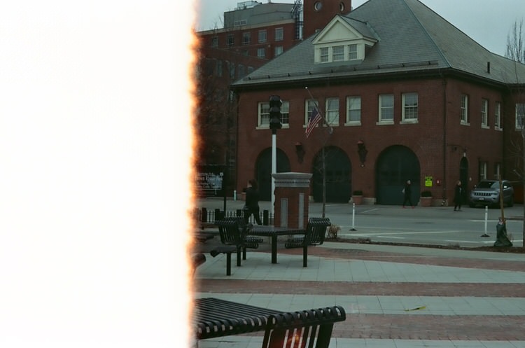

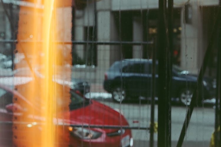

  1. Just reorganized some old film and noticed this issue on this roll. At first I thought it's just flare but it leaks outside of the frame into the next picture. I also noticed that it's reaching above and below the frame and that its towards the end of the roll. Is it possible that this is a light leak through the film cassette? Someone suggested it might have been me changing the lens in daylight with light hitting the shutter curtain. I just can't explain how 1.5 frames are exposed with this leak but before and after nothing else is. the light leak also doesn't reach the sprocket holes, meaning it wasn't me opening the camera. (I know what those light leaks look like ;-) Thanks in advance!
