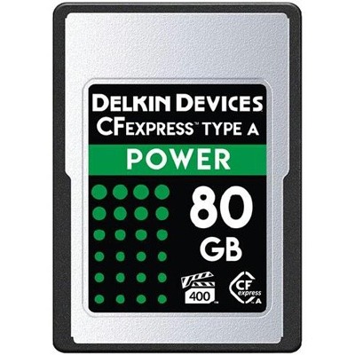

lct Posted March 29, 2023 Share #1224 Posted March 29, 2023 I see that some of you are using Delkin cards here. Could it be that they have the CFExpress format? Link to post Share on other sites More sharing options...

lct Posted March 29, 2023 Share #1227 Posted March 29, 2023 Advertisement (gone after registration) 37 minutes ago, jdlaing said: Won’t do much in an M body. I was referring to Type A CFexpress cards. I have no experience with them. Do you mean they don't fit the M11? Welcome, dear visitor! As registered member you'd see an image here… Simply register for free here – We are always happy to welcome new members! Link to post Share on other sites Simply register for free here – We are always happy to welcome new members! ' data-webShareUrl='https://www.l-camera-forum.com/topic/357248-m11-freeze-issues-merged/?do=findComment&comment=4738873'>More sharing options...

SrMi Posted March 29, 2023 Share #1229 Posted March 29, 2023 1 hour ago, lct said: I was referring to Type A CFexpress cards. I have no experience with them. Do you mean they don't fit the M11? Welcome, dear visitor! As registered member you'd see an image here… Simply register for free here – We are always happy to welcome new members! No, they don't fit. The slots for CFExpress A cards typically allow SD cards but not vice versa. CFExpress Type A: 20 x 28 x 2.8 mm. SD card: 24.0 × 32 x 2.1 mm 1 Link to post Share on other sites More sharing options...

hdmesa Posted March 29, 2023 Share #1231 Posted March 29, 2023 4 hours ago, lct said: I was referring to Type A CFexpress cards. I have no experience with them. Do you mean they don't fit the M11? Welcome, dear visitor! As registered member you'd see an image here… Simply register for free here – We are always happy to welcome new members! I wish. CFExpress in both the smaller A size and larger B size are wicked fast. But they also run very hot and would probably overheat an M11, which is probably why Leica has stayed with standard SD cards for now. 1 Link to post Share on other sites More sharing options...
