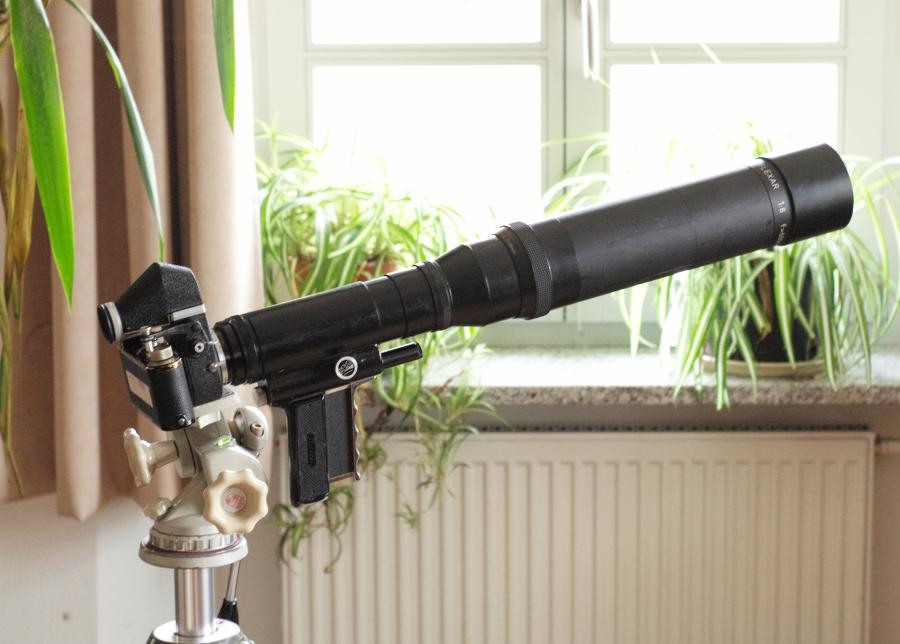

On 14/1/2019 at 12:55, thomas_schertel said:
Leica I con Visoflex II y Noflexar 8/600:
Tuyo sinceramente
Thomas
Beautiful and imposing! ...
Could we see any photo taken with such an instrument?
Thank you..
Am 2.9.2019 um 14:14 schrieb Dopaco:
Thank you..
Here a two photos from today:
These pictures are made with the same lens, Visoflex III and the M240.
Yours sincerely
Thomas
