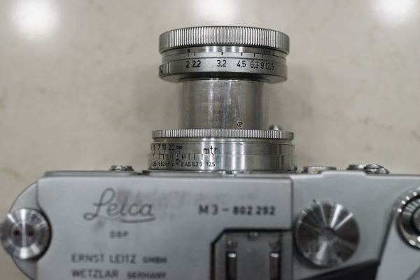

Big Jim Posted September 22, 2023 Share #21 Posted September 22, 2023 (edited) Advertisement (gone after registration) 1 hour ago, TomB_tx said: Here is the normal orientation of a Summitar with adapter on an M3: Welcome, dear visitor! As registered member you'd see an image here… Simply register for free here – We are always happy to welcome new members! Thanks. That’s really odd because on my M2 the middle line is to the right. Could it be due to a later 1952 version of the lens ? Edited September 22, 2023 by Big Jim Add stuff Quote Link to post Share on other sites More sharing options...

TomB_tx Posted September 22, 2023 Share #22 Posted September 22, 2023 Are you using a genuine Leitz (Leica) adapter or an aftermarket brand? Quote Link to post Share on other sites More sharing options...

TomB_tx Posted September 22, 2023 Share #25 Posted September 22, 2023 I've seen a few aftermarket adapters where the ltm thread was not indexed quite right with the M mount so the lens didn't align perfectly. Also on some the flange thickness has bee a bit off (should be 1.00mm). Either can cause the focus to be slightly off. To check the make, leave the adapter locked on the body and then unscrew the lens from the adapter: Welcome, dear visitor! As registered member you'd see an image here… Simply register for free here – We are always happy to welcome new members! Then screw the lens tightly into the adapter and it should come out of the body if you press in the catch button before removing. If the adapter continually stays in the body, getting the adapter out of the body may require fitting the three nubs on the back of a Leica M cap (or Voigtlander cap) into the outer recesses of the adapter flange to turn it out (with the release button pressed). 1 Quote Link to post Share on other sites Simply register for free here – We are always happy to welcome new members! Then screw the lens tightly into the adapter and it should come out of the body if you press in the catch button before removing. If the adapter continually stays in the body, getting the adapter out of the body may require fitting the three nubs on the back of a Leica M cap (or Voigtlander cap) into the outer recesses of the adapter flange to turn it out (with the release button pressed). ' data-webShareUrl='https://www.l-camera-forum.com/topic/219917-explain-screwmount-to-m-adapters/?do=findComment&comment=4862617'>More sharing options...

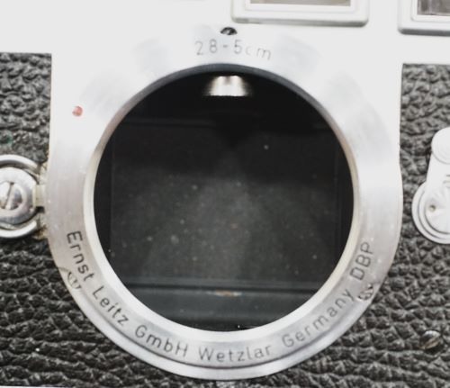

Rick in CO Posted September 23, 2023 Share #29 Posted September 23, 2023 Apparently, some early adapters were custom fitted to a specific lens? Like this one for a 1952 Summicron? Welcome, dear visitor! As registered member you'd see an image here… Simply register for free here – We are always happy to welcome new members! 2 Quote Link to post Share on other sites Simply register for free here – We are always happy to welcome new members! ' data-webShareUrl='https://www.l-camera-forum.com/topic/219917-explain-screwmount-to-m-adapters/?do=findComment&comment=4863103'>More sharing options...

UliWer Posted September 24, 2023 Share #34 Posted September 24, 2023 vor 19 Stunden schrieb Rick in CO: Apparently, some early adapters were custom fitted to a specific lens? Like this one for a 1952 Summicron? Welcome, dear visitor! As registered member you'd see an image here… Simply register for free here – We are always happy to welcome new members! Yes, when the M3 and with it the adapters for LTM-lenses were introduced customers were told that they had to adapt their lenses individually to the adapter and the camera. Though this recommendation was abandoned just a few years later, and I think it was never justified but only a means to make the „original“ new lenses with M-mount more attractive. (May be this reminds anyone to 6-bit-coding…). Quote Link to post Share on other sites More sharing options...
