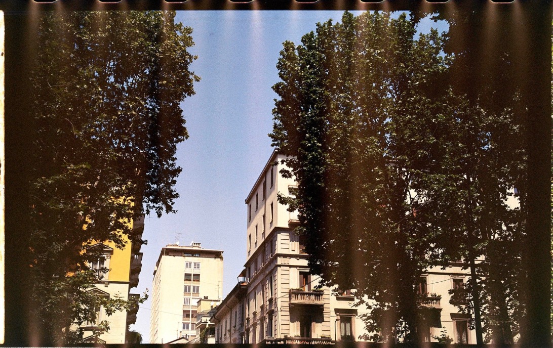

  10. Hello, I got back the photos I took with my M7 and Portra160 film. I am not sure if this a light leak o a developing issue. What do you think this might be? Thank you for your help.

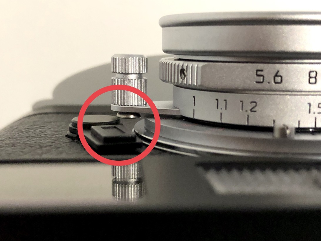

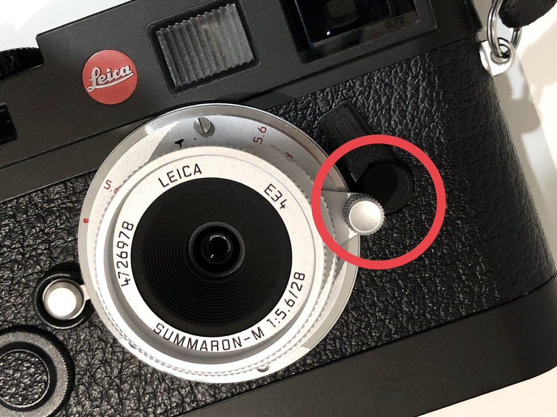

  16. Hello members, I’m curious about the new Summaron-M 28mm 5.6 It’s Focusing tab stuck at the framelines selector and cannot go to close focus. Does this occurs to every M-body that has rectangle framelines selector? 😅 Thanks in advance Thatchapon
