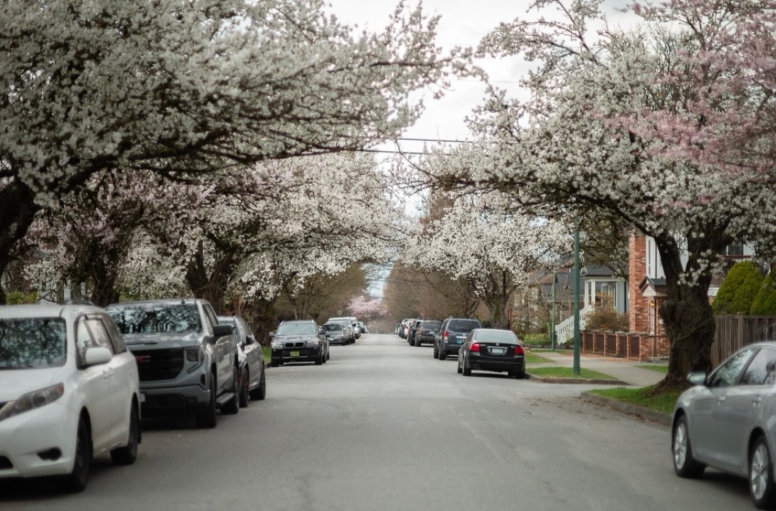

He was able to fix the back focus issue, but now a new issue presents itself. The lux focuses perfectly wide open from MFD to about 25 feet, then from there on to infinity its severely front focus from f1.4-2.8. See picture attached where this picture was taken at 1.4 and infinity distance, but the actual focus point is no where near infinity.  The focus is about where the first black car on the right is or the bmw across from it on the left . The picture quality is low because I had to lower it but that’s where the focus point is when set to infinity and wide open.
Exactly the issue that I have with my 75mm Summarit. Anyone know what might cause a lens to not be properly in focus at infinity, when these things also occur ….

…… and yet when I study the image on the computer ….the subject isn’t properly sharp at infinity, and instead what is in perfect focus is about 30-50 feet away. Just like 69xchange’s image above.
