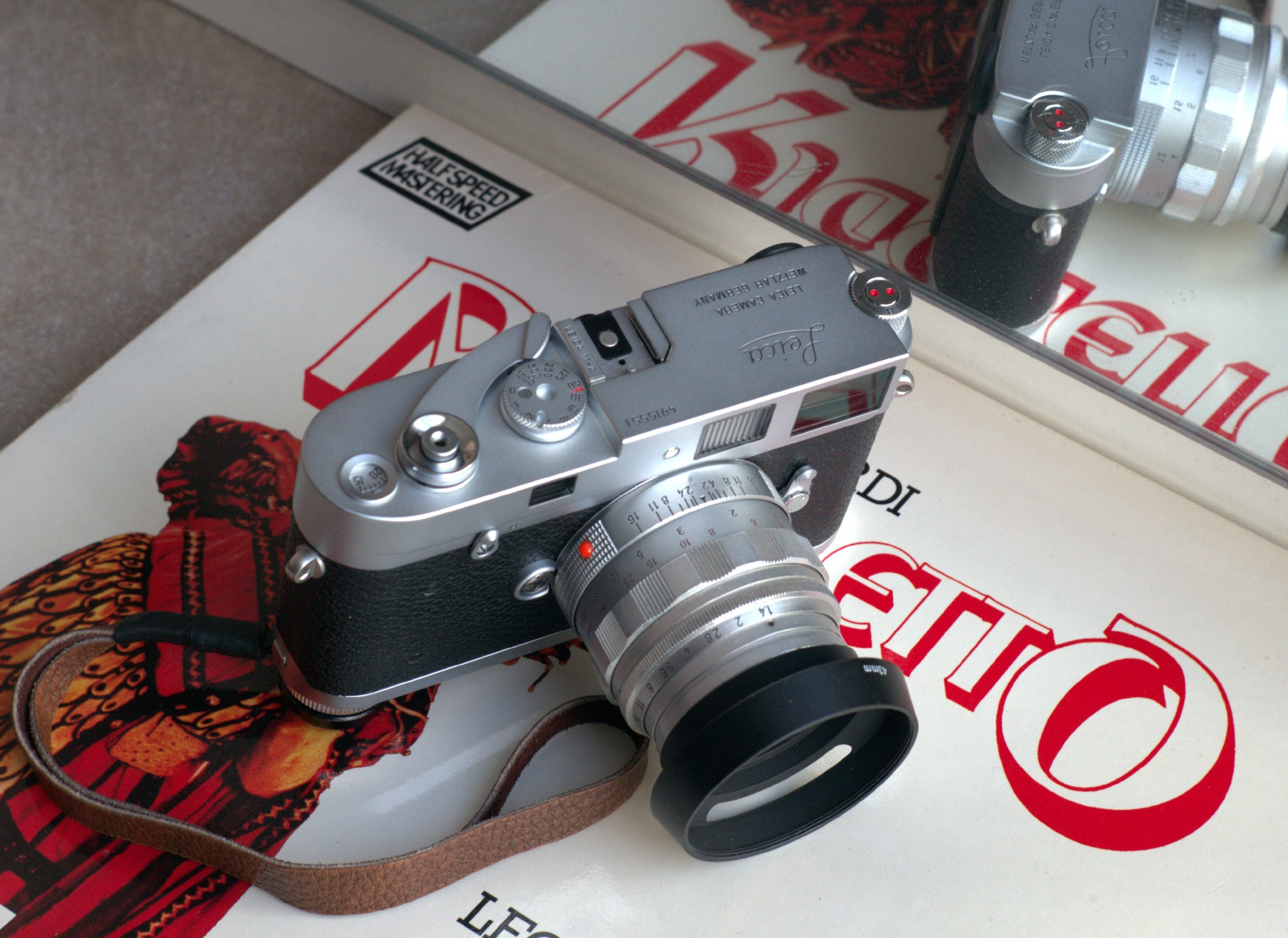

George Stoichev Posted January 10, 2022 Author Share #9 Posted January 10, 2022 2 hours ago, a.noctilux said: On my Summicron 50mm lenses, I don't use UV filter, for me not needing to add on a good lens a piece of glass which only degrades the lens performance (from my experience). To protect the lens, I use vented hood when I need, I have in many sizes as screw-in (E39, E40.5, E46,etc.) like this one, vented hood to see through (link) as here E43 on Summilux 50 Welcome, dear visitor! As registered member you'd see an image here… Simply register for free here – We are always happy to welcome new members! Hi and many thanks. I use the UV filter in order to protect the lens from dust and eventually splashes. is it possible to use this hood with the UV filter? Link to post Share on other sites More sharing options...
lct Posted January 10, 2022 Share #10 Posted January 10, 2022 As i tried to explain above you just have to screw the hood into your filter. 1 Link to post Share on other sites More sharing options...
