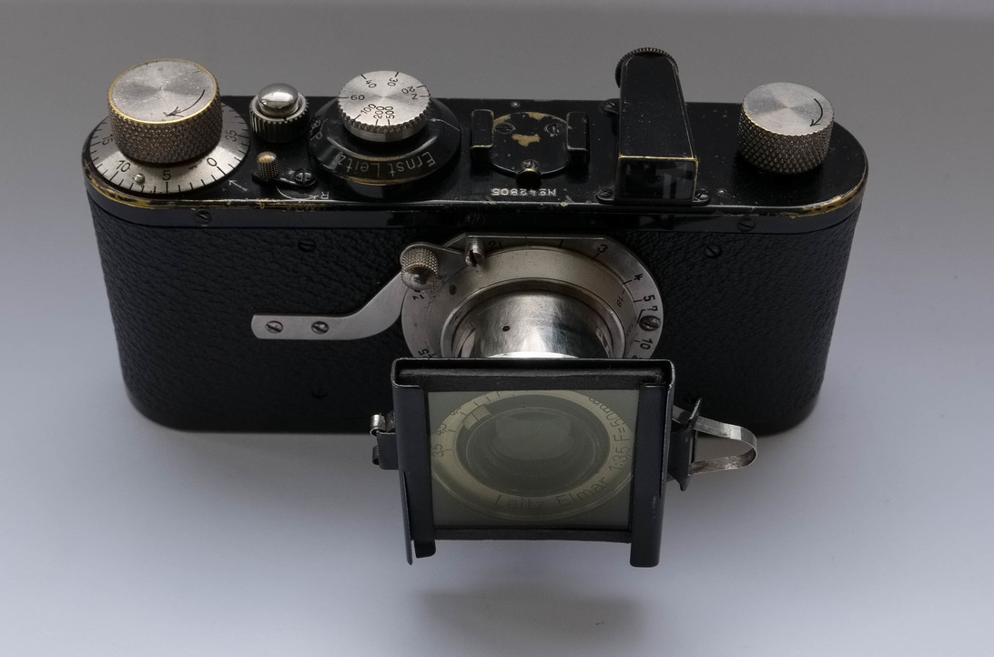

Anbaric Posted March 3, 2020 Share #9 Posted March 3, 2020 If you have the A36 version, another option is the SOOGZ adapter, which has an A36 clamp on one end and a 39mm thread on the other, allowing you to use modern multicoated 39mm filters (like the B+W MRC series). The vintage Leitz A36 filters are, I think, uncoated, so you'll get more flare when shooting into the light than with a multicoated filter. The SOOGZ is getting quite expensive these days, but you only need one. https://www.l-camera-forum.com/leica-wiki.en/index.php/SOOGZ 1 Quote Link to post Share on other sites More sharing options...

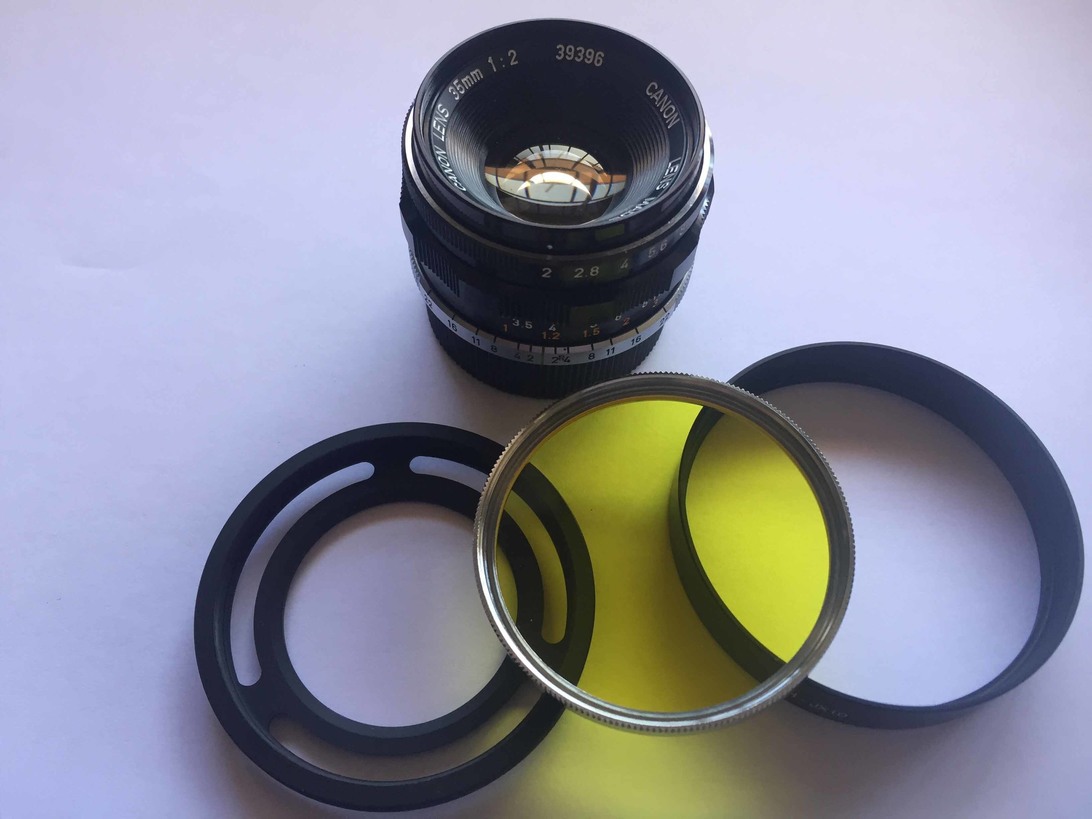

nefarious Posted March 4, 2020 Author Share #11 Posted March 4, 2020 21 hours ago, earleygallery said: If you can't see any filter threads then you probably have the LTM f3.5 lens which takes A36 clamp type filters (readily available via ebay). The f2.8 in LTM or M mount is a 39mm filter thread. Looking more closely, I am wrong - there is a thread after all - apologies! Welcome, dear visitor! As registered member you'd see an image here… Simply register for free here – We are always happy to welcome new members! 1 Quote Link to post Share on other sites Simply register for free here – We are always happy to welcome new members! ' data-webShareUrl='https://www.l-camera-forum.com/topic/307051-39mm-filters-for-collapsible-lens/?do=findComment&comment=3924605'>More sharing options...

nefarious Posted March 4, 2020 Author Share #13 Posted March 4, 2020 22 hours ago, willeica said: My LTM Elmar 5cm f2.8 SN 1549355 from 1958 came with this screw in UVa. I normally never use a filter with any lens, but I have left this on as it looks so nice. I also have the nice screw in chrome hood for this which will screw in the front of the filter or the lens. Welcome, dear visitor! As registered member you'd see an image here… Simply register for free here – We are always happy to welcome new members! William looks gorgeous - they all do! Quote Link to post Share on other sites More sharing options...
250swb Posted March 5, 2020 Share #14 Posted March 5, 2020 20 hours ago, nefarious said: Looking more closely, I am wrong - there is a thread after all - apologies! Welcome, dear visitor! As registered member you'd see an image here… Simply register for free here – We are always happy to welcome new members! Get yourself down to Harrison Cameras and buy a B+W 39mm yellow filter, or Hoya, or whatever, there isn't much in it nowadays between manufacturers. Quote Link to post Share on other sites More sharing options...
nefarious Posted March 5, 2020 Author Share #15 Posted March 5, 2020 3 minutes ago, 250swb said: Get yourself down to Harrison Cameras and buy a B+W 39mm yellow filter, or Hoya, or whatever, there isn't much in it nowadays between manufacturers. agreed, though it has to be a chrome ring - black would not fit the look at all! I did notice last time I was in Harrison's that they had a huge array of used filters; all screwed together in great long cylinders - might be worth trawling through them! I picked up a cable release for my Hasselblad for £2 there not long ago! Quote Link to post Share on other sites More sharing options...

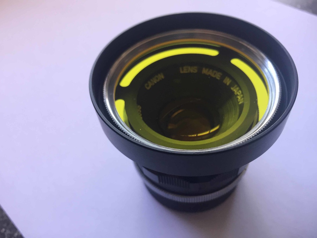

nefarious Posted March 18, 2020 Author Share #17 Posted March 18, 2020 (edited) On 3/4/2020 at 1:51 PM, nefarious said: Looking more closely, I am wrong - there is a thread after all - apologies! Welcome, dear visitor! As registered member you'd see an image here… Simply register for free here – We are always happy to welcome new members! So I've acquired an orange filter and I've been playing! Now, if I may, I'd like some advice re hoods. Looking at the post above, are there any other specific codes I should be searching for on eBay etc?? Edited March 18, 2020 by nefarious Quote Link to post Share on other sites More sharing options...
nefarious Posted March 18, 2020 Author Share #18 Posted March 18, 2020 Just to add; there is only one 12549 on eBay at $100 plus postage and taxes - seems a lot when the filter, which actually includes some glass, was about a quarter of that! Quote Link to post Share on other sites More sharing options...
Pyrogallol Posted March 18, 2020 Share #19 Posted March 18, 2020 There are several Leitz hoods. But if you want something cheap a Chinese 39mm screw vented one will look just as good. https://www.ebay.co.uk/itm/For-Leica-M-Leitz-Zeiss-39mm-39-mm-Metal-Tilted-Vented-Screw-in-Lens-Hood-Shade/361073062446?hash=item5411a1b22e:g: Welcome, dear visitor! As registered member you'd see an image here… Simply register for free here – We are always happy to welcome new members! Quote Link to post Share on other sites Simply register for free here – We are always happy to welcome new members! ' data-webShareUrl='https://www.l-camera-forum.com/topic/307051-39mm-filters-for-collapsible-lens/?do=findComment&comment=3934120'>More sharing options...
