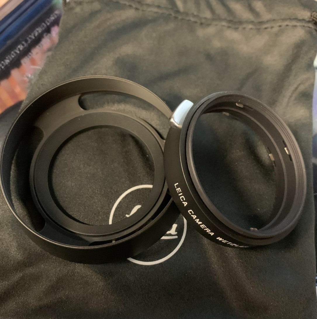

Winedemonium Posted June 3, 2015 Share #1 Posted June 3, 2015 Advertisement (gone after registration) I just got my black chrome 50mm Summilux ASPH (11688). As a number of people who have received their lens have pointed out in this thread http://www.l-camera-forum.com/topic/242441-new-35-cron-and-50-lux-available-in-black-chrome/, the hood won't fit over numerous E43 filters people have tried. I tried with my Carl Zeiss E43 UVa filter, which attaches to the lens just fine, and in this case the hood also won't fit. I thought I would illustrate the problem for two reasons: 1. As a warning, should this affect any purchase decisions. It would seem a normal E43 filter and the supplied hood cannot be used at the same time. But also... 2. to solicit advice from people less mechanically-challenged than me! Perhaps I'm just not doing this right, and there is actually a solution. Please help! Okay, here are the pictures to illustrate this problem - Welcome, dear visitor! As registered member you'd see an image here… Simply register for free here – We are always happy to welcome new members! Note the female groove at the top of the lens barrel. The hood has squeeze tabs to pull these grips flush with the lens. The hood has a male groove that stops the hood being lowered any further than this groove. Releasing the tabs moves the grips back out and they clamp onto the female groove on the lens. Attaching this filter (and I presume many others) does not cause a problem with the overall circumference to clear. This one is perfectly flush with the lens barrel. Here is the hood affixed without the filter. Note the height. Here is the hood affixed with the filter. The extra height created by the filter prevents the grips from reaching the female groove on the lens barrel. It has no grip at all really and would come off at the slightest bump. The issue then is one of height. I'm not sure if any filter will be thin enough to avoid this problem. Thoughts...? What am I missing here? 3 1 Link to post Share on other sites Simply register for free here – We are always happy to welcome new members! Note the female groove at the top of the lens barrel. The hood has squeeze tabs to pull these grips flush with the lens. The hood has a male groove that stops the hood being lowered any further than this groove. Releasing the tabs moves the grips back out and they clamp onto the female groove on the lens. Attaching this filter (and I presume many others) does not cause a problem with the overall circumference to clear. This one is perfectly flush with the lens barrel. Here is the hood affixed without the filter. Note the height. Here is the hood affixed with the filter. The extra height created by the filter prevents the grips from reaching the female groove on the lens barrel. It has no grip at all really and would come off at the slightest bump. The issue then is one of height. I'm not sure if any filter will be thin enough to avoid this problem. Thoughts...? What am I missing here? ' data-webShareUrl='https://www.l-camera-forum.com/topic/245904-hood-fitting-problem-with-50mm-sx-black-chrome-11688/?do=findComment&comment=2827055'>More sharing options...

hiepphotog Posted June 3, 2015 Share #4 Posted June 3, 2015 If there is a tab for a hard stop there, I am afraid it would be an either or situation. I think the tab is there to prevent the lower hood from covering the little dot. Any additional length above the rim of the lens would essentially push the hood away from the mounting groove. 1 Link to post Share on other sites More sharing options...

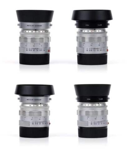

Winedemonium Posted June 3, 2015 Author Share #6 Posted June 3, 2015 I believe this is an inherited problem from the original E43 Lux as far as I could tell from interweb readings. ...I've tracked down #13206 E43 filter (newer version with blocky font) and it's on its way. I'll report back whether the thread pitch and hood clearance work out. Thanks coelacanth. I just got out my 35mm Summicron 8-element to see if and how it is different. I don't have the correct hood for it, but it is a similar operation in E39 thread. I have the 12585 hood, which is really a 50mm lens hood, but it fits the 35 'cron just fine. As you can see in the picture below, the top of the lens barrel is subtly different to the 50mm Summilux. The filter sits fractionally inside the edge of the barrel. This allows the hood to still find its stop point without being blocked by the filter. Welcome, dear visitor! As registered member you'd see an image here… Simply register for free here – We are always happy to welcome new members! This is an old Leitz filter, so I wanted to see just in case it was an unusual exterior gauge. It's not. Here is a brand new B&W yellow filter - same diameter. So it seems this may be, as you suggest coelacanth, the reincarnation of a problem created in 1959, and not fixed in 2015! Link to post Share on other sites Simply register for free here – We are always happy to welcome new members! This is an old Leitz filter, so I wanted to see just in case it was an unusual exterior gauge. It's not. Here is a brand new B&W yellow filter - same diameter. So it seems this may be, as you suggest coelacanth, the reincarnation of a problem created in 1959, and not fixed in 2015! ' data-webShareUrl='https://www.l-camera-forum.com/topic/245904-hood-fitting-problem-with-50mm-sx-black-chrome-11688/?do=findComment&comment=2827126'>More sharing options...

dwild Posted June 3, 2015 Share #8 Posted June 3, 2015 My "slim" 43mm filter has an outside diameter of 43.7mm so it sits in from the edge just like you've illustrated in your previous post, Windemonium. That's how the hood still can lock in position. How'd Leica do it with the 35 Summicron and its reversible hood? (I don't own one of those) Will Leica make another slim 43 UV with the correct thread pitch? I always liked the smooth front and never need to stack filters. Thanks again for all the help David 1 Link to post Share on other sites More sharing options...
Dartman Posted June 3, 2015 Share #9 Posted June 3, 2015 Thank you for making this dedicated thread to the problem, one that is perplexing me and my new aquisition! As you can see in your 3rd and 4th pictures, there are grooves within the outside edge of the hood. If I insert a B+W N43 filter, it drops onto these threads, but spins without biting. I am wondering if there is a particular filter that could be attached succesfully on this end of the hood? 1 Link to post Share on other sites More sharing options...
Winedemonium Posted June 3, 2015 Author Share #10 Posted June 3, 2015 Hello Winedemonium, The 12585 is the correct hood for the 35mm Summicron, Version I. Please note: When the above mentioned hood is used in conjunction with The 35mm Summicron, version I & various Leitz filters of the same time period there are no problems of compatability. Best Regards, Michael (emphasis added is mine). That's why I also tested my 35mm Summicron 8-element with a brand new B&W 39mm filter, purchased in 2015. It also works. Actually I have just tested it with a whole range of 39mm filters, old and new, and no problem with any of them when using the 12585. I no longer have the 12504, but I'm confident it would also work as it fits the same as the 12585. So this problem that exists in the 50mm black chrome SX doesn't exist in the 35mm Summicron 8-element, despite the same design principles. 1 Link to post Share on other sites More sharing options...
dwild Posted June 3, 2015 Share #11 Posted June 3, 2015 Thanks Windemonium -- I see now -- the front of the outside housing of the Summicron is slightly larger than the standard filter and that's why it works with the reverisble hood. If only this new 50 Summilux was designed the same way, right? 1 Link to post Share on other sites More sharing options...
