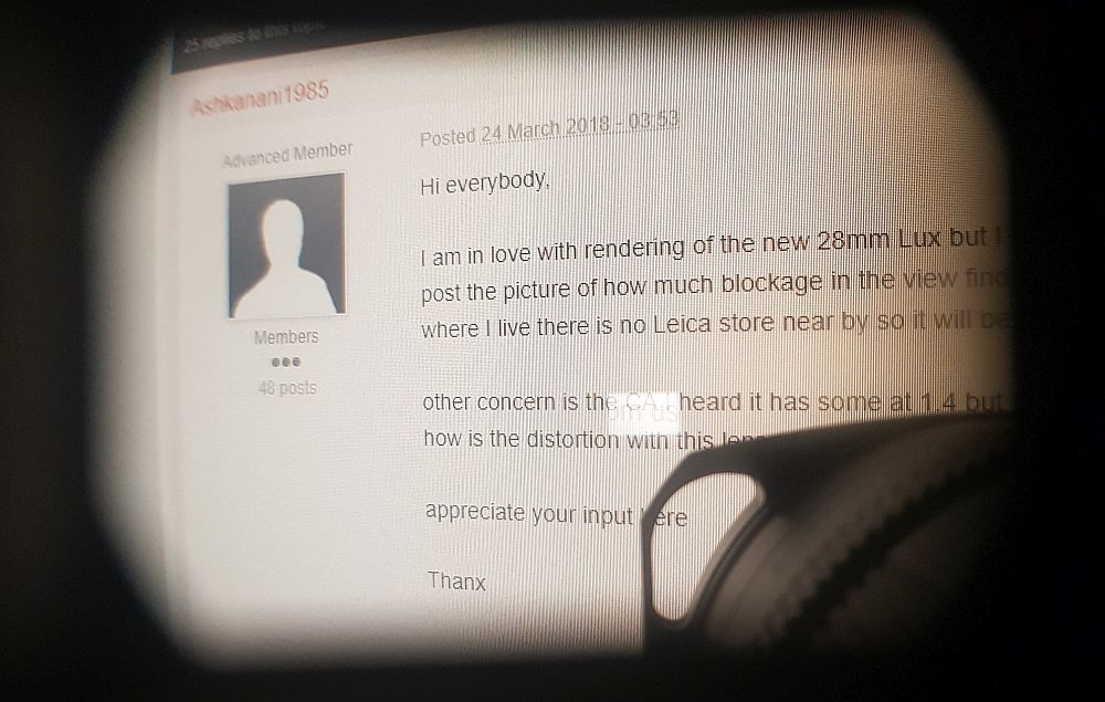

I am in love with rendering of the new 28mm Lux but I have one concern is the view finder blockage, I was wondering if any has it with M10 and can post the picture of how much blockage in the view finder with this lenses will really appreciate it. I know I can go and try it myself but unfortunately where I live there is no Leica store near by so it will be online order for the lens.

If u have the Lux with the M10 can post a picture of the viewfinder blockage with this lens? or your opinion on how much blockage you are getting and does it bother you ? how is the wight going on with you ?
The 28 Summilux blocks quite a bit of the VF, similar to other big lenses.  Sorry I don't have a picture.

JMHO but I think that viewfinder blockage is an overblown concern.
When I am shooting with one of my lenses that causes viewfinder blockage, I move the camera around a bit to see where things I want in the image are in relation to the blockage.  Then I recompose and make my image.  Almost all of the time I get it right and do not cut off feet, hands, etc., causing me to need to make the image again.
A little practice with this technique goes a long way - give it a try...

I have shot M's for many years and I guess that finder blockage is something I do not even think about. Its there at times depending on the lens but does not distract me. I guess my brain just ignores it sort of like a nagging wife.....!! :D

I have both, I'll update my post with an image once I get to it tomorrow. Honestly its not so bad, Im having much more difficulties nailing the focus when my subject isn't in the middle of my frame. But that has got to do with the framing a wide angle lens. Love the character and the smoothness, I wouldn't get the Cron, instead I have the Lux and Elmarit. Speed vs Size.
