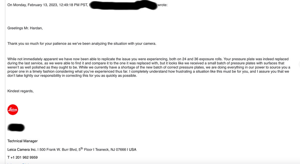

Huss Posted February 27, 2023 Share #62  Posted February 27, 2023 4 hours ago, jonoslack said: ... This is me, not Leica, and it makes me wonder . . . . . . But when I posted this I wasn't aware of the furore! @Huss did you get a good response from Leica? I can't take back these images, but I really hope that everyone who has read the thread sees this! Did I get a good response from Leica? well, they did tell me that the M6s scratching film is due to a bad batch of pressure plates.  So this means it is not a one off, but there are a whole bunch of scratching new M6s out there. We also know that Leica builds its cameras in batches, so it would seem that it is extremely likely that any camera that was built in the same batch as mine is also a scratcher. I bought mine in November.   Now to make matters worse, Leica replaced the pressure plate in my camera with a new one.  That new one also scratched the film - which the techs at Leica in NJ acknowledged.  So Leica is replacing defective pressure plates with new defective pressure plates.  Just when you didn’t think it could get worse, they didn’t even check the camera to see if it no longer scratched film.  Just shipped it back to me where I discovered that.  Shipped back - they acknowledged that. Is that the end of the story?  No.  They replaced the pressure plate with a third one - this time shipped from Germany - and were about to ship it to me last Wednesday.  I contacted them immediately on Wednesday and asked if they had checked to see if it now no longer scratches the film.  They had not. So they pulled it out of the UPS pickup and are going to check it again. Is that it? No.  My ISO dial is also defective - again Leica NJ verified that - and when I asked on Wednesday if they fixed it, they said they forgot to look at that. This is Leica HQ in the United States.  No, I did not get a good response.  And I find it extremely hard to believe when I see your camera’s results, that had scratches just like mine, that was most probably made at the same time as mine, using the same batch of defective pressure plates, that your camera is ‘good’. Maybe it is, maybe be some remarkable stroke of luck even though your camera was built at the same time as mine, somehow the one untainted pressure plate from the entire defective batch made it through to your camera. Or maybe you need to check the actual negatives from your last pics, instead of viewing scans.  Because that ICE software covers up scratches. 2 Link to post Share on other sites More sharing options...
MarkP Posted February 27, 2023 Share #63  Posted February 27, 2023 2 hours ago, Huss said: ... they didn’t even check the camera to see if it no longer scratched film.  Just shipped it back to me where I discovered that.  Shipped back - they acknowledged that... ...They replaced the pressure plate with a third one - this time shipped from Germany - and were about to ship it to me last Wednesday.  I contacted them immediately on Wednesday and asked if they had checked to see if it now no longer scratches the film.  They had not... ...My ISO dial is also defective - again Leica NJ verified that - and when I asked on Wednesday if they fixed it, they said they forgot to look at that... Unbelievable 🙄. I would be extremely pissed off... Link to post Share on other sites More sharing options...
jonoslack Posted February 27, 2023 Share #64  Posted February 27, 2023 2 hours ago, Huss said: Did I get a good response from Leica? well, they did tell me that the M6s scratching film is due to a bad batch of pressure plates.  So this means it is not a one off, but there are a whole bunch of scratching new M6s out there. We also know that Leica builds its cameras in batches, so it would seem that it is extremely likely that any camera that was built in the same batch as mine is also a scratcher. I bought mine in November.   Now to make matters worse, Leica replaced the pressure plate in my camera with a new one.  That new one also scratched the film - which the techs at Leica in NJ acknowledged.  So Leica is replacing defective pressure plates with new defective pressure plates.  Just when you didn’t think it could get worse, they didn’t even check the camera to see if it no longer scratched film.  Just shipped it back to me where I discovered that.  Shipped back - they acknowledged that. Is that the end of the story?  No.  They replaced the pressure plate with a third one - this time shipped from Germany - and were about to ship it to me last Wednesday.  I contacted them immediately on Wednesday and asked if they had checked to see if it now no longer scratches the film.  They had not. So they pulled it out of the UPS pickup and are going to check it again. Is that it? No.  My ISO dial is also defective - again Leica NJ verified that - and when I asked on Wednesday if they fixed it, they said they forgot to look at that. This is Leica HQ in the United States.  No, I did not get a good response.  And I find it extremely hard to believe when I see your camera’s results, that had scratches just like mine, that was most probably made at the same time as mine, using the same batch of defective pressure plates, that your camera is ‘good’. Maybe it is, maybe be some remarkable stroke of luck even though your camera was built at the same time as mine, somehow the one untainted pressure plate from the entire defective batch made it through to your camera. Or maybe you need to check the actual negatives from your last pics, instead of viewing scans.  Because that ICE software covers up scratches. Hi there i didn’t think that ICE worked with HP5? But you make a sensible point and it seems obvious that I have the same problem as you do. Tomorrow I will re-scan the first batch of negatives from the processing on my Plustek. I was going to do this at some point anyway as I’m interested in doing an article on different scanning techniques.  I’ll report back here later.  …….. and I’m really sorry for the obvious problems you’ve been having.  More Later all the best Link to post Share on other sites More sharing options...

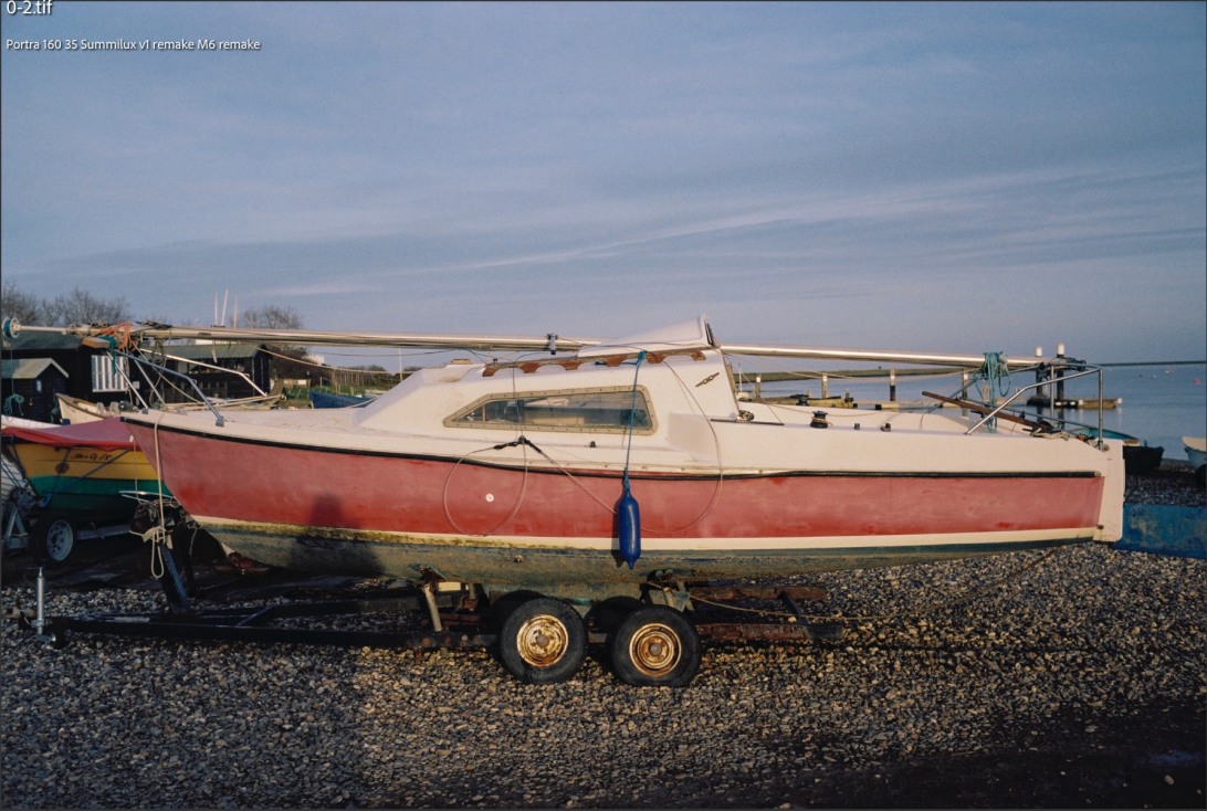

28framelines Posted February 27, 2023 Share #65  Posted February 27, 2023 9 hours ago, jonoslack said: Okay - so the best thing I can do here is to post some scans direct from Exposure Lab taken with the same camera. Welcome, dear visitor! As registered member you'd see an image here… Simply register for free here – We are always happy to welcome new members!      Jono please tell me what lens you used for that first colour photo… the image is dreamlike and the colours render so beautifully! Link to post Share on other sites More sharing options...

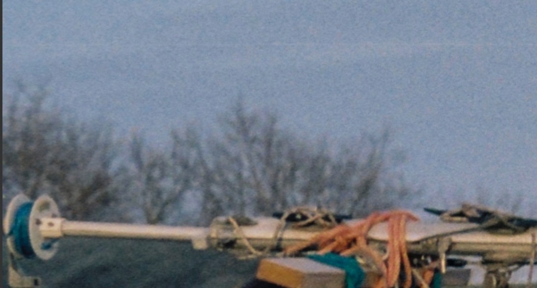

jonoslack Posted February 27, 2023 Share #74  Posted February 27, 2023 Hi There especially @Huss (was yours worse than that) Well, some thorough investigation of lab processed and scanned files shows that there is indeed some scratching about 1/4 up the frame, but seemingly only near the edges: Welcome, dear visitor! As registered member you'd see an image here… Simply register for free here – We are always happy to welcome new members!  I have to say I don't feel to guilty for having missed it, but what I'm going to do later is to rescan this negative on the Plustek and see if it's noticeably worse. I've looked at a whole roll, and it's pretty much the same - I still find it's interesting that it doesn't seem to happen in the middle of the frame. It's not visible in any of the colour images (presumably because they are using ICE in the scanning). All the best Jono (eating his words together with some humble pie) Slack 6 Link to post Share on other sites Simply register for free here – We are always happy to welcome new members!  I have to say I don't feel to guilty for having missed it, but what I'm going to do later is to rescan this negative on the Plustek and see if it's noticeably worse. I've looked at a whole roll, and it's pretty much the same - I still find it's interesting that it doesn't seem to happen in the middle of the frame. It's not visible in any of the colour images (presumably because they are using ICE in the scanning). All the best Jono (eating his words together with some humble pie) Slack ' data-webShareUrl='https://www.l-camera-forum.com/topic/368456-new-m6-article-by-jono/?do=findComment&comment=4702590'>More sharing options...
