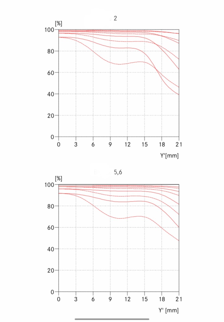

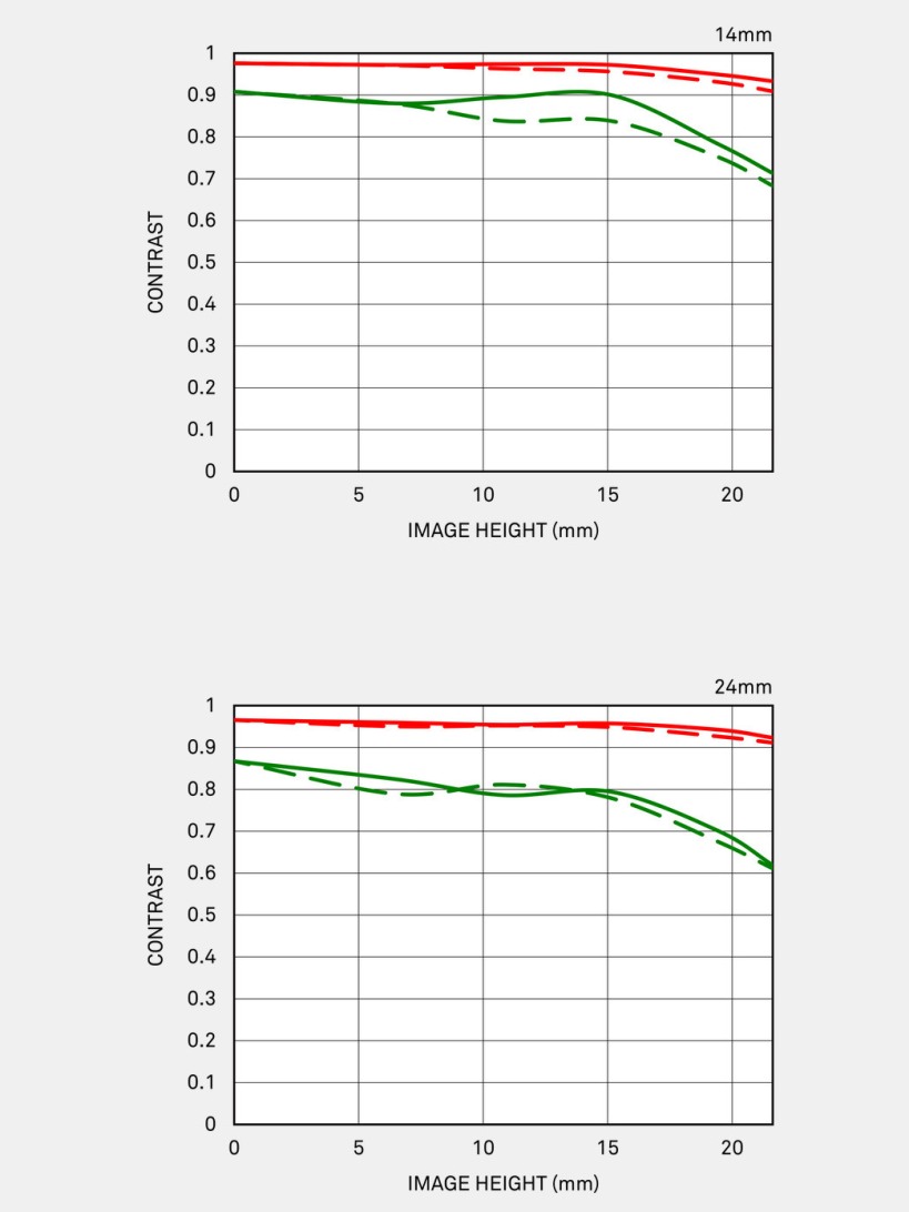

If we are just going by MTF, the Sigma 14-24mm zoom looks to be similar, to be honest...the Sigma MTF's are for diffraction MTF wide open and the bottom line is 30lpm. Leica's bottom line is 40mm, but next line is 20lpm. So Sigma fits kind of in between.
If it were me, I would pass on both the adapted Leica lenses and get a native L mount lens, either the 14-24, or more likely, the Sigma 20mm f1.4 Art. In my experience, the better Sigmas lenses are optically superior to M lenses on an L mount body. The 19mm 2.8 was a great lens in the R system, but optically at least, time has moved on, and all the l mount native lenses seem to be optically better. If you just want a Leica lens no matter what, then the 16-35mm and upcoming 21mm will serve you better.
Edited by Stuart Richardson
You can’t directly compare the Sigma and Leica MTFs. The Sigma MTFs are for 10 and 30 lpmm, whereas Leica is 5, 10, 20, 40 lpmm. Some mental interpolation is needed.
With that said, the Sigma 14-24 DG DN is sharper wide open than the 16-35 SL but there are trade offs in more flaring/ghosting on the Sigma.
I’d be very curious to see what the 21 APO SL look like. If it’s anything close to the 28 APO SL and you only care about 21mm, I’d totally wait for the 21 APO.

Yes, that is why I said as much in my post. I still think it is fairly clear that there is not a world of difference between them, at least on the published MTF. Given a similar price, the Leica would surely be the one to get, but seeing as it is still not even announced yet and is on track to cost fives times as much, the Sigma lenses are worth a look in the meantime. In Europe at least the Sigma lens on its own is likely to cost less than just the tax on the Leica lens.
As for the 19mm. I had this lens on Leica R. It is quite good. Vintage lenses can hold up well, but the ones that tend to hold up best are the standard lenses and telephotos. Wide angle lenses like this tend to be the most difficult to design, and it is an area where computer aided lens design and more sophisticated aspherical element design has come along to really push forward the quality of the design. At least from my perspective, you are not going to be getting a lot of "look" out of a 19mm lens. Since it is so wide, bokeh is not really a factor. Your main optical characteristics are going to be distortion, flare control, sharpness and lack of color fringing. All of those are likely to be better in a newer lens. I would say if you are looking for character, spend that money on a longer lens...a 35mm 1.4 Summilux R, 80mm Summilux etc. The 19mm is just a wide angle...not a particularly remarkable one by modern standards.
If the 21mm SL Summicron is out, get that. I think that it will be stellar, and better than any of the other lenses mentioned. If it is not available, then get the SL 16-35mm or Sigma 14-24mm. The SL is narrower, but takes screw on filters. The Sigma requires a giant adapter etc... The R19mm has a beautiful look, and is special in its own way, but the corners are barely there at F8. The 21mm M would be my last choice, because it is weight, and for speed I would shoot a 24mm or 35mm F1.4
