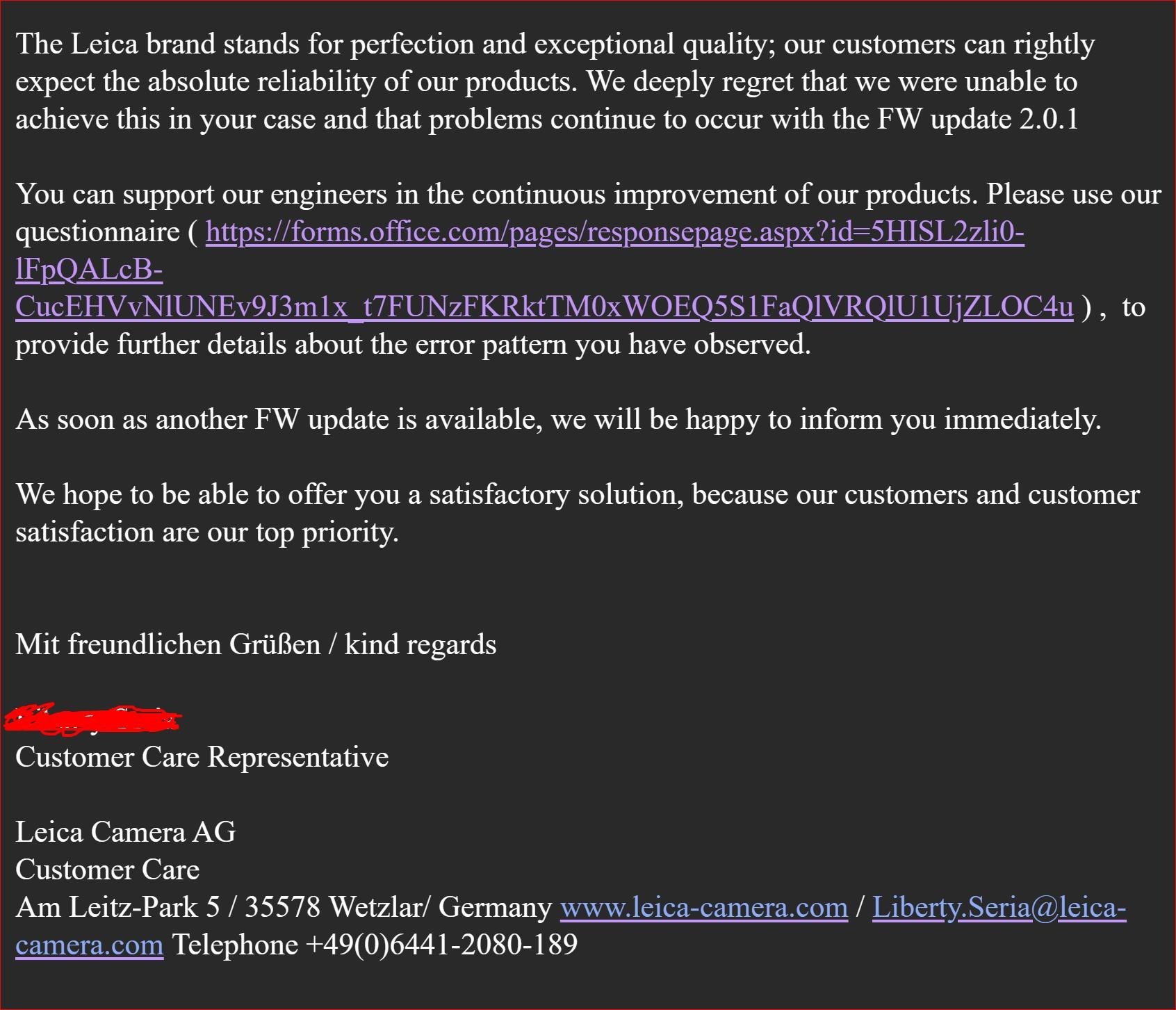

Some of the people there suggested reporting the glitch via the Leica Fotos app which I've done. Not sure if that was the best idea. I've also sent an email to Leica France, so lets see what they say. I'm a mere fish in a small pond!
