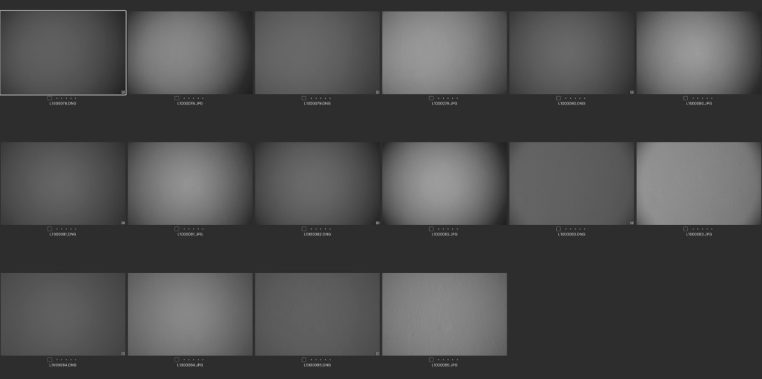

hdmesa Posted May 8, 2022 Share #1 Posted May 8, 2022 Advertisement (gone after registration) I'm not liking the M11 in-camera b&w JPEGs. Even in bright daylight, when I use a lens wide open that has heavy vignetting (28 Lux at f/1.4), the vignette gradient on the monochrome JPEGs is abruptly truncated with a hard division between the vignette and the rest of the image (and at high ISOs in dim light, this translates to heavily-banded corners on the JPEGs). DNG converted to b&w with high contrast applied (top) versus the in-camera high-contrast b&w film style (bottom). I've never seen a real film that did this to the vignetting, and I don't remember the in-camera JPEGs looking like this on the M10-R or M10M. I'm not sure if the M11 issue is too much JPEG compression or just a badly designed tone curve. Welcome, dear visitor! As registered member you'd see an image here… Simply register for free here – We are always happy to welcome new members! Link to post Share on other sites Simply register for free here – We are always happy to welcome new members! ' data-webShareUrl='https://www.l-camera-forum.com/topic/332280-in-camera-m11-monochrome-jpegs/?do=findComment&comment=4431739'>More sharing options...

adan Posted May 13, 2022 Share #7 Posted May 13, 2022 Advertisement (gone after registration) Worrying about image quality in out-of-camera jpegs is like worrying about how well a pig can sing. One is working with 8-bit data (256 gray levels) instead of the 14-bit data (16384 gray levels) in a .DNG, so naturally there can be more-abrupt tone gradients/cutoffs. It is built into the jpeg specifications - and baked into the images forever, the instant the camera creates them. It may also be an artifact of the sRGB color space and gamma curve that is the only option for jpeg output with the M11. sRGB was engineered in 1996, before any significant digital photography was being done, to make images look pretty on the cathode-ray monitors of the day. It is known to be a bit "squirrelly" in the shadows. Adobe RGB 1998 improved on sRGB (and is a jpeg-output option on most cameras), but I can't quantify that - the last time I actually shot a jpeg was early 2006 (end of my Digilux-2 era). 1 2 Link to post Share on other sites More sharing options...

lct Posted May 13, 2022 Share #11 Posted May 13, 2022 Just checked with a high vignetting lens (S-A 21/3.4) and there is a bug in the M11's jpeg engine apparently (raw above, jpg below). Welcome, dear visitor! As registered member you'd see an image here… Simply register for free here – We are always happy to welcome new members! 1 Link to post Share on other sites Simply register for free here – We are always happy to welcome new members! ' data-webShareUrl='https://www.l-camera-forum.com/topic/332280-in-camera-m11-monochrome-jpegs/?do=findComment&comment=4434422'>More sharing options...
hdmesa Posted May 13, 2022 Author Share #12 Posted May 13, 2022 (edited) 15 minutes ago, lct said: Just checked with a high vignetting lens (S-A 21/3.4) and there is a bug in the M11's jpeg engine apparently (raw above, jpg below). Welcome, dear visitor! As registered member you'd see an image here… Simply register for free here – We are always happy to welcome new members! YES! And also if you're shooting in dim light at high ISO, those transitions will be banded like crazy. DNG exported to JPEG from C1: SOOC JPEG – looks like a fake shot of looking through binoculars! Edited May 13, 2022 by hdmesa Link to post Share on other sites More sharing options...
hdmesa Posted May 13, 2022 Author Share #13 Posted May 13, 2022 (edited) Another example. DNG left / JPEG right. The DNG was heavily processed with high contrast C1 profile, added contrast, reduction of blue & cyan sliders and still has a nice gradient in the sky. It looks like Leica used an errant tone curve in one or more color channels during the b&w conversion. Welcome, dear visitor! As registered member you'd see an image here… Simply register for free here – We are always happy to welcome new members! Edited May 13, 2022 by hdmesa Link to post Share on other sites Simply register for free here – We are always happy to welcome new members! ' data-webShareUrl='https://www.l-camera-forum.com/topic/332280-in-camera-m11-monochrome-jpegs/?do=findComment&comment=4434435'>More sharing options...

hdmesa Posted May 14, 2022 Author Share #15 Posted May 14, 2022 (edited) I take it back – the M11 color JPEGs have the same issue. SOOC JPEG top, DNG bottom: Welcome, dear visitor! As registered member you'd see an image here… Simply register for free here – We are always happy to welcome new members! Edited May 14, 2022 by hdmesa Link to post Share on other sites Simply register for free here – We are always happy to welcome new members! ' data-webShareUrl='https://www.l-camera-forum.com/topic/332280-in-camera-m11-monochrome-jpegs/?do=findComment&comment=4434560'>More sharing options...

frame-it Posted May 14, 2022 Share #17 Posted May 14, 2022 (edited) 9 hours ago, hdmesa said: I take it back – the M11 color JPEGs have the same issue. SOOC JPEG top, DNG bottom: Welcome, dear visitor! As registered member you'd see an image here… Simply register for free here – We are always happy to welcome new members! interesting... what are your in-camera jpg settings for contrast etc etc OR the lens corrections are not being applied in-camera to the jpegs Edited May 14, 2022 by frame-it Link to post Share on other sites More sharing options...

hdmesa Posted May 14, 2022 Author Share #19 Posted May 14, 2022 3 hours ago, frame-it said: interesting... what are your in-camera jpg settings for contrast etc etc OR the lens corrections are not being applied in-camera to the jpegs No alterations to the in-camera film styles. Regarding lens corrections: Leica's vignetting corrections are pretty mild for most of their lenses, even those with heavy vignetting. Link to post Share on other sites More sharing options...
