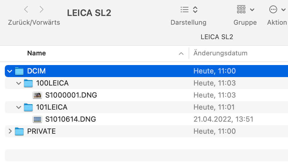

4 hours ago, urmel said:
...the numbering was messed up as I updated my Q2 Firmware. The numbering was reset for the pictures and the new pictures have placed into 100LEICA directory.
These new taken pictures are stored there. The App Leica, running on Adroid or I-Pad, is not able to find these messed up pictures to be transferred.

vor 3 Stunden schrieb hdmesa:
If it resets the numbering to a folder past what you had been using, you probably would have to reset the camera and try again: 1) save your profile to SD if you don't have it saved already 2) completely reset the camera 3) reimport settings 4) reset image numbering until it writes to 101LEICA. Once it's putting an image in 101LEICA called S1010001, you can put that SD card in your computer, delete that image, empty trash, then copy over your S1010614 image to the 101LEICA folder, put the SD card back in the camera and take a photo and see if it picks up at the next number.
Hallelujah, that worked. I don't know where you are living, but whenever we meet, I owe you a beer... or two... or more 😅
Thx a lot.

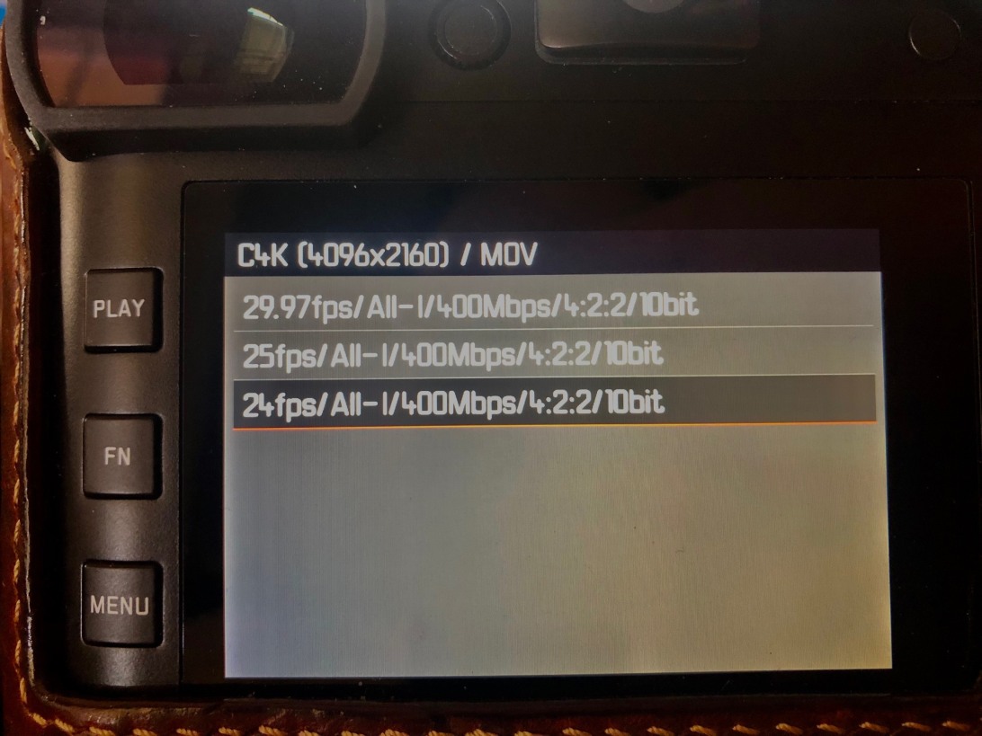

and pg 12 of the f/w pdf file show a table of the new video modes and there are more options than are shown, but perhaps they are only listing the ones that changed in some way. i read it and said: 'why no 60fps modes', but there is one under m4p fhd.

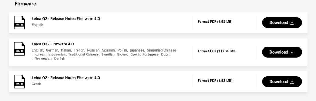

Those are release notes not the firmware upgrade. Go down the list and you will come to the file for the firmware upgrade that says "Q2___40_.lfu".

First link on the page: https://leica-camera.com/en-int/photography/cameras/q/q2-monochrom/firmware
Last but one link on this page: https://leica-camera.com/en-int/photography/cameras/q/q2-black/firmware

No, it's not a pdf! The file name is 'Q2___40_.lfu'
Looks like you downloaded the instructions/release notes!
See the post immediately above yours. You may not have gone far enough down the page.

Thanks, Paul. I've done plenty of Fujifilm firmware updates over the years. They constantly offer firmware fixes on most of their camera & lens. Fujifilm does not add instructions/release notes, they just send the file update. This is from the Leica site:
Leica Q2 Firmware update 4.0    "Format PDF (1.52 MB)"
I don't see  'Q2___40_.lfu' embedded in the instructions which is why I was asking for assistance.
