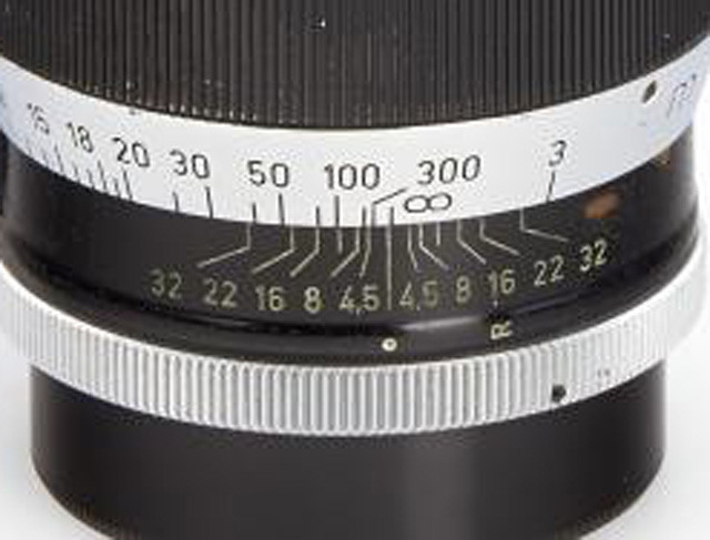

romualdo Posted February 4, 2021 Share #21 Posted February 4, 2021 Advertisement (gone after registration) 37 minutes ago, luigi bertolotti said: That's curios... by chance Lager in his books displays a Telyt very close to yours (1256534) which has the R mark... in its usual location... Welcome, dear visitor! As registered member you'd see an image here… Simply register for free here – We are always happy to welcome new members! Luigi, I stand corrected - it is there - thank you for your pic so I knew where to look. It's partially obscured by areas of black paint wear. Seeing it is a 1955 lens I should have expected to find an R mark Link to post Share on other sites More sharing options...
