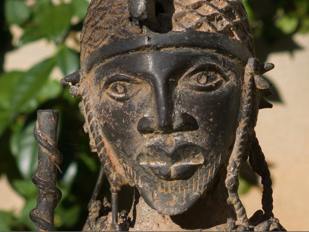

I've picked up some strange artefacts appearing on images taken with Multishot mode, especially with the VE 24-90mm L. I'm definitely not a pixel peeper, couldn't help but notice this:
Image #1- 100% crop -Multishot mode with the VE 24-90mm L @ 90mm.  You'll notice a jagged pattern in the image, almost like the edge of a hacksaw blade. ISO50 f8 1/160s  - motion correction set to OFF.
Click on the image & then click again twice to enlarge, the pattern is visible all over the image.

Image #2- 100% crop -Normal size DNG of the same image with the VE 24-90mm L. The jagged pattern is not there.
I repeated the above  exercise with the 90mm M Elmarit - ISO50 f8 1/160s
Image #1: 100% crop the jagged pattern still appears on the Musltishot image, but is far less visible than it is with the VE 24-90mm L.
Click on the image & then click again twice to enlarge, the pattern is just barely visible where I've circled it.

Image #2- 100% crop -Normal size DNG of the same image with the 90mm M Elmarit. The jagged pattern is not there.

I would certainly agree that it looks better with the M lens. Whatever went on with the VE 24-90 doesn't look right at all, i too see the jagged pattern over the whole image in that one.
I'm using the SL Summicron 50mm APO on the SL2, and can't find that type of jagged pattern in a single image i've taken so far.
Whilst it's  not a heavy set-up at all, I am using a good carbon fibre tripod (Gitzo GT1542) and Arca Swiss P0 that are remarkably solid and vibration free for their low weight.
I assume in your images that your camera is fully bolted down to rule out any of these artefacts coming from very slight movement? ...i'd imagine the tolerances for any camera movement is incredibly small for a flawless multi-shot, given the way the sensor is minutely moving around to create the final image.

The smaller the lens, the better the result :)?!? It would have been interesting to see 90-280 result as well.
I seem to get best multi-shot results with M-lenses as well.

A quwstion to those experiencing problems with Multi-shot using the 24-90 OIS zoom.  Did you turn off OIS explicitly?  It would certainly get in the way of the multishot process, and there might be a bug in which the camera forgets to do this.  I don't have this lens to try it.

Would be interesting to see the results @24mm as well. And, as @scott kirkpatrick states, with OIS at off. The 24-90 is very sharp at all but the longest focal length(s), and should be fine for the Multishot (haven't time to do the test myself...).

Image stabilization is turned off implicitly when in Multishot mode (stabilization setting not accessible). I tried turning the stabilization off then switching to Multishot and did not see any difference. Of course, there could still be some unfortunate interaction with OIS. OIS and IBIS are coupled in this case and controlled from the menu in the camera.
