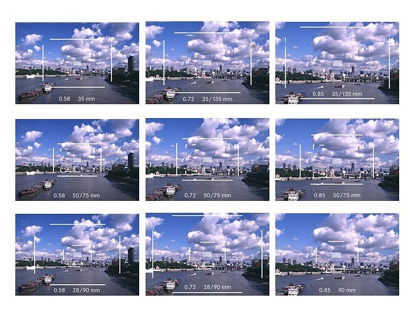

Mute-on Posted September 23, 2019 Share #3 Posted September 23, 2019 The M4 (not M4-2 or M4-P) has the following: brass advance gears (not steel) brass top plate (not zinc) 35, 50, 90, 135 framelines (no 28 or 75) glass sandwich frameline mask that can delaminate (not common) (later cameras used perforated steel frameline mask) full size framelines like all M2 and M3 ( later framelines are smaller and show less than image area, particularly at closer distances) I have an M4. Link to post Share on other sites More sharing options...

Mute-on Posted September 23, 2019 Share #6 Posted September 23, 2019 M3 does not have framelines for 35mm lens, does not have the modern film load tulip of the M4 (so is slower to load), and does not have the angled rewind crank of the M4 (so is slower to rewind). M3 has the highest rangefinder magnification of any Leica M at 0.91 times, so it is good for 50mm, 90mm and 135mm lenses. M2, M4, M6, M7 and MP all have standard magnification of 0.72 times and are more versatile for 50mm and wider lenses. Link to post Share on other sites More sharing options...

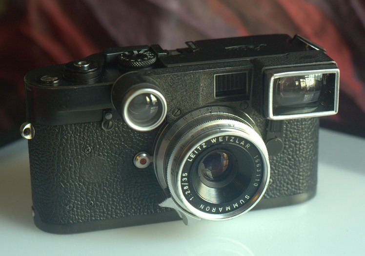

a.noctilux Posted September 23, 2019 Share #8 Posted September 23, 2019 M4-P is not bad choice but people (including myself) would choose M4 for "something else" (brass used on most part in place of steel, Germany, Silver chrome or Black Chrome/ B.Paint) not that I would not use some M4-P Plus features (Leicavit M or Motor M usable , not usable on plain M4 or M4-P framelines for 28mm if need be ). As side note, the M3 can use "35mm for M3", for fun this lens type can be purchased cheaper and usable on every Leica M 😇 here one "35mm Summaron f/2.8 for M3" used with M4-P 😔 , just to show how it looks Welcome, dear visitor! As registered member you'd see an image here… Simply register for free here – We are always happy to welcome new members! Link to post Share on other sites Simply register for free here – We are always happy to welcome new members! ' data-webShareUrl='https://www.l-camera-forum.com/topic/301804-help-on-buying-leica-m4-p-m6/?do=findComment&comment=3824782'>More sharing options...

ThomasSmithDP Posted September 24, 2019 Author Share #13 Posted September 24, 2019 12 minutes ago, EddieJ said: Hello Thomas. Welcome to LUF. Always great responses here. I use both an M4 and M6. M4 no lightmeter 35, 50, 90, 135 framelines (no 28 or 75) *thanks Mute-on. Made in Germany some later models made in Canada. M4-P no lightmeter 35/135, 50/75, 28/90 framelines. Made in Canada some later models made in Germany. M6 lightmeter 35/135, 50/75, 28/90 framelines. Made in Germany. I bought my M4 BP and the 50 Summilux. A year later was looking to add another body an M4-P but I went with an M6 and the 35 Summicron ASPH. I have always used a hand held lightmeter *prefer incident to reflective readings. As for which to go with. Depends on budget and which lens you prefer to shoot with. Welcome, dear visitor! As registered member you'd see an image here… Simply register for free here – We are always happy to welcome new members! Thank you EddieJ! When it comes to choosing either an M4 or the M4-P which one would be better in terms of build quality? I will probably buy an 35mm lens. So Framelines are no problem. I would think that the Models made in Germany use higher quality materials. Link to post Share on other sites More sharing options...
