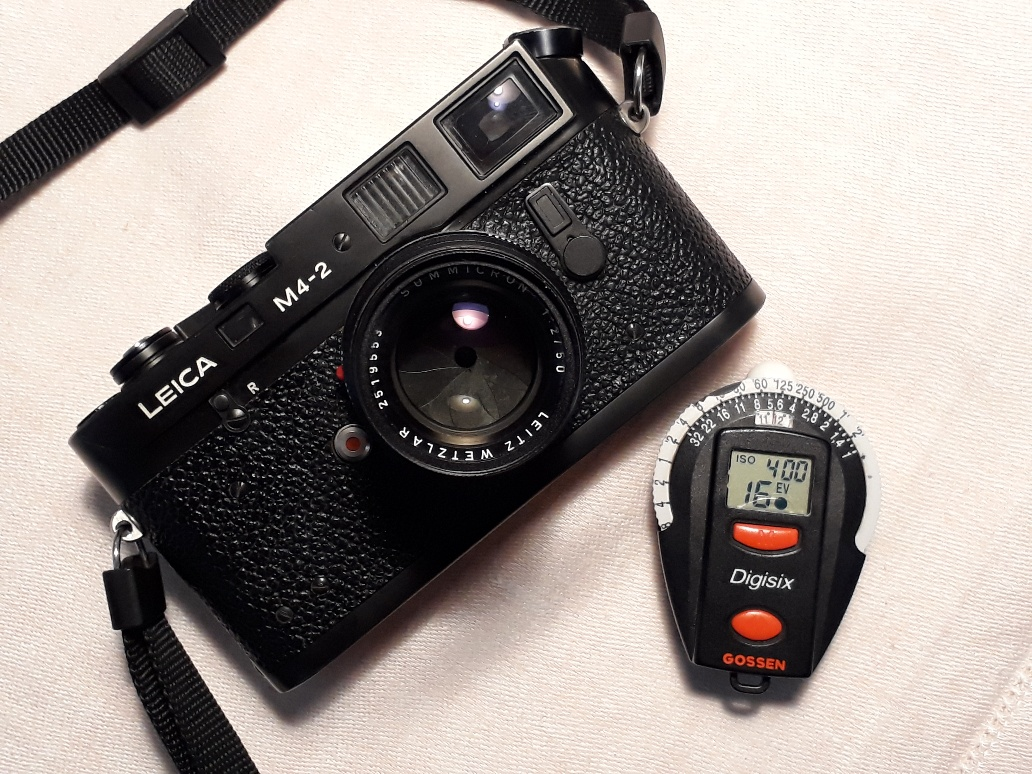

Guest Posted June 4, 2018 Share #19 Posted June 4, 2018 Profisix? Fast so gut wie Lunasix 3 ... Ganz ohne Battle-Gedanken: Was macht(e) den Lunasix 3 für Dich besser? Link to post Share on other sites More sharing options...
