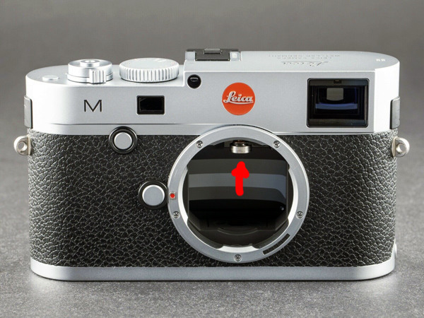

UliWer Posted March 20, 2017 Share #21 Posted March 20, 2017 Advertisement (gone after registration) Depth and width of the "throat" which has to take the collapsed tube are the same for the M10 as for M9 and M8 (I do not know the "M (240)-Family" though I think it's the same as well). So the general advise is still true: Do not attach or release a lens other it is uncollapsed. Don't apply any pressure when you feel a slight resistance pushing the tube into the cam. Look at the tube's end whether it has any irregularities. Better avoid collapsing a 1:2.5/5cm Hector (longest protrusion of the tube of all Leitz lenses). You cannot collapse the old 1:4/90mm Elmar - as its rear end is much too broad for a digital body. 3 Link to post Share on other sites More sharing options...

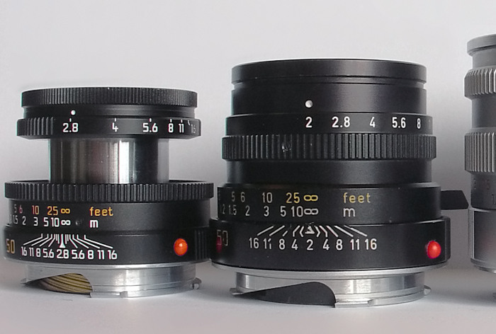

UliWer Posted March 22, 2017 Share #23 Posted March 22, 2017 (edited) True for the 1:4/90 Macro-Elmar. The last collapsable 50mm was the 1:2.8/50 Elmar-M - and its tube extends deep into the body when you collapse it. It even has a plastic ring at its rear end which makes the tube broader and enhances the risk that it hits the little wheel which activates the rangefinder. Leica CC used to take this little plastic ring off, so that you could collapse it without this risk. Edited March 22, 2017 by UliWer Link to post Share on other sites More sharing options...

Prof Peter Thomas Posted May 13, 2017 Share #29 Posted May 13, 2017 It is perfectly safe to collapse an Elmar-M 1:2.8/50 E39 (3692832) into an M10. The Elmar was my favourite travel lens with the M6; very compact and a lovely lens. When fully retracted, the Elmar projects back 20.5mm from the surface of the mounting ring when set at infinity (less when focussed closer). In the M6 the distance from the mounting ring to the metal frame in front of the shutter is 22mm. In the M10 it is 21.5mm. This leaves 1mm of clearance in the M10 with the lens fully retracted and set on infinity. The clearance of 1.5mm can be checked in the M6 with back open and the shutter open on B. The barrel on the Elmar clears the little wheel in both. With the back open on the M6 you can see that it passed very close to the wheel. To avoid touching the wheel it was always best to put the lens on the M6 in the extended position and then retract it once mounted. The same applies to the M10. You cannot manually select this lens in the menu, presumably because Leica recommend not to use any retractable lens on the M10. When enough of us find it works, we should persuade them to add it to the list. Then perhaps they would even agree to update it with the coded mount, as they will for other older lenses. 1mm of clearance is plenty in devices built to such fine tolerances. Relax and enjoy! Professor Peter Thomas 3 Link to post Share on other sites More sharing options...
a.noctilux Posted May 13, 2017 Share #30 Posted May 13, 2017 (edited) It is perfectly safe to collapse an Elmar-M 1:2.8/50 E39 (3692832) into an M10. You cannot manually select this lens in the menu, presumably because Leica recommend not to use any retractable lens on the M10. When enough of us find it works, we should persuade them to add it to the list. Then perhaps they would even agree to update it with the coded mount, as they will for other older lenses. 1mm of clearance is plenty in devices built to such fine tolerances. Relax and enjoy! Professor Peter Thomas Professor, in my M10 Menu I see a line with "50 f/2.8 11831/11823/11824". Not your M10 ? 11831 is black Elmar-M 11823 chrome . Can be coded also as "100010" From the FAQ here https://www.l-camera-forum.com/topic/185433-m-lens-codes/ Edited May 13, 2017 by a.noctilux Link to post Share on other sites More sharing options...
jaapv Posted May 14, 2017 Share #31 Posted May 14, 2017 It is perfectly safe to collapse an Elmar-M 1:2.8/50 E39 (3692832) into an M10. The Elmar was my favourite travel lens with the M6; very compact and a lovely lens. When fully retracted, the Elmar projects back 20.5mm from the surface of the mounting ring when set at infinity (less when focussed closer). In the M6 the distance from the mounting ring to the metal frame in front of the shutter is 22mm. In the M10 it is 21.5mm. This leaves 1mm of clearance in the M10 with the lens fully retracted and set on infinity. The clearance of 1.5mm can be checked in the M6 with back open and the shutter open on B. The barrel on the Elmar clears the little wheel in both. With the back open on the M6 you can see that it passed very close to the wheel. To avoid touching the wheel it was always best to put the lens on the M6 in the extended position and then retract it once mounted. The same applies to the M10. You cannot manually select this lens in the menu, presumably because Leica recommend not to use any retractable lens on the M10. When enough of us find it works, we should persuade them to add it to the list. Then perhaps they would even agree to update it with the coded mount, as they will for other older lenses. 1mm of clearance is plenty in devices built to such fine tolerances. Relax and enjoy! Professor Peter Thomas It is obvious that any lens built not to touch the shutter of a film camera won't do so on a digital one either; the register distance is the same. The risk, however, is that it will damage the inside of the camera mouth and the structures therein. So the real question is whether the diameter of the lens tube is not too large relative to the depth that it is collapsed to. The old Elmar 90/4.0 is such a lens, as it collapses so deep that the edge of the barrel comes dangerously close to the baffles in front of the shutter, and some older Elmar 50 lenses have a wide ring at the end that is hazardous as well. I think Uli has explained this quite extensively in this thread. 1 Link to post Share on other sites More sharing options...
