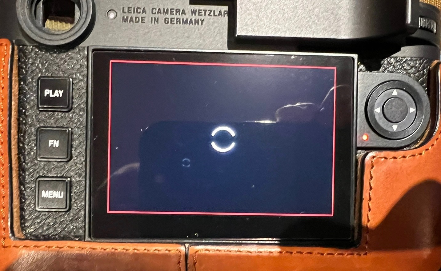

harmen Posted June 1, 2024 Share #238 Posted June 1, 2024 My M11 has just had its second crash in its entire life. I’ve had it since it came onto the market. The first crash was a few weeks ago, just before the new firmware arrived. Today it got stuck while formatting the sd card. I had just downloaded photos with Leica Fotos on an iPad via wifi. That was the usual glitchy affair with at least 5 tries and once having to turn the camera off before it managed to download all 4 photos. With a cable it is much more reliable. Anyway, once the photos had downloaded, and while the app was still having a connection, I decided to format the card as I always do. After a while the app told me it disconnected because the storage had changed. However the camera never got out of formatting. Removing the battery brought it back to normal. Welcome, dear visitor! As registered member you'd see an image here… Simply register for free here – We are always happy to welcome new members! Link to post Share on other sites Simply register for free here – We are always happy to welcome new members! ' data-webShareUrl='https://www.l-camera-forum.com/topic/395262-did-the-may-2024-firmware-update-211-solve-your-m11-freezing-problems/?do=findComment&comment=5318141'>More sharing options...

jaapv Posted June 1, 2024 Share #240 Posted June 1, 2024 2 hours ago, harmen said: My M11 has just had its second crash in its entire life. I’ve had it since it came onto the market. The first crash was a few weeks ago, just before the new firmware arrived. Today it got stuck while formatting the sd card. I had just downloaded photos with Leica Fotos on an iPad via wifi. That was the usual glitchy affair with at least 5 tries and once having to turn the camera off before it managed to download all 4 photos. With a cable it is much more reliable. Anyway, once the photos had downloaded, and while the app was still having a connection, I decided to format the card as I always do. After a while the app told me it disconnected because the storage had changed. However the camera never got out of formatting. Removing the battery brought it back to normal. Welcome, dear visitor! As registered member you'd see an image here… Simply register for free here – We are always happy to welcome new members! I guess deep formatting the card in SD formatter will cure the problem. There are strong indications that the problems were caused by hidden files. If the file structure of the card is damaged, a simple format will not help. It is no more than replacing the first bit of all files by a question mark, making them superficially invisible. To restore the proper structure on the card only a full format will do. 1 Link to post Share on other sites More sharing options...
