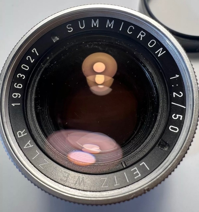

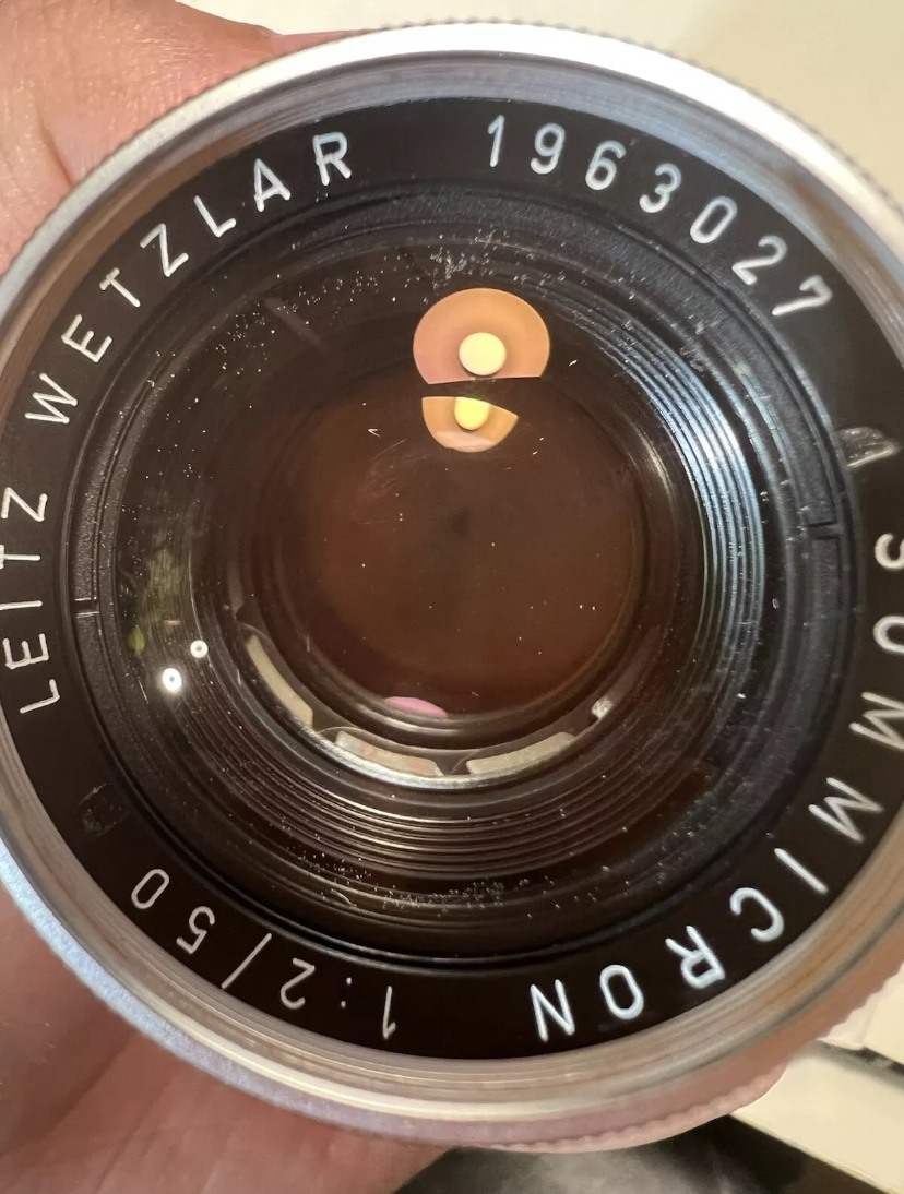

I’ve been offered this lens for a cheap price because of the marking seen with a spotlight test. Does this look like fungus or just cleaning marks ? Apparently the marks are on the rear lens.
Is there any chance at all that this could be usable, possible to be repaired or should I just walk away no matter how cheap ?

Are you being serious? I've never seen a lens in such a pitiful state. Were you to buy it everything you shoot will look like it's been snapped through a '+3' soft-focus filter and the film you used was 25 years past its 'Use By' date into the bargain.
Looking for the upsides? It would make a wonderfully inexpensive alternative to a Thambar...

Coating marks and micro-scratches from over cleaning is common on the collapsible a the two rigid Sumicrons - glass and coating was very soft.
It will cause some degree of contrast drop depending on lighting conditions. These defects can never be remedied economically. If you buy such a lens you should think of it as permanent.
The lens you show however seems to have something more servere going on. It looks 3 dimensional to my eye which would indicate something more problematic.
There was a Summarit in a very similar condition hanging on an M2 that I bought.
Of course I tried it out anyway. And was surprised that it still worked. With the aperture open, the subjects were very blurred, and stopped down they were even quite usable. I sold it later. The buyer was looking for something exactly like this...
