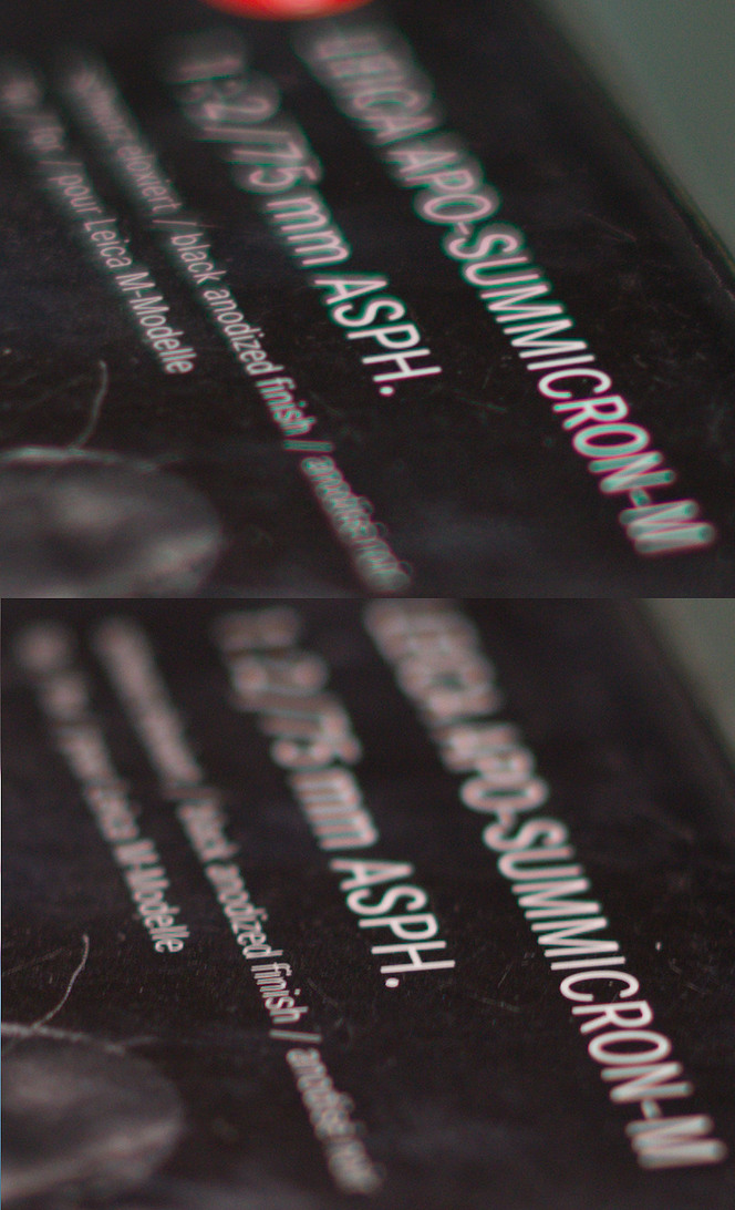

Airy discs I wouldn't know about, specifically. But here is a comparison of the 75 Summilux at f/1.4 (top) and the 75 APO-Summicron-ASPH at f/2 (bottom).
Note that the Summilux's spherical aberration produces more effective depth of field (readable letters), even at f/1.4. Overlaid sharp and fuzzy images in different focus planes, but a lot of them still "sharp enough" to be legible. In terms of the Wikipedia diagram I linked to above, the 75 Summilux is like the top and bottom ray-map sections.
Compared with the 75 ASMA, which at f/2 has one well-defined focus plane, rapidly dropping off to illegible blur. Like the central image in those ray sections.
Interestingly, I have never seen focus shift with the 75 Summilux. Which may explain why Dr. Mandler was so proud of this lens - he worked some kind of magic with the element spacing or glass types or spherical radii such that the "point of best focus" does not shift with aperture, even while revealing that there are many different stacked light-cone-sections (fuzzy over sharp) landing in the image plane on top of each other.
Or maybe used a tradeoff or balancing with the longitudinal chromatic aberration (of which the Summilux has a lot) so that one gets sharp and fuzzy red and cyan images (chromatic bokeh) from the SA, but the "combined white" burns through as readably sharp. The field of "best reasonable focus" is deeper, but acquires rainbow tints. Leitz still tended to "think in B&W" back in 1980, at least for the M lenses.
For proxy-focusing with a rangefinder, the Summilux allows more room for small focus errors. The "soft-sharpness" of the contemporary 90 Summicron-M v.3 is similar, just less extreme.
