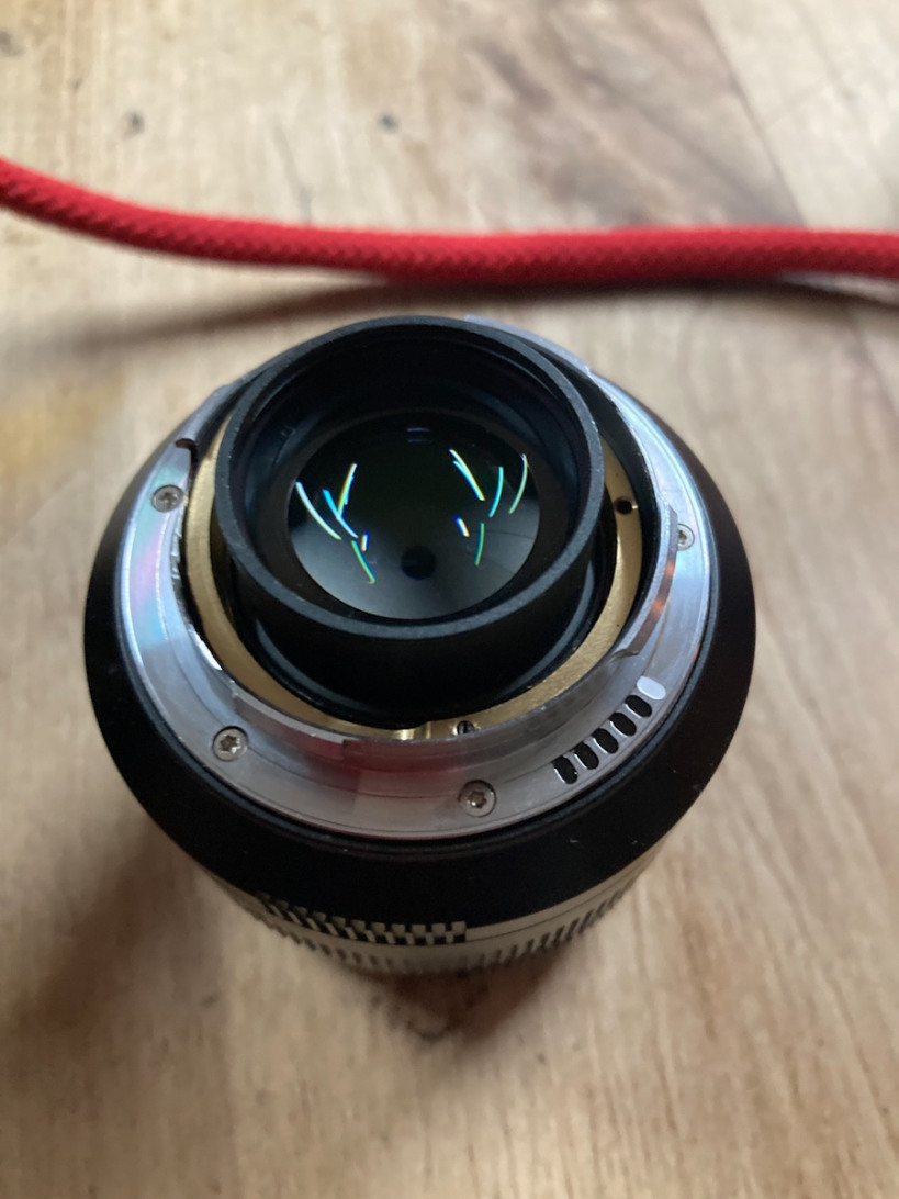

6bit Posted August 1, 2021 Share #92 Â Posted August 1, 2021 Has anyone else tried the 7Artisans 1.1/50mm on the Leica SL? The rubber that protects the rear element protrudes back to far and hits the inside of the shutter box on the SL. This stops the lens from focusing to infinity. The factory could at one time rework the rubber encasement (shortening the length by a small bit). Unsure if they still can. Â Link to post Share on other sites More sharing options...

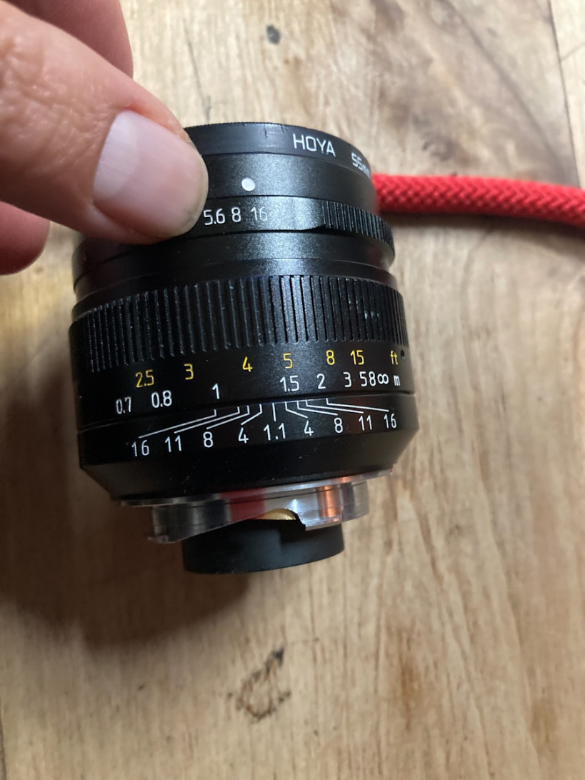

Rodrigo castillo Posted August 1, 2021 Share #93  Posted August 1, 2021 9 minutes ago, 6bit said: Has anyone else tried the 7Artisans 1.1/50mm on the Leica SL? The rubber that protects the rear element protrudes back to far and hits the inside of the shutter box on the SL. This stops the lens from focusing to infinity. The factory could at one time rework the rubber encasement (shortening the length by a small bit). Unsure if they still can.  Not in SL but in CL, I assume that the distance is the same or less in the CL, and didn’t have any problem 1 Link to post Share on other sites More sharing options...
6bit Posted August 1, 2021 Share #94  Posted August 1, 2021 1 hour ago, Rodrigo castillo said: Not in SL but in CL, I assume that the distance is the same or less in the CL, and didn’t have any problem Do you mind posting a photo of your rear element?  can anyone else stick this lens in a SL? I have three copies. Black, silver, and red. Black and silver are 6 but encoded. The red one isn’t. Link to post Share on other sites More sharing options...
Rodrigo castillo Posted August 2, 2021 Share #95  Posted August 2, 2021 Sure, Welcome, dear visitor! As registered member you'd see an image here… Simply register for free here – We are always happy to welcome new members! Link to post Share on other sites Simply register for free here – We are always happy to welcome new members! ' data-webShareUrl='https://www.l-camera-forum.com/topic/307813-best-7artisans-m-mount-lenses/?do=findComment&comment=4249636'>More sharing options...

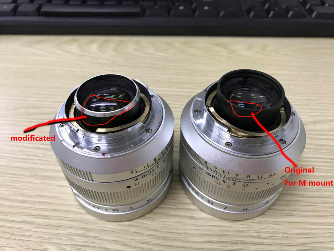

6bit Posted August 2, 2021 Share #96  Posted August 2, 2021 Thank you for reporting your experience and posting the photos. At the time I contacted the company, July 2019, they told me there are two versions. They didn't going into detail on how to tell. They did send me this photo to show the modification. I thought about just cutting the rubber down with one of my sharp knives. Welcome, dear visitor! As registered member you'd see an image here… Simply register for free here – We are always happy to welcome new members! Link to post Share on other sites Simply register for free here – We are always happy to welcome new members! ' data-webShareUrl='https://www.l-camera-forum.com/topic/307813-best-7artisans-m-mount-lenses/?do=findComment&comment=4249648'>More sharing options...
gbealnz Posted August 5, 2021 Share #97  Posted August 5, 2021 Don't think it's rubber. In the early days I had a couple. First one (in an SL) wouldn't reach focus at infinity, the rear cell contacted something within. Subsequent version, after I mentioned it, was modified by what looked like the rear cell being turned down, the edge anyway. If it had been painted black like the unlathed section you'd never know it. I got annoyed with its poor performance and sold it, I won't buy another. Their 35/2 however I do like. 1 Link to post Share on other sites More sharing options...
ale73 Posted September 6, 2024 Share #98 Â Posted September 6, 2024 Hi All, can some one explain exactly how many mm i have to cut to let the lens works fine at infinity on Sl or lumix camera? i have to reduce the rear cel all or just as picture above il lateral way from top to down?, thanks in advance Alessandro Link to post Share on other sites More sharing options...
