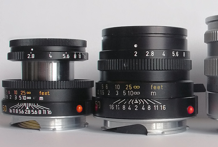

In extended position, it is my most compact 50 besides the Summarit 50/2.5. Here with the Summicron 50/2 v4.
Looks so familiar :) Owned both. But I'm filter and hood user, as I already mentioned.
