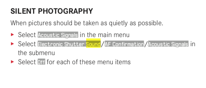

jaapv Posted July 17, 2019 Share #84 Posted July 17, 2019 On 7/17/2019 at 6:38 AM, dawnbreeze said: Hello guys..I'm such a newbie and this question is gonna be sounds strange. However, Can I mute the shutter sound of CL for both of mechanical and electronical one? I was trying to take interval shots and I believe the shutter sound make a boost for battery draining. Please help! Use the electronic shutter. The mechanical shutter sound cannot be muted, as it is umm... mechanical. On 7/17/2019 at 7:17 PM, lct said: Welcome, dear visitor! As registered member you'd see an image here… Simply register for free here – We are always happy to welcome new members! 1 Link to post Share on other sites More sharing options...
