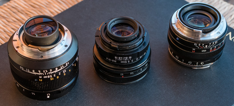

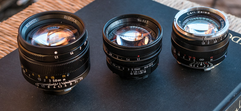

FrozenInTime Posted July 13, 2017 Share #147 Posted July 13, 2017 Advertisement (gone after registration) It's most definitely not a clone of any lens that I'm aware of. Three very different 'Sonnar' lenses ( at sunset ) 1 Link to post Share on other sites More sharing options...

FrozenInTime Posted July 13, 2017 Share #149 Posted July 13, 2017 One site selling the 7Artisans (and also, I see, FrozeninTime) claims it's a Sonnar-type, but I don't buy that - classic Sonnars are defined by a second group of 3 (!) cemented elements, which the 7A f/1.1 doesn't use. A different "genetic pathway." I was also questioning the 'Sonnar' tag. 2 Link to post Share on other sites More sharing options...
