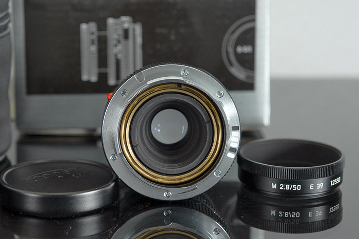

lct Posted January 9, 2020 Share #47 Posted January 9, 2020 Advertisement (gone after registration) 3 hours ago, Alberti said: Today I was at the Leica Store Beaumarchais where they have an 50mm Elmar-M. No said the man, looking at my M240, you can’t use this on a digital body. [...] This guy doesn't seem to know that the latest copies of the lens have been sold with 6-bit coding. Beware that the bottom of the tube is very close to the roller cam though. Welcome, dear visitor! As registered member you'd see an image here… Simply register for free here – We are always happy to welcome new members! 1 Link to post Share on other sites Simply register for free here – We are always happy to welcome new members! ' data-webShareUrl='https://www.l-camera-forum.com/topic/268995-is-it-safe-to-collapse-lenses-on-the-m10/?do=findComment&comment=3888423'>More sharing options...
UliWer Posted January 9, 2020 Share #48 Posted January 9, 2020 Your illustration shows where the „problem“ of collapsible lenses lies: it is not the shutter but the roller cam! Though this is no novelty of digital bodies, the „problem“ exists since Barnack‘s Leica II and Berek‘s Elmar. Everybody who likes can test it. With a screw-mount body you can easily feel the resistance of the roller cam, when you collapse some lenses: the Summitar is a good candidate, as its tube was a little bit broader. Barnack and Berek could live with the „problem“; only in times of the Internet and customer warnings it becomes an „issue“. Of course it is still true that the lens should be attached and released only when it is extended. Since the „throat“ of the digital M bodies is much narrower there is a risk to scratch the throat when you attach or release the lens in an unfortunate angle. That‘s also the reason you cannot use the old collapsible 4/90mm Elmar with a digital body: its rear end is too broad to enter the narrow throat.You should not even try, Link to post Share on other sites More sharing options...
lct Posted January 9, 2020 Share #49 Posted January 9, 2020 2 minutes ago, UliWer said: [...] Though this is no novelty of digital bodies, the „problem“ exists since Barnack‘s Leica II and Berek‘s Elmar. [...] The bottom of the Elmar-M's tube is larger than that of the Elmar though. Novelty since 1994 but nothing specific to digital i agree. Link to post Share on other sites More sharing options...
UliWer Posted January 9, 2020 Share #50 Posted January 9, 2020 (edited) vor 5 Stunden schrieb Herr Barnack: I cannot give any information/advice regarding use of this lens on the M10, though. I am not giving any recommendations to do so, but I tried the 50mm Elmar (older version as well as Elmar-M) with M8, M9, M10 - and collapsed them. No problem. If someone tries to collapse it - do it slowly and carefully the first time - and realizes the resistance of the roller cam he should stop the movement. The Elmar-M has a black plastic ring at the tube’s end, which increases the diameter and therefore the risk of collision with the roller cam. Leica Customer Care may cut off the black plastic ring at the tube‘s end to solve the „problem“. P.S: looked again at my my Elmar-M: I am not sure whether it is plastic or metal, it is black and obvious. People from the German Forum have reported that they had cut off this ring by Customer Care in Solms or Wetzlar - on recommendation by the staff there. Edited January 9, 2020 by UliWer Link to post Share on other sites More sharing options...
lct Posted January 9, 2020 Share #51 Posted January 9, 2020 10 minutes ago, UliWer said: [...] The Elmar-M has a black plastic ring at the tube’s end, which increases the diameter and therefore the risk of collision with the roller cam. [...] This ring is full metal as i sense it but i may be wrong. Link to post Share on other sites More sharing options...

Alberti Posted January 10, 2020 Share #57 Posted January 10, 2020 21 hours ago, lct said: This guy doesn't seem to know that the latest copies of the lens have been sold with 6-bit coding. Beware that the bottom of the tube is very close to the roller cam though. Welcome, dear visitor! As registered member you'd see an image here… Simply register for free here – We are always happy to welcome new members! Having the 6-bit code is indeed very convincing that the lens is made in the digital era. The roller cam is not visible in a digital M like this , but I assume the structure is the same for all Leica's - it is part of the rangefinder which retained its structure - placement being the most important thing, and thickness of the roller is secondary - for some 65 years. It all depends on how well the tube retainer is made - in my Macro-Elmar-M I can feel some play when inserted (wobble?) but not with this 50mm Elmar-M. Anyway, I should go to another shop and have another try. (I have a Canon macro lens based on the Tessar and it is very very good). Link to post Share on other sites More sharing options...
lct Posted January 10, 2020 Share #58 Posted January 10, 2020 My favorite 50 in good light. BTW the roller cam is just in front of you when you remove the body cap . Welcome, dear visitor! As registered member you'd see an image here… Simply register for free here – We are always happy to welcome new members! 1 1 Link to post Share on other sites Simply register for free here – We are always happy to welcome new members! ' data-webShareUrl='https://www.l-camera-forum.com/topic/268995-is-it-safe-to-collapse-lenses-on-the-m10/?do=findComment&comment=3889015'>More sharing options...
