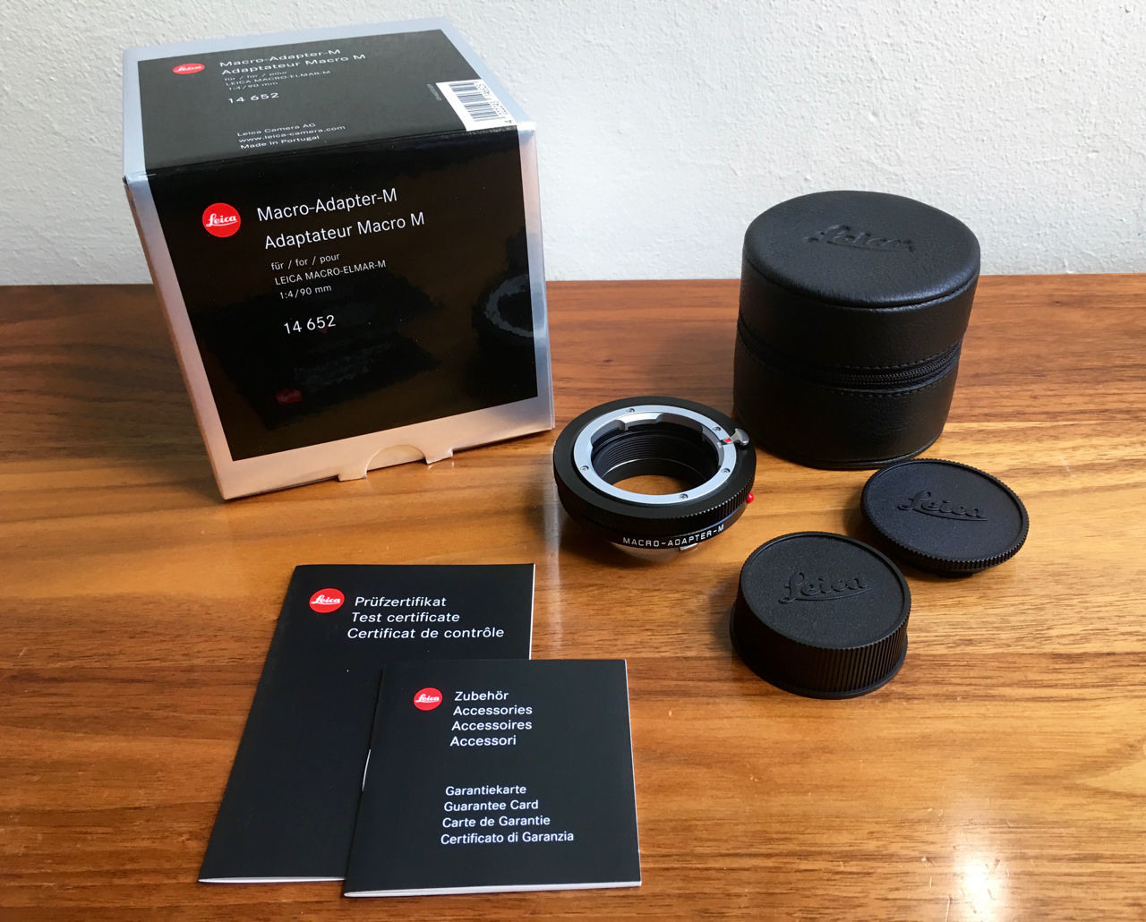

Jared Posted March 10, 2017 Share #11 Posted March 10, 2017 Can the Macro Adapter M be usefully used with M lenses on the SL (with relevant M adapter of course)? The new Macro Adapter M (the one without goggles) is intended for use with an EVF and so works just fine on the SL. The older one, with the goggles, still works on the SL but is a little "clunky" since you have a strange, useless appendage sticking out of your lens. Not a big deal from a practical standpoint. The newer one intended for use with EVF cameras and M(240) and later M models has the added benefit of a helicoid extension so it brings macro capability on the 90mm all the way to 1:2. On the old adapter I think you could only reach 1:3. - Jared 2 Quote Link to post Share on other sites More sharing options...
