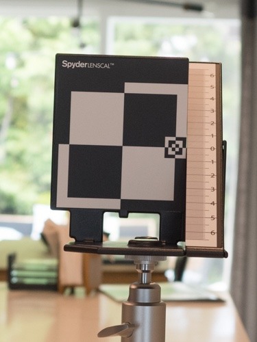

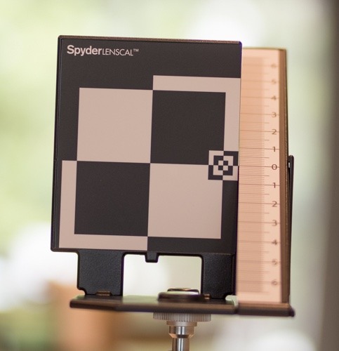

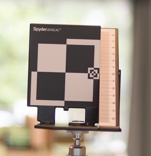

TheEyesHaveIt Posted May 23, 2023 Author Share #22 Posted May 23, 2023 (edited) Thank you all! Some great tips here - and of course, practice practice practice being the key. I think I'll also download PhotoPills as having that DoF chart will be handy (I've tried to utilize the one on the lens as well, but still getting used to it). And certainly, for critical focus at low apertures, it seems that the RF likely won't work - the Visoflex plus zoom is critical as the following two test shots I just took illustrate: 50mm f1.4 - focused with RF (shot on tripod, so couldn't really do the wiggle technique, but tried covering and uncovering the right RF window with my finger to see if stuff moved). Front focused the target. Challenge with the RF is it is hard to know if you're looking straight on at the patch - there's a parallax effect within the viewfinder as well which throws off the alignment. Welcome, dear visitor! As registered member you'd see an image here… Simply register for free here – We are always happy to welcome new members! 50mm f1.4 with the Visoflex plus zoom Edited May 23, 2023 by TheEyesHaveIt 2 Quote Link to post Share on other sites Simply register for free here – We are always happy to welcome new members! 50mm f1.4 with the Visoflex plus zoom ' data-webShareUrl='https://www.l-camera-forum.com/topic/377329-tips-for-nailing-focus/?do=findComment&comment=4778217'>More sharing options...

TheEyesHaveIt Posted May 24, 2023 Author Share #24 Posted May 24, 2023 (edited) 17 minutes ago, lct said: Seems like the RF of your M11 needs some calibration and your outcomes with the EVF are not as sharp as they should be with a lens like the Summilux 50/1.4 asph. Testing the camera, the lens, and possibly your eyesight could be a wise idea. These were from about 10 feet away (and the images are heavily zoomed in screenshots from Lightroom) so even the zoom in the EVF is not close enough. I have noticed if I hook my iPhone up to the camera and use the Leica app as the "EVF", I can get even sharper. But how would I go about confirming that I need calibration (either of the RF or the lens)? Edited May 24, 2023 by TheEyesHaveIt 1 Quote Link to post Share on other sites More sharing options...

dugby Posted May 24, 2023 Share #26 Posted May 24, 2023 (edited) Your 50Lux seems to be front-focusing by at least 6.5" units... which 50Lux do you have ? My 50 LUX (ASPH) (on both M240 and M10-R) can have some rear focusing if I don't do the following : I start from infinity and only turn the focusing one way (only) until I hit the focus of the subject, do NOT toggle back and forth over the focusing position. If I use the above technique my 50Lux will focus almost perfectly at #1.4 All my other lenses on M240 and M10-R focus perfectly, even with toggling back and forth over the focal point: 35FLE, 50APO and Zeiss ZM Planar 50 Edited May 24, 2023 by dugby Quote Link to post Share on other sites More sharing options...

TheEyesHaveIt Posted May 24, 2023 Author Share #29 Posted May 24, 2023 12 hours ago, dugby said: Your 50Lux seems to be front-focusing by at least 6.5" units... which 50Lux do you have ? My 50 LUX (ASPH) (on both M240 and M10-R) can have some rear focusing if I don't do the following : I start from infinity and only turn the focusing one way (only) until I hit the focus of the subject, do NOT toggle back and forth over the focusing position. If I use the above technique my 50Lux will focus almost perfectly at #1.4 All my other lenses on M240 and M10-R focus perfectly, even with toggling back and forth over the focal point: 35FLE, 50APO and Zeiss ZM Planar 50 How do I know if the lens is front-focusing or if the viewfinder if miscalibrated though? With the EVF to focus, the lens focused in the right place (but maybe it is in the "wrong" place based on the position of the focus ring?). Quote Link to post Share on other sites More sharing options...
lct Posted May 24, 2023 Share #30 Posted May 24, 2023 1 hour ago, TheEyesHaveIt said: How do I know if the lens is front-focusing or if the viewfinder if miscalibrated though? With the EVF to focus, the lens focused in the right place (but maybe it is in the "wrong" place based on the position of the focus ring?). RF miscalibrations are not relevant when the RF is not used for focusing. I'm not sure your lens is in perfect shape, though, so i would ask a good repair shop like DAG, as suggested. 1 Quote Link to post Share on other sites More sharing options...
jdlaing Posted May 24, 2023 Share #31 Posted May 24, 2023 2 hours ago, TheEyesHaveIt said: How do I know if the lens is front-focusing or if the viewfinder if miscalibrated though? With the EVF to focus, the lens focused in the right place (but maybe it is in the "wrong" place based on the position of the focus ring?). The distance markings on the focus ring are a hold over from 60+ years ago and may not be accurate. If you use an EVF to achieve focus and check it against the focus patch in the viewfinder the patch should show accurate focus. If it does not, and the EVF image is in focus, the rangefinder may need calibrating. Quote Link to post Share on other sites More sharing options...
