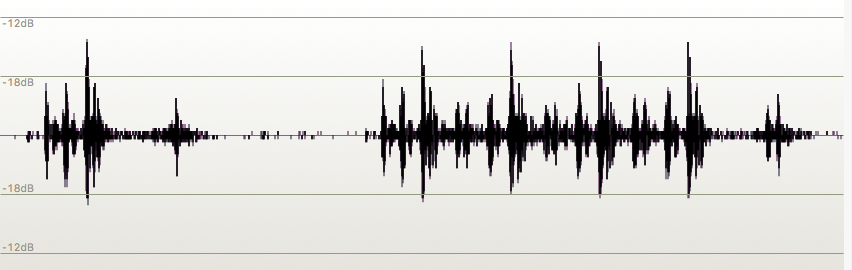

hdmesa Posted July 7, 2022 Share #68 Posted July 7, 2022 (edited) On 7/4/2022 at 7:25 AM, lct said: Leica should find a way to shorten the M11's shutter sound in single shot mode. The M240's value in classic mode (210ms) is OK for me but the M11's (320ms) feels too long. I'm having trouble communicating the issue to Leica. They're thinking I'm talking about the delay between exposures, so they're saying of course single shot is slower because it meters between shots. I'm trying to say that the delay is during the shutter sequence and not between shots. I would like to show Leica the two charts of yours that I merged into one visual; however, I think the difference in the graph heights and my scaling of them will confuse the issue. If you're willing, it would be extremely helpful to have a single visual of a single recording. Single recording without stopping (same shutter speed for both modes): Start recording Take exposure in single shot Without stopping the recording, change to continuous-high Take second shot End recording Edit the audio clip to trim out the dead time in between when you were changing modes This will give us one audio timeline where we can show exact differences in volume and duration. It will also rule out variables like distance of mic to the shutter affecting the volume, etc. Edited July 7, 2022 by hdmesa Link to post Share on other sites More sharing options...
lct Posted July 7, 2022 Share #69 Posted July 7, 2022 1 hour ago, hdmesa said: I'm having trouble communicating the issue to Leica. They're thinking I'm talking about the delay between exposures, so they're saying of course single shot is slower because it meters between shots. I'm trying to say that the delay is during the shutter sequence and not between shots. I would like to show Leica the two charts of yours that I merged into one visual; however, I think the difference in the graph heights and my scaling of them will confuse the issue. If you're willing, it would be extremely helpful to have a single visual of a single recording. Single recording without stopping (same shutter speed for both modes): Start recording Take exposure in single shot Without stopping the recording, change to continuous-high Take second shot End recording Edit the audio clip to trim out the dead time in between when you were changing modes This will give us one audio timeline where we can show exact differences in volume and duration. It will also rule out variables like distance of mic to the shutter affecting the volume, etc. No problem. C1130720_mod.mp3 Welcome, dear visitor! As registered member you'd see an image here… Simply register for free here – We are always happy to welcome new members! 1 Link to post Share on other sites Simply register for free here – We are always happy to welcome new members! ' data-webShareUrl='https://www.l-camera-forum.com/topic/334121-shutter-lag-comments-from-jesko-von-oeynhausen/?do=findComment&comment=4467000'>More sharing options...
hdmesa Posted July 7, 2022 Share #70 Posted July 7, 2022 20 minutes ago, lct said: No problem. C1130720_mod.mp3 41.7 kB · 51 downloads Welcome, dear visitor! As registered member you'd see an image here… Simply register for free here – We are always happy to welcome new members! Really interesting as this shows that even in continuous high, the last shot in the series reverts to the longer time delay to reopen the shutter at the end of the exposure. I can see, though, that shutter volume is the same between single shot and continuous-high. So if this behavior is intentional, it must be to reduce wear on the shutter. Link to post Share on other sites More sharing options...
hdmesa Posted July 7, 2022 Share #71 Posted July 7, 2022 (edited) 2 hours ago, lct said: No problem. C1130720_mod.mp3 41.7 kB · 179 downloads Welcome, dear visitor! As registered member you'd see an image here… Simply register for free here – We are always happy to welcome new members! Here is what I'm sending to Leica based on your recording: Edited July 7, 2022 by hdmesa 3 2 Link to post Share on other sites More sharing options...
hdmesa Posted July 8, 2022 Share #72 Posted July 8, 2022 @lct – Update: The Leica representative is forwarding the shutter closure delay issue on to the development team to investigate. Thanks for your help with the recordings 👍 5 2 Link to post Share on other sites More sharing options...
