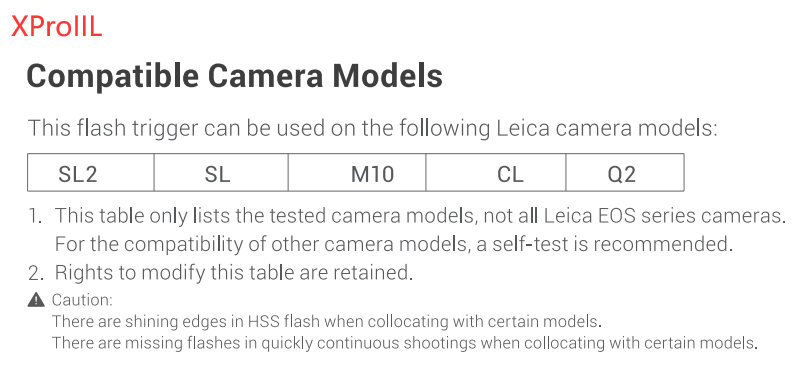

ynp Posted September 17, 2022 Share #62 Posted September 17, 2022 (edited) 1 hour ago, Almizilero said: Only now thought to try things with the Q. The Q camera can sync at all the shutter speeds with all flashes. It has a Central Leaf shutter in the lens. I have updated my ad100 pro and it works with my M10-r well. Edited September 17, 2022 by ynp Link to post Share on other sites More sharing options...

Hanno Posted September 22, 2022 Share #67 Posted September 22, 2022 (edited) Advertisement (gone after registration) 3 hours ago, Almizilero said: So you can use the AD200Pro(A) with the Trigger and HSS works even at high sync speeds? I'm beginning to think that I got a bugged trigger. I have one 200Pro and one 200Pro-A, both updated fine, both don't work with high sync speeds even though they indicate they're in HSS mode. Just in case, it would be worth double checking that the stable colour mode is switched off. It’s F8 in the menu. Otherwise, the HSS sign will show but the flash unit will not be triggered. Edited September 22, 2022 by Hanno Link to post Share on other sites More sharing options...
Almizilero Posted September 22, 2022 Share #68 Posted September 22, 2022 (edited) vor 8 Stunden schrieb Hanno: Just in case, it would be worth double checking that the stable colour mode is switched off. It’s F8 in the menu. Otherwise, the HSS sign will show but the flash unit will not be triggered. No, that works. Flashes are triggered with Stable Colour on or off. But I get bright and dark stripes in the image, so HSS isn't working in both cases. Edited September 22, 2022 by Almizilero Link to post Share on other sites More sharing options...

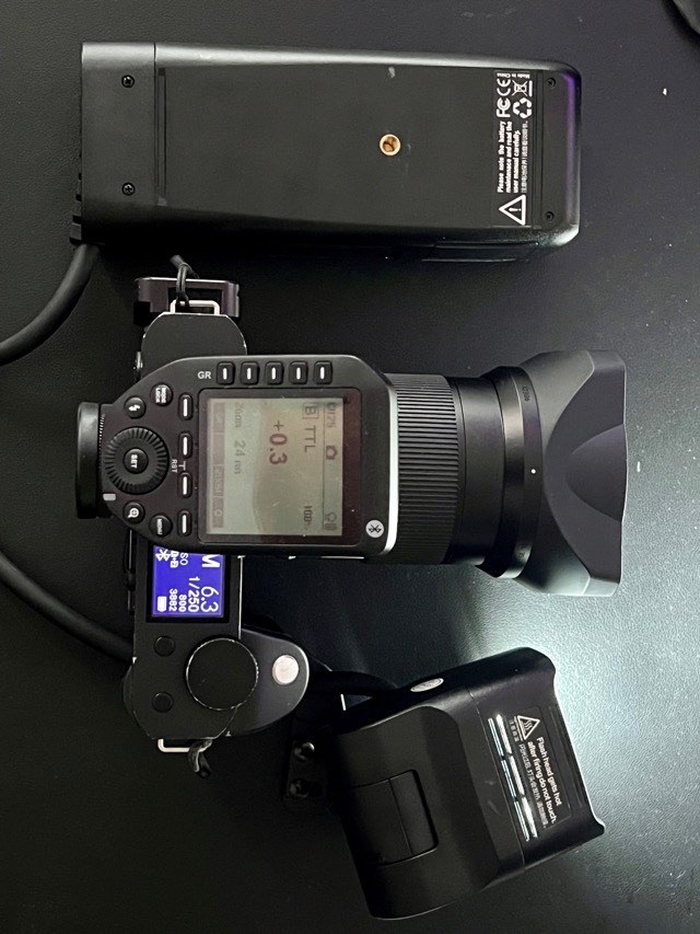

ynp Posted September 27, 2022 Share #78 Posted September 27, 2022 2 hours ago, sillbeers15 said: I did not encounter the tricky issue of Mode change from M to TTL under uncontrollable situation when I used the XproIIL with AD300. Thank you for the movie with the instructions. 🙏 I have started testing the trigger today. No problems with the HSS and my AD100 pro and AD200 in the TTL mode in the studio. Will get an AD300 next week and try them all outside for the HSS. As of now, it works in HSS on my CL. But I need more time to get acquainted with the trigger. 1 Link to post Share on other sites More sharing options...

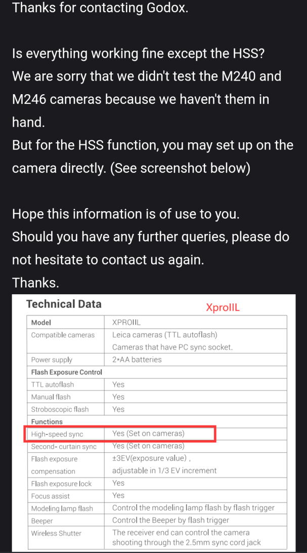

ynp Posted September 27, 2022 Share #79 Posted September 27, 2022 Unfortunately, the XproIIL does not work in HSS with my Leica S3. The TTL works, but anything shorter than 1/125 seconds makes a black frame. I tested my setup with the AD100Pro. Curiously enough, even TTL measurements were not consistent frame by frame. As a manual trigger it works well. Link to post Share on other sites More sharing options...
sillbeers15 Posted September 28, 2022 Share #80 Posted September 28, 2022 5 hours ago, ynp said: Unfortunately, the XproIIL does not work in HSS with my Leica S3. The TTL works, but anything shorter than 1/125 seconds makes a black frame. I tested my setup with the AD100Pro. Curiously enough, even TTL measurements were not consistent frame by frame. As a manual trigger it works well. Write to Kiona Guo @ ‘servicesupport@godox.com’ of Godox Technical support, I hope they can help you. They responded well & fast to my queries. Link to post Share on other sites More sharing options...
