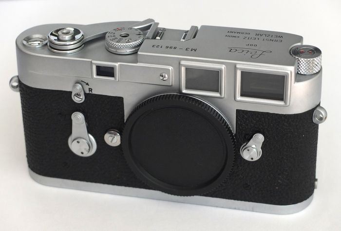

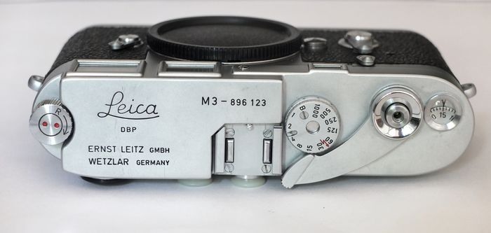

DoubleE Posted June 14, 2022 Share #1  Posted June 14, 2022 (edited) Advertisement (gone after registration) A friend has offered to sell me M2 - 1006 145 with fresh CLA at a very reasonable price. Somehow this camera has an M3 frame counter, a feature which appeals to me because it will load exactly like my primary film body which is an M3, but it will have the M2 rangefinder. Could this be a factory installed option, or possibly a special order item from Leitz, or is it some kind of aftermarket job? I'm hoping someone here has the experience and knowledge to advise me. From the photos it looks pretty original, or if not, very professionally done. I'm interested in the camera because it's an affordable user and happens to suit my workflow, but I was hoping to find out if it's actually a rather unique and special thing or more of an oddity, in which case I might be overpaying. Please forgive the hasty photos--done by my friend, not me. Welcome, dear visitor! As registered member you'd see an image here… Simply register for free here – We are always happy to welcome new members! Edited June 14, 2022 by DoubleE typo 2 Link to post Share on other sites Simply register for free here – We are always happy to welcome new members! ' data-webShareUrl='https://www.l-camera-forum.com/topic/333538-m2-with-m3-frame-counter/?do=findComment&comment=4453977'>More sharing options...

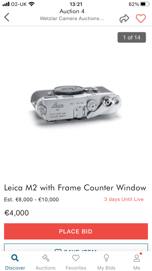

Advertisement Posted June 14, 2022 Posted June 14, 2022 Hi DoubleE, Take a look here M2 with M3 Frame Counter. I'm sure you'll find what you were looking for!

TomB_tx Posted June 14, 2022 Share #3 Â Posted June 14, 2022 The M3 counter resets when the take-up spool is pulled off the shaft, while the similar-looking M4 (and later) counter resets when the bottom cover is removed. You might check to see which way this one resets. If it's the M4 type it might indicate a later rework, after the M3 production stopped. Link to post Share on other sites More sharing options...
jc_braconi Posted June 14, 2022 Share #4 Â Posted June 14, 2022 The window are from the M2 shape but how they make the counter outside and inside ? Never seen before, very interesting. Link to post Share on other sites More sharing options...
jerzy Posted June 14, 2022 Share #5 Â Posted June 14, 2022 unusual indeed. It is doable but it is not trivial. M2 top cover has a hole for a screw in the place where film counter window is. Hole is however smaller, so you would need to make it bigger. Furthermore you need the whole film transport mechanism, including film counter and axis for take up spool. Doable but complicated and I do not know why someone would like to do it. Rather then it is possible that someone built the camera from the parts which he had and adopted top cover for film counter window 1 Link to post Share on other sites More sharing options...
M9reno Posted June 14, 2022 Share #6 Â Posted June 14, 2022 M4 prototype? Link to post Share on other sites More sharing options...
250swb Posted June 14, 2022 Share #7 Â Posted June 14, 2022 Advertisement (gone after registration) 51 minutes ago, M9reno said: M4 prototype? In 1960, according to the serial number? Link to post Share on other sites More sharing options...
earleygallery Posted June 14, 2022 Share #8 Â Posted June 14, 2022 (edited) 4 hours ago, jerzy said: unusual indeed. It is doable but it is not trivial. M2 top cover has a hole for a screw in the place where film counter window is. Hole is however smaller, so you would need to make it bigger. Furthermore you need the whole film transport mechanism, including film counter and axis for take up spool. Doable but complicated and I do not know why someone would like to do it. Rather then it is possible that someone built the camera from the parts which he had and adopted top cover for film counter window Possibly an M2 top plate, from a parts camera, modified with an 'M3 counter window' and stuck onto an (damaged top plate) M3? Edited June 14, 2022 by earleygallery Link to post Share on other sites More sharing options...

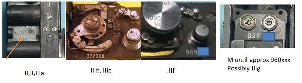

Anbaric Posted June 14, 2022 Share #9 Â Posted June 14, 2022 7 hours ago, DoubleE said: Could this be a factory installed option, or possibly a special order item from Leitz, or is it some kind of aftermarket job? You could ask info@leica-camera.com if they have any relevant information on this one. Last year I got a helpful response in a few days when asking about the original delivery records of a Leica from the 1930s. Link to post Share on other sites More sharing options...
DoubleE Posted June 14, 2022 Author Share #10  Posted June 14, 2022 2 hours ago, earleygallery said: Possibly an M2 top plate, from a parts camera, modified with an 'M3 counter window' and stuck onto an (damaged top plate) M3? Pretty much what Sherry Krauter (who did the CLA) told me today. She has no idea how the top plate came to be, though. She also told me it was the personal camera of a camera tech, now deceased, so we can't ask him about it, but he had access to parts and to the factory. I notice that there is no bezel around the lens release button, another M2 feature, and that's on the body shell. Film advance and shutter release are about the smoothest I've handled on an M camera, and it makes a lot of sense to me personally to have this feature set, plus it was priced right, so after much deliberation and seconds thoughts, I bought it. 6 Link to post Share on other sites More sharing options...
earleygallery Posted June 14, 2022 Share #11  Posted June 14, 2022 5 minutes ago, DoubleE said: Pretty much what Sherry Krauter (who did the CLA) told me today. She has no idea how the top plate came to be, though. She also told me it was the personal camera of a camera tech, now deceased, so we can't ask him about it, but he had access to parts and to the factory. I notice that there is no bezel around the lens release button, another M2 feature, and that's on the body shell. Film advance and shutter release are about the smoothest I've handled on an M camera, and it makes a lot of sense to me personally to have this feature set, plus it was priced right, so after much deliberation and seconds thoughts, I bought it. Well it's certainly unique! Could she tell if the internals were from an M3? (I think also that the serial number is engraved inside chassis, and should of course match the top plate, although maybe that's just on the earlier cameras). Link to post Share on other sites More sharing options...
DoubleE Posted June 14, 2022 Author Share #12 Â Posted June 14, 2022 45 minutes ago, earleygallery said: Well it's certainly unique! Could she tell if the internals were from an M3? (I think also that the serial number is engraved inside chassis, and should of course match the top plate, although maybe that's just on the earlier cameras). She said the internals are M3. Â Late model so no internal number. I will email Leica, just on the off chance they have some record of it. 2 Link to post Share on other sites More sharing options...
