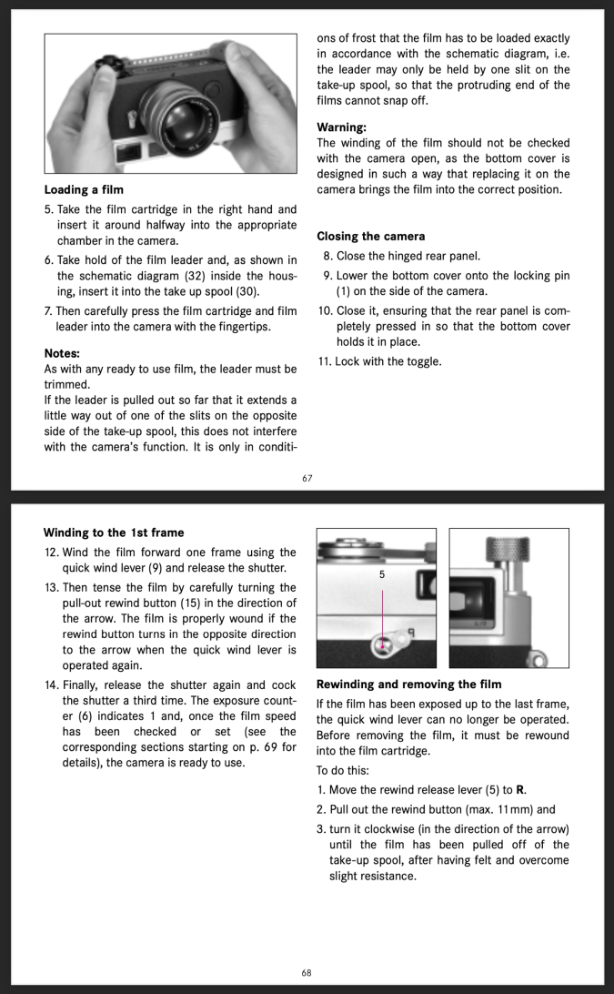

nikrasov Posted June 6, 2022 Share #8 Posted June 6, 2022 I also have a question about loading the film. Quote from the manual: "Winding to the 1st frame 12. Advance the film by one frame using the quick wind lever (19) and release the shutter. 13. Then tension the film by carefully turning the rewind knob*(10a) or the rewind crank* (10b) in the direction of the arrow. ..." When I turn the rewind knob it just rotates endlessly. Is it ok or it should stick when film gets tension? Link to post Share on other sites More sharing options...

madNbad Posted June 6, 2022 Share #10 Posted June 6, 2022 5 minutes ago, nikrasov said: I also have a question about loading the film. Quote from the manual: "Winding to the 1st frame 12. Advance the film by one frame using the quick wind lever (19) and release the shutter. 13. Then tension the film by carefully turning the rewind knob*(10a) or the rewind crank* (10b) in the direction of the arrow. ..." When I turn the rewind knob it just rotates endlessly. Is it ok or it should stick when film gets tension? Follow the diagram on the bottom of the camera and try not to do any of the suggested improvements, the wheel on the baseplate wii do the work. Pull enough leader to drop into the slots in the take up. When you insert the film cassette, make sure it is all the way in the chamber and is engaging the rewind. Replace the baseplate and wind. You may have to turn the knob a bit to tighten the film in the cassette and then check the rewind knob to ensure it is moving when you advance the film. It will become second nature soon enough. Welcome to the forum. 1 Link to post Share on other sites More sharing options...
hillavoider Posted June 6, 2022 Share #11 Posted June 6, 2022 6 minutes ago, Mute-on said: I’ve never tensioned the film. I imagine if you do so after winding on only one frame, you could fairly easily pull the film out of the tulip. Wind on once. Release shutter. Close back. Wind on again, release shutter, wind on again while observing rewind knob rotate. Take your first photo. Proceed. i agree with this 1 Link to post Share on other sites More sharing options...
250swb Posted June 6, 2022 Share #12 Posted June 6, 2022 Two things. People are often to greedy and want to save every frame, for insurance wind on a second time while loading. The idea of rewinding the film while getting to frame #1 is because films unravel in the cassette, it needs to be wound tight so when you wind on to frame #1 you immediately see the two little red blobs turning. You can't pull the film off the tulip by tensioning the film because the toothed sprocket engaged in the films sprocket holes only rotates one way, unless you also have the rewind lever down which disengages those gears, but if that happens you have far bigger problems. 1 Link to post Share on other sites More sharing options...
nikrasov Posted June 6, 2022 Share #13 Posted June 6, 2022 Should I feel rewind knob stuck when rotate it to make film tension? As I understand I should not pull up rewind knob according to this manual instructions. Also, any difference it is pulled up or not? Link to post Share on other sites More sharing options...
a.noctilux Posted June 6, 2022 Share #14 Posted June 6, 2022 1 hour ago, nikrasov said: Should I feel rewind knob stuck when rotate it to make film tension? As I understand I should not pull up rewind knob according to this manual instructions. Also, any difference it is pulled up or not? With MP rewind knob, two stages : - when pushed in only the inside part with two red dots is connected to film - when pulled up knob the connection to film is established with the knob - so when you want to tension the film as stated in the manual, you need to pull up the knob - as wrote above, the tensioning is not mandatory, just observe the two dots moving when you wind-on the first frames. Link to post Share on other sites More sharing options...
plaidshirts Posted June 6, 2022 Share #15 Posted June 6, 2022 5 hours ago, nikrasov said: I also have a question about loading the film. Quote from the manual: "Winding to the 1st frame 12. Advance the film by one frame using the quick wind lever (19) and release the shutter. 13. Then tension the film by carefully turning the rewind knob*(10a) or the rewind crank* (10b) in the direction of the arrow. ..." When I turn the rewind knob it just rotates endlessly. Is it ok or it should stick when film gets tension? Rewind it carefully enough to feel tension. It’s a tactile way to verify that the film has been loaded correctly, in addition to the visual one of seeing the rewind knob rotate. Link to post Share on other sites More sharing options...
plaidshirts Posted June 6, 2022 Share #16 Posted June 6, 2022 3 hours ago, nikrasov said: Should I feel rewind knob stuck when rotate it to make film tension? As I understand I should not pull up rewind knob according to this manual instructions. Also, any difference it is pulled up or not? You have to pull the knob up as if you were rewinding the film to make this work. If you don’t, it’ll simply turn forever. Link to post Share on other sites More sharing options...
