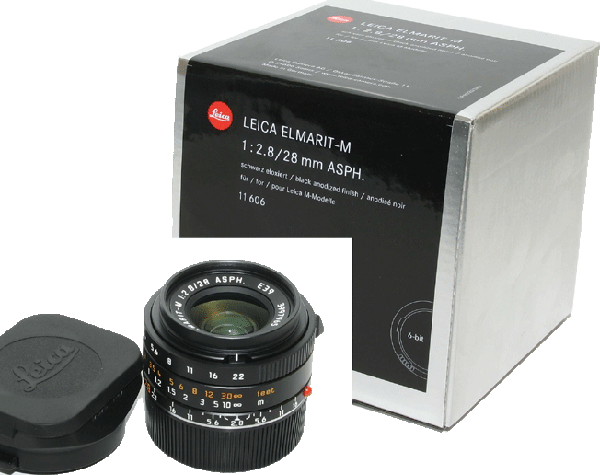

Guest Posted March 23, 2022 Share #22 Posted March 23, 2022 (edited) 43 minutes ago, lct said: Thank you @mzbe. By "older 28" do you mean the Elmarit 28/2.8 asph v1 below?. Also how would you compare the M11 to M10P and/or M10R re corner quality putting aside M10M and SL2 if i may ask? Welcome, dear visitor! As registered member you'd see an image here… Simply register for free here – We are always happy to welcome new members! I don't know which lenses work better or worse at this point, thanks for asking for clarification - when I say "older", history of Leica Ms illustrates that "pre-digital" lenses designed for film had greater issues on several generations of Ms over time (... good source to appreciate the journey would be Leica forums and reviews, including e.g. Overgaard and this forum). I have found the most systematic resource for comparison of many generations of specifically Leica cameras is Reidreviews, as Sean Reid has repeated the exact same test setup over many years, using the same lenses on different bodies. This would allow you to confirm the corner resolution observations without having to do too much leg work (just check the reviews of the same lenses on different bodies and do a side by side comparison). loyd Chambers also has done some good analysis over the years, with perhaps some not so fond feelings about Leica (I have recently stopped to visit his site due to his political content). Fred Miranda on his eponymous site also does a great job in a consistent way to compare lenses and bodies in his extensive reviews, he is a M mount aficionado and good source of comparison across many examples of M240/M10 vs. "non M" lens/body combinations. I feel that M11 is starting to show some of those characteristics that he reported from "non M" cameras with M lenses. Edited March 23, 2022 by Guest Link to post Share on other sites More sharing options...
lct Posted March 23, 2022 Share #23 Posted March 23, 2022 (edited) I wonder if you're forgetting sensor stack thickness folks. Any info about that on the M11? The fact (?) that it performs better on 28/2.8 asph v2 than v1 might mean that... or not? Edited March 23, 2022 by lct Link to post Share on other sites More sharing options...
lct Posted March 23, 2022 Share #24 Posted March 23, 2022 3 minutes ago, mzbe said: I don't know which lenses work better or worse at this point, thanks for asking for clarification - when I say "older", history of Leica Ms illustrates that "pre-digital" lenses designed for film had greater issues on several generations of Ms over time (... good source to appreciate the journey would be Leica forums and reviews, including e.g. Overgaard and this forum). I have found the most systematic resource for comparison of many generations of specifically Leica cameras is Reidreviews, as Sean Reid has repeated the exact same test setup over many years, using the same lenses on different bodies. This would allow you to confirm the corner resolution observations without having to do too much leg work (just check the reviews of the same lenses on different bodies and do a side by side comparison). loyd Chambers also has done some good analysis over the years, with perhaps some not so fond feelings about Leica (I have recently stopped to visit his site due to his political content). Fred Miranda on his eponymous site also does a great job in a consistent way to compare lenses and bodies in his extensive reviews, he is a M mount aficionado and good source of comparison across many examples of M240/M10 vs. "non M" lens/body combinations. I feel that M11 is starting to show some of those characteristics that he reported from "non M" cameras with M lenses. I wondered if you have a personal experience with the 28/2.8 asph v1 because it is mentioned by RR and is known as a rather difficult lens. Now i have nothing against RR or any other reviewer but i prefer personal experiences of colleagues here, let alone that "reviews" based on closeups or short distance subject matters are of limited interest to me. YMMV . 1 Link to post Share on other sites More sharing options...
