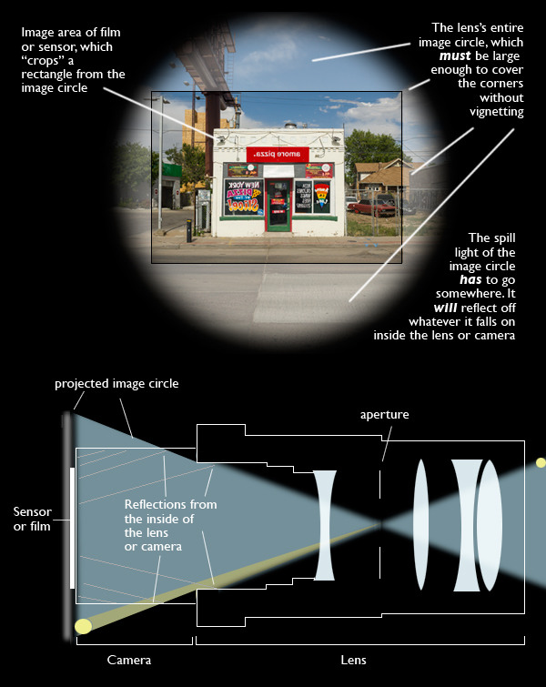

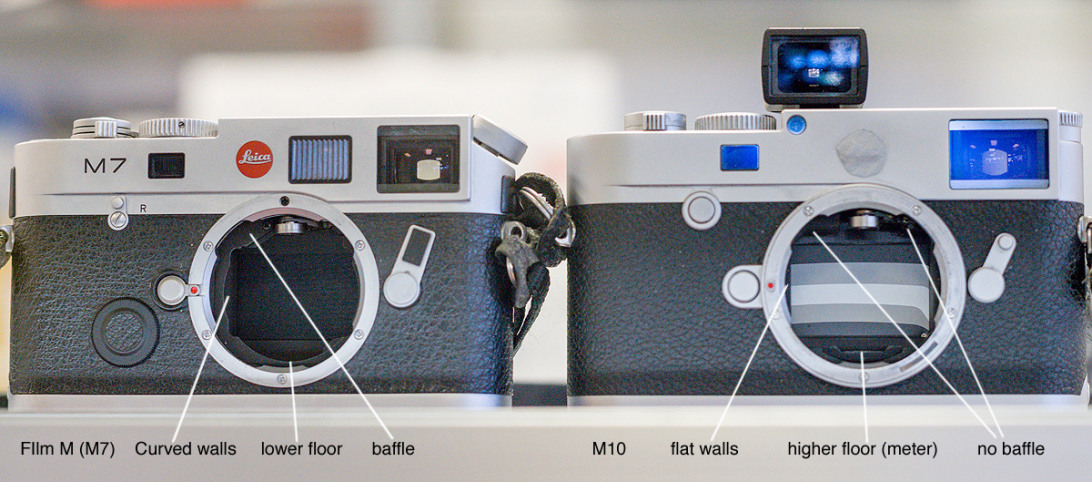

adan Posted July 24, 2021 Share #22  Posted July 24, 2021 (edited) On 7/22/2021 at 7:16 AM, andba said: I recently picked up an M10-P and a 35mm Summilux FLE. Looking for a good 90mm to pair with the setup. Here's my take - having spent most of the Covid year (re)experimenting with a raft of Leica 90s, and most importantly, on an M10 specifically. Most of them flare on the M10, if/when there is bright light (sun or spotlight or big window) just outside the picture area. With or without appropriate lens hood. I suspect reflections from the inside of the M10, where the "shutter chamber" has been squeezed in all around the shutter opening much more tightly (compared to film Ms), to allow the smaller overall body size, while still fitting in the electronics. Additionally the film Ms have a specific baffle around the lens mount - which shows Leica is well-aware of the potential for internal reflections like this. Welcome, dear visitor! As registered member you'd see an image here… Simply register for free here – We are always happy to welcome new members! For me, it appears to be a "90-only" issue for some reason - various 75s (APO-Summicron, C/V Heliar and Nokton) and my 135 Tele-Elmar are much less flare-prone in the same situations. May have to do with angle of incidence, field of view, distance of the exit pupil from the image plane, or amount of vignetting (which will subdue spill-light "around" the image area, and reduce this kind of flare). Frankly, under the "wrong" (but often nice) back-lighting, the 90 Summarit f/2.5 is as bad or worse as the always flare-prone Tele-Elmarit-M - on my M10s. The 90 Elmarit-M was barely better. A Summicron pre-APO had the least (most vignetting wide open) - but of course is 450-500g. Unavailable for testing were the 90 Macro, 90 Elmar-C and 90 APO-Summicron. (This is something Leica is going to have to address in digital Ms eventually - or it may be why they have dropped all their 90 f/2.5-f/2.8 lenses - but that's for another thread.)  . ......................... My solution was - if I am going to have to worry about 90mm flare in any case, just get the Tele-Elmarit-M for its extreme compactness and light weight. One turned up on my local shop shelf this week. And have my 75 Nokton available for flare-prone situations. To andba I would say - test any individual 90mm M lens you may be considering, for flare on your M10-P, as well as focusing on your camera.  Edited July 24, 2021 by adan 4 3 Link to post Share on other sites Simply register for free here – We are always happy to welcome new members! For me, it appears to be a "90-only" issue for some reason - various 75s (APO-Summicron, C/V Heliar and Nokton) and my 135 Tele-Elmar are much less flare-prone in the same situations. May have to do with angle of incidence, field of view, distance of the exit pupil from the image plane, or amount of vignetting (which will subdue spill-light "around" the image area, and reduce this kind of flare). Frankly, under the "wrong" (but often nice) back-lighting, the 90 Summarit f/2.5 is as bad or worse as the always flare-prone Tele-Elmarit-M - on my M10s. The 90 Elmarit-M was barely better. A Summicron pre-APO had the least (most vignetting wide open) - but of course is 450-500g. Unavailable for testing were the 90 Macro, 90 Elmar-C and 90 APO-Summicron. (This is something Leica is going to have to address in digital Ms eventually - or it may be why they have dropped all their 90 f/2.5-f/2.8 lenses - but that's for another thread.)  . ......................... My solution was - if I am going to have to worry about 90mm flare in any case, just get the Tele-Elmarit-M for its extreme compactness and light weight. One turned up on my local shop shelf this week. And have my 75 Nokton available for flare-prone situations. To andba I would say - test any individual 90mm M lens you may be considering, for flare on your M10-P, as well as focusing on your camera.  ' data-webShareUrl='https://www.l-camera-forum.com/topic/322907-navigating-the-choppy-waters-of-90mm-options/?do=findComment&comment=4244060'>More sharing options...
