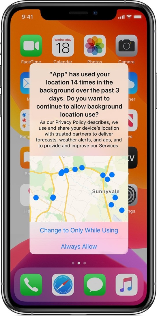

hotshew Posted November 24, 2019 Author Share #6 Posted November 24, 2019 Quote How can you tell whether Fotos 2.0, as just released, is using BTLE or WiFi for the GPS updates? The only way to know for sure would be to confirm w/ Leica or to sniff via a protocol analyzer. Regardless of technical implementation, the resultant use case is that GPS tagging requires Fotos to be open and connected to the camera. Since you're an S1R user, you won't see the message notifying you Fotos is using location service in the background, similar to Lumix Sync (or Fuji Remote, Nikon SnapBridge, etc.) -- assuming you're an iPhone user. If Fotos is using Bluetooth for GPS tagging, then it's a technical implementation that has no end-user benefit over Wi-Fi if the connection does not persist after the Wi-Fi connection is lost. Here is what the manual says: Quote The GPS (global positioning system) allows the pinpointing of a receiver anywhere in the world. The GPS function is activated automatically when a connection to the Leica FOTOS app is active and if the GPS function is active on the mobile device. The camera will then continuously receive the current GPS data (latitude and longitude, elevation above sea level) and writes this information into the Exif data of the images. ▸ Activate the GPS function on the mobile device▸ Activate Leica FOTOS and connect to the camera • This function is available only as long as the camera is on line with the Leica FOTOS app. Opening the Fotos app requires a Wi-Fi connection to be established to the phone -- the process takes about 20 seconds, and the user needs to give permission to connect via a join prompt each time the app is opened. Once connected, there's a blue LED that flashes on the back of the camera to indicate it's connected. The blue color could suggest a Bluetooth connection, but again, a Wi-Fi connection is required for Fotos to function. After the camera goes to sleep or is turned off, the Wi-Fi connection is lost and the user must re-establish a connection using the same process as before. This is fine for remote control scenarios, but as initially indicated, it renders GPS tagging virtually useless for my purposes. I stand corrected regarding one comment I made above. I read elsewhere that GPS tagging requires the image to be captured using the Fotos app. However, I decided to check for myself and discovered that GPS tagging works provided Fotos is connected to the camera (i.e., can press the shutter button on the camera to capture and tagging works). I haven't tested extensively but presume that tagging works when the blue LED is flashing. Link to post Share on other sites More sharing options...

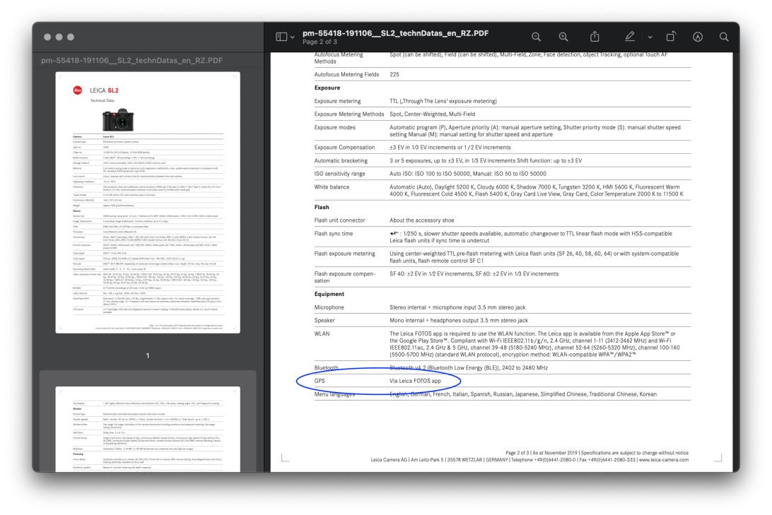

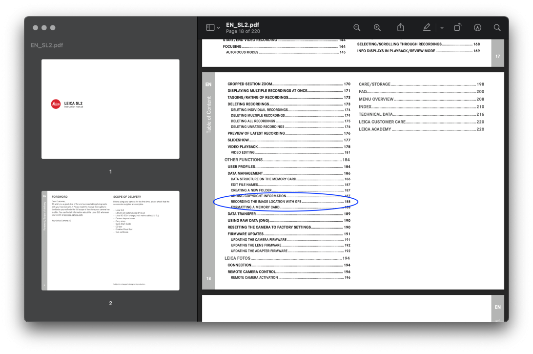

BCMielke Posted November 24, 2019 Share #8 Posted November 24, 2019 39 minutes ago, hotshew said: The only way to know for sure would be to confirm w/ Leica or to sniff via a protocol analyzer. Regardless of technical implementation, the resultant use case is that GPS tagging requires Fotos to be open and connected to the camera. Since you're an S1R user, you won't see the message notifying you Fotos is using location service in the background, similar to Lumix Sync (or Fuji Remote, Nikon SnapBridge, etc.) -- assuming you're an iPhone user. If Fotos is using Bluetooth for GPS tagging, then it's a technical implementation that has no end-user benefit over Wi-Fi if the connection does not persist after the Wi-Fi connection is lost. Here is what the manual says: Opening the Fotos app requires a Wi-Fi connection to be established to the phone -- the process takes about 20 seconds, and the user needs to give permission to connect via a join prompt each time the app is opened. Once connected, there's a blue LED that flashes on the back of the camera to indicate it's connected. The blue color could suggest a Bluetooth connection, but again, a Wi-Fi connection is required for Fotos to function. After the camera goes to sleep or is turned off, the Wi-Fi connection is lost and the user must re-establish a connection using the same process as before. This is fine for remote control scenarios, but as initially indicated, it renders GPS tagging virtually useless for my purposes. I stand corrected regarding one comment I made above. I read elsewhere that GPS tagging requires the image to be captured using the Fotos app. However, I decided to check for myself and discovered that GPS tagging works provided Fotos is connected to the camera (i.e., can press the shutter button on the camera to capture and tagging works). I haven't tested extensively but presume that tagging works when the blue LED is flashing. I can confirm that it works this way as well. I was using my Q2, but from my understanding it should be the same. However, with it connected to the app you are not able to have access to the menus. I did some googling and didn't see much information on the Fotos app that says otherwise. If this is the GPS functionality it is very limited. Link to post Share on other sites More sharing options...
