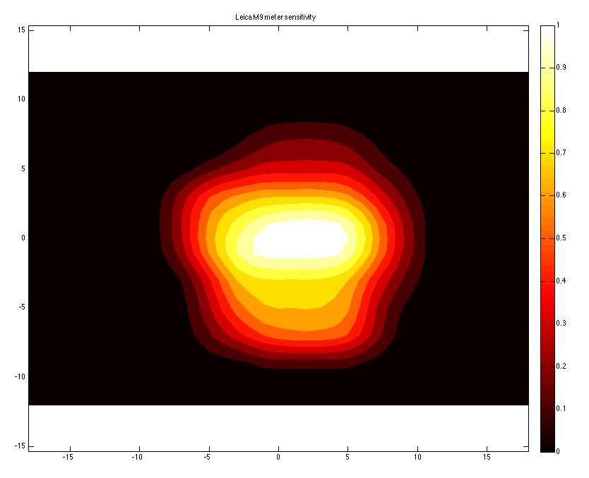

jaapv Posted July 31, 2018 Share #8 Posted July 31, 2018 It may well be that the term "centre-weighed" is confusing to some. Let's analyse the metering pattern, as it is more like a extended spot meter than a gradual centre-weighed. Once one has the pattern in mind, the use of the meter becomes self-explaining. courtesy Lindolfi, from the Leica M FAQ Welcome, dear visitor! As registered member you'd see an image here… Simply register for free here – We are always happy to welcome new members! This also shows that it is rather useless to set a fixed exposure compensation, as the amount of compensation needed depends entirely on the position of the highlights and shadows. The best way to go about it is to treat it as a real spot meter and point the centre of the viewfinder at the essential part of the image and recompose, much as you are doing with the focusing. So: point-focus-half-press-recompose-shoot. Or, even better, don't use "A" and half-press, but manual exposure. That is basically what the camera does best. 4 Link to post Share on other sites Simply register for free here – We are always happy to welcome new members! This also shows that it is rather useless to set a fixed exposure compensation, as the amount of compensation needed depends entirely on the position of the highlights and shadows. The best way to go about it is to treat it as a real spot meter and point the centre of the viewfinder at the essential part of the image and recompose, much as you are doing with the focusing. So: point-focus-half-press-recompose-shoot. Or, even better, don't use "A" and half-press, but manual exposure. That is basically what the camera does best. ' data-webShareUrl='https://www.l-camera-forum.com/topic/287113-leica-m10-light-meter-underexposing/?do=findComment&comment=3564556'>More sharing options...
