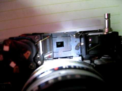

adan Posted January 30, 2017 Share #64 Posted January 30, 2017 (edited) To be exact - the framelines in all M cameras thus far, including the M10, are still physical slits cut into a black mask (actually two masks, that slide past one another to hide or reveal pairs of lines). Like a stencil. They are backlit by LEDs in the M240 and later cameras, but the lines are not LEDs themselves, just slits in some material. I can't find a decent picture of Leica's own masks (they are buried inside the RF mechanism), but they are physically just like this mask for a small fixed-lens rangefinder - physical slits and holes in metal: https://i.ytimg.com/vi/mG8qEEVYORQ/hqdefault.jpg Actually, here's a better picture, of adjustable masks for multiple focal lengths, from the Epson/Cosina R-D1 digital rangefinder - Leica uses a similar system: https://cameraquest.com/Epson-R-D1/_r-d1/images/frameline_mask.jpg Edited January 30, 2017 by adan 1 Link to post Share on other sites More sharing options...

Jeff S Posted February 1, 2017 Share #79 Posted February 1, 2017 I can't find a decent picture of Leica's own masks (they are buried inside the RF mechanism), but they are physically just like this mask for a small fixed-lens rangefinder - physical slits and holes in metal: https://i.ytimg.com/vi/mG8qEEVYORQ/hqdefault.jpg Let's not forget Mark Norton's more extensive investigation... http://www.l-camera-forum.com/topic/66999-anatomy-of-the-leica-m8-framelines/ Or the entire inside (M8).... http://www.l-camera-forum.com/topic/21079-anatomy-of-the-leica-m8/ Jeff Link to post Share on other sites More sharing options...
adan Posted February 1, 2017 Share #80 Posted February 1, 2017 Jeff - roger that, and thanks. Unfortunately mark's pix don't get captured by Google search. Anyway, we've probably beaten that horse to death. If Leica gets around to LCD (not LED) finder graphics, then we can get any one frameline we want - until then, we get the steam-punk metal framelines with their limitations. Link to post Share on other sites More sharing options...
