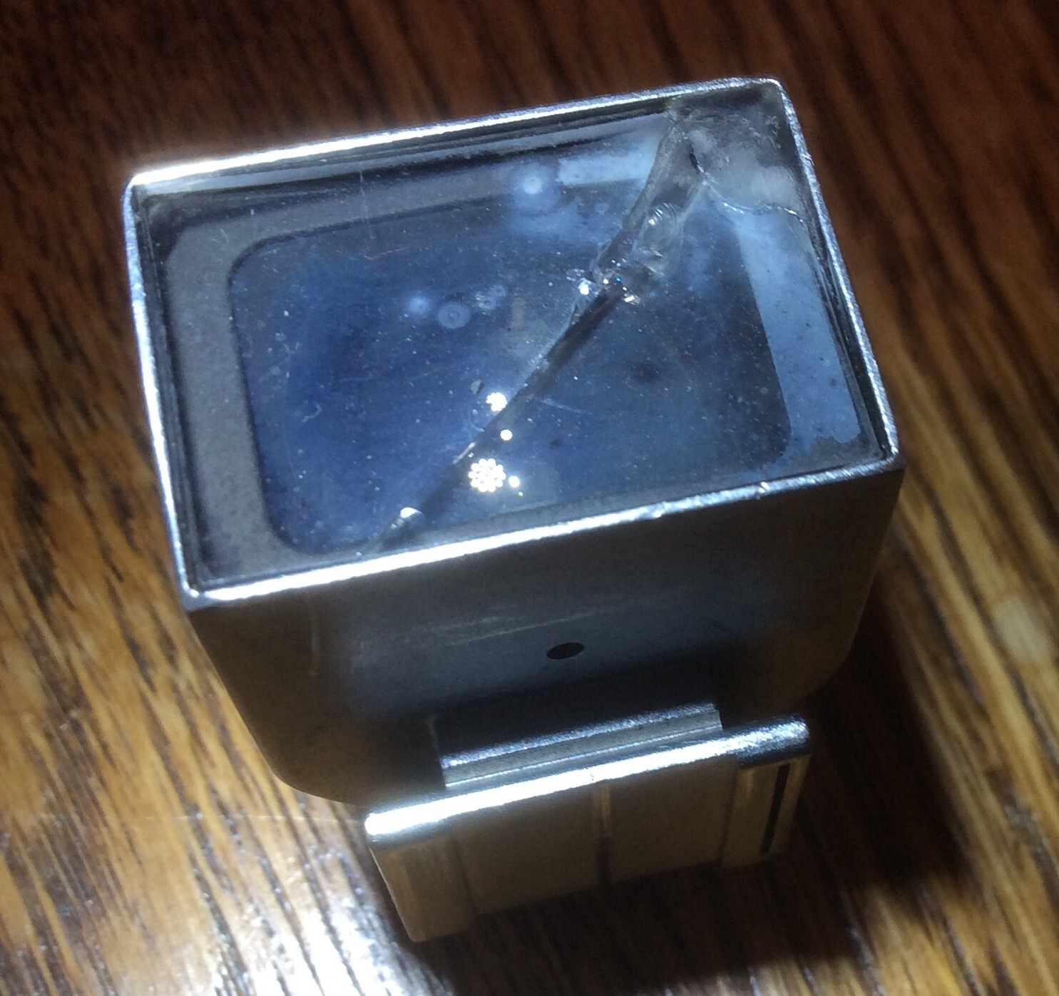

Pyrogallol Posted February 24, 2023 Share #35 Posted February 24, 2023 (edited) 1 hour ago, marinacpopaj said: Had a very similar thing happen to me with a mint condition Leitz Colorplan 90mm the other day The coating developed clearly visible holes... at least I was able to fully remove it afterwards Welcome to the forum with your first posting. Something to look for when replying to a posting is to look at the dates. The last posting before yours was over 11 years ago ! I used some superglue to reinforce the broken glass corner of this cheap 21mm finder and it put a haze over the glass. Welcome, dear visitor! As registered member you'd see an image here… Simply register for free here – We are always happy to welcome new members! Edited February 24, 2023 by Pyrogallol 1 Link to post Share on other sites Simply register for free here – We are always happy to welcome new members! ' data-webShareUrl='https://www.l-camera-forum.com/topic/165460-danger-superglue-fumes-and-lens-coatings/?do=findComment&comment=4699133'>More sharing options...

Pyrogallol Posted February 22, 2024 Share #39 Posted February 22, 2024 This 21mm finder had a chip out of the corner as well as a crack across the glass. I put a drop of superglue in the corner to hold it together but that spread a haze over the glass. Still usable, the viewfinder still finds the view. Welcome, dear visitor! As registered member you'd see an image here… Simply register for free here – We are always happy to welcome new members! Link to post Share on other sites Simply register for free here – We are always happy to welcome new members! ' data-webShareUrl='https://www.l-camera-forum.com/topic/165460-danger-superglue-fumes-and-lens-coatings/?do=findComment&comment=5052043'>More sharing options...
250swb Posted February 22, 2024 Share #40 Posted February 22, 2024 2 hours ago, Pyrogallol said: This 21mm finder had a chip out of the corner as well as a crack across the glass. I put a drop of superglue in the corner to hold it together but that spread a haze over the glass. Still usable, the viewfinder still finds the view. Welcome, dear visitor! As registered member you'd see an image here… Simply register for free here – We are always happy to welcome new members! If the haze is on the outside, or you can get to the inside, you could try superglue debonder (often used for spills or fingers stuck together) applied with a cotton bud. Link to post Share on other sites More sharing options...
