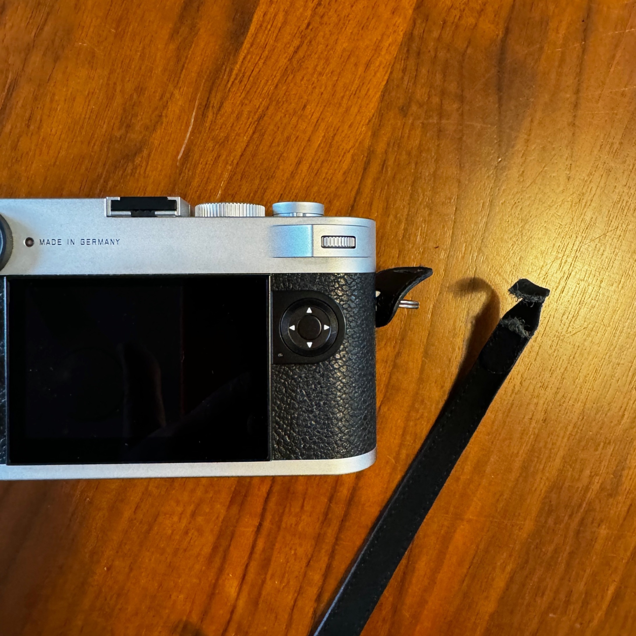

cornelbrad Posted March 8, 2024 Share #1 Posted March 8, 2024 Advertisement (gone after registration) Hi to all, a possible problem for the one of us using the original leather strap from M11: mine tears apart without any pressure applied on it, it looks like the material had a weak quality. I was lucky to catch the camera before to hit the ground. If you will consider, you better check or change it. IMG_9337 2.HEIC IMG_9334.HEIC 1 1 Quote Link to post Share on other sites More sharing options...

cornelbrad Posted March 13, 2024 Author Share #3 Posted March 13, 2024 On 3/8/2024 at 3:42 PM, M9reno said: Could you please upload these images? Welcome, dear visitor! As registered member you'd see an image here… Simply register for free here – We are always happy to welcome new members! 2 1 Quote Link to post Share on other sites Simply register for free here – We are always happy to welcome new members! ' data-webShareUrl='https://www.l-camera-forum.com/topic/390546-original-leather-strap-tear-apart/?do=findComment&comment=5095783'>More sharing options...
Knightspirit Posted March 14, 2024 Share #4 Posted March 14, 2024 Yikes - thanks for the heads up - I’m currently using the same strap ! Let’s hope it was a one off problem having more to do with the particular cow whose hide was used for that one… Quote Link to post Share on other sites More sharing options...
cornelbrad Posted March 20, 2024 Author Share #5 Posted March 20, 2024 On 3/14/2024 at 4:07 AM, Knightspirit said: Yikes - thanks for the heads up - I’m currently using the same strap ! Let’s hope it was a one off problem having more to do with the particular cow whose hide was used for that one… I definitely not recommend to use this type of strap. Remembering the moment I catch the camera gives me shivers. Pure luck for me. Quote Link to post Share on other sites More sharing options...

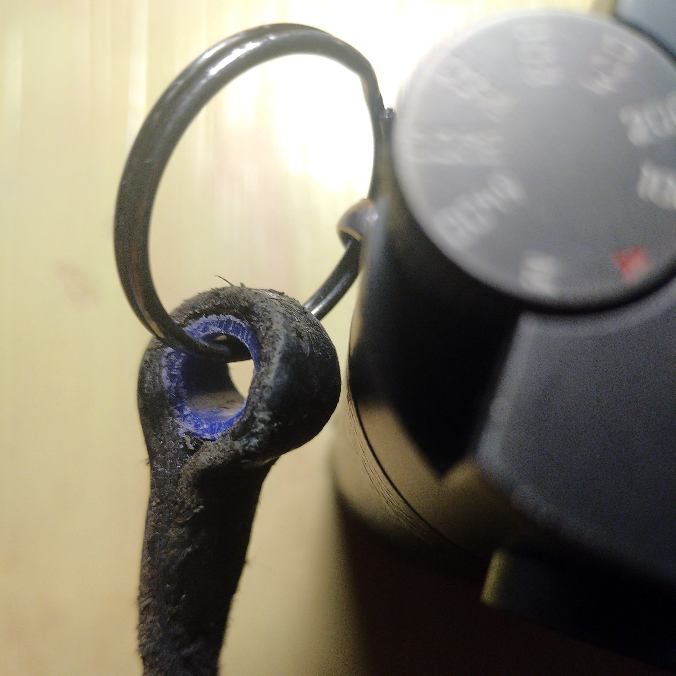

adan Posted March 20, 2024 Share #6 Posted March 20, 2024 (edited) Yah, I had the same happen with the visually-identical M10 "thin-leather" strap. The O-ring entry-slits tend to chew up the strap material where it goes through the ring and the ironically-named "camera protection pad." (I was not able to catch my camera! The first I knew of the strap failure was when the torn end whacked my ear on its way past. Fortunately my 75 Nokton f/1.5 took the brunt of the impact on cement (and took it like a champ - just needed a little straightening of the bent filter ring, plus prying to loosen the slightly-dented/jammed aperture ring - worked perfectly ever since.) I immediately tracked down some of the slightly older (M typ 240? M9?) straps as shown in the links below - tougher woven nylon web, with the LEICA logo on a molded-in rubber shoulder pad, and a "D" or "O"-ring that has a sliding lock - and no sharp edges to damage the strap. But they will require some way to protect the black M10/11 camera finishes from rub marks (tape the camera top plate ends?) The M9/M typ 240 came with built-in plastic rub pads on the bodies - shame on Leica for abandoning that much more elegant attachment system (in the engineering sense). Seem to be two similar Leica products. 14312 and/or 14253. https://www.keh.com/leica-14312-carrying-srap-231044.html?aid=230820-2621977&utm_source=google_shopping&utm_medium=organic&utm_campaign=Leica&utm_term=230820-2621977&gad_source=1&gclid=EAIaIQobChMIuvbgxLaDhQMVPS-tBh38cgOkEAQYASABEgK7r_D_BwE https://www.keh.com/leica-m-fiber-blk-14253-219932.html?aid=230819-757805&utm_source=google_shopping&utm_medium=organic&utm_campaign=Leica&utm_term=230819-757805&gad_source=1&gclid=EAIaIQobChMI7sH3qbODhQMVqy-tBh2vUQLTEAQYAyABEgKXWfD_BwE Edited March 20, 2024 by adan 1 Quote Link to post Share on other sites More sharing options...

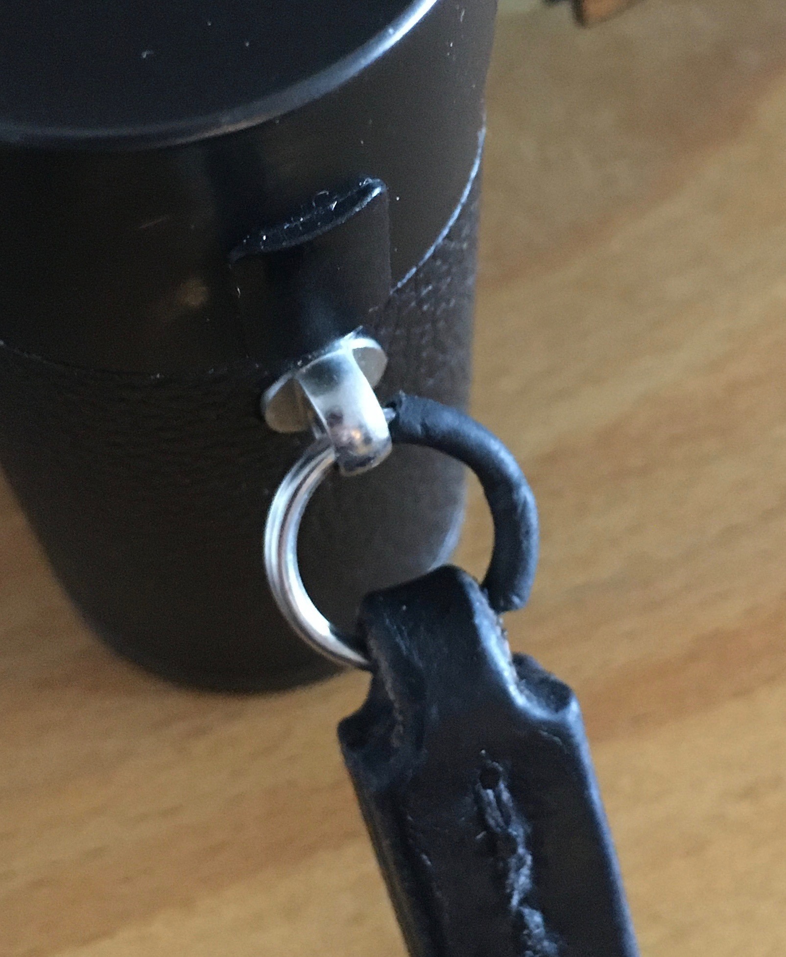

Edax Posted March 20, 2024 Share #8 Posted March 20, 2024 Interestingly the 5 months old M11-P strap over here has already more signs of wear than the 6 years old strap on the M10. Well, a warned person... 🙃 Quote Link to post Share on other sites More sharing options...

jaapv Posted April 2, 2024 Share #11 Posted April 2, 2024 I don’t like split rings. They do damage. I always use Peak anchors. They have wear warnings as well. 3 1 Quote Link to post Share on other sites More sharing options...
jaapv Posted April 2, 2024 Share #12 Posted April 2, 2024 I have seen worn eyelets. 1 1 Quote Link to post Share on other sites More sharing options...

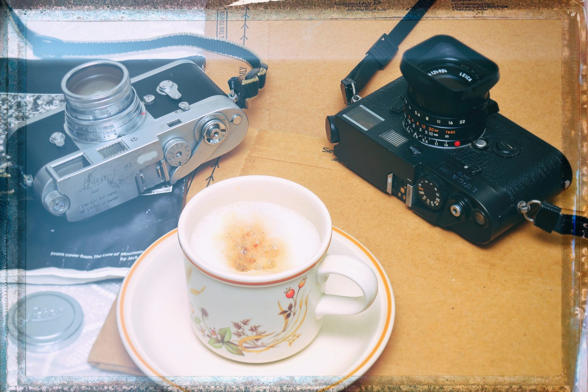

pgk Posted April 2, 2024 Share #13 Posted April 2, 2024 I never understand the logic in using anything other than the nylon straps which have been supplied by Leica for decades. Strong, not subject to undue wear and I've never known one to fail. The camera is expensive, the strong nylon strap is not and it does what it is supposed to do effectively and reliably. I do not use, and never have, leather straps, and probably never will. 3 1 Quote Link to post Share on other sites More sharing options...
Anbaric Posted April 2, 2024 Share #14 Posted April 2, 2024 (edited) 25 minutes ago, pgk said: I never understand the logic in using anything other than the nylon straps which have been supplied by Leica for decades. Strong, not subject to undue wear and I've never known one to fail. The camera is expensive, the strong nylon strap is not and it does what it is supposed to do effectively and reliably. I do not use, and never have, leather straps, and probably never will. Unfortunately this is now Leica logic - they no longer supply those nylon straps (like the 14312 above) either with the cameras or even as optional accessories. I guess they just don't fit with the brand image these days. Which is a pity because, in combination with the rub protectors they began fitting to the later M6 Classic bodies (but dropped after the M7), they had a nice, flexible, easy to fit but secure system that doesn't damage the top plate. Edited April 2, 2024 by Anbaric 3 Quote Link to post Share on other sites More sharing options...
pgk Posted April 2, 2024 Share #15 Posted April 2, 2024 28 minutes ago, Anbaric said: Unfortunately this is now Leica logic - they no longer supply those nylon straps (like the 14312 above) ..... Ouch. Ebay prices! Quote Link to post Share on other sites More sharing options...
