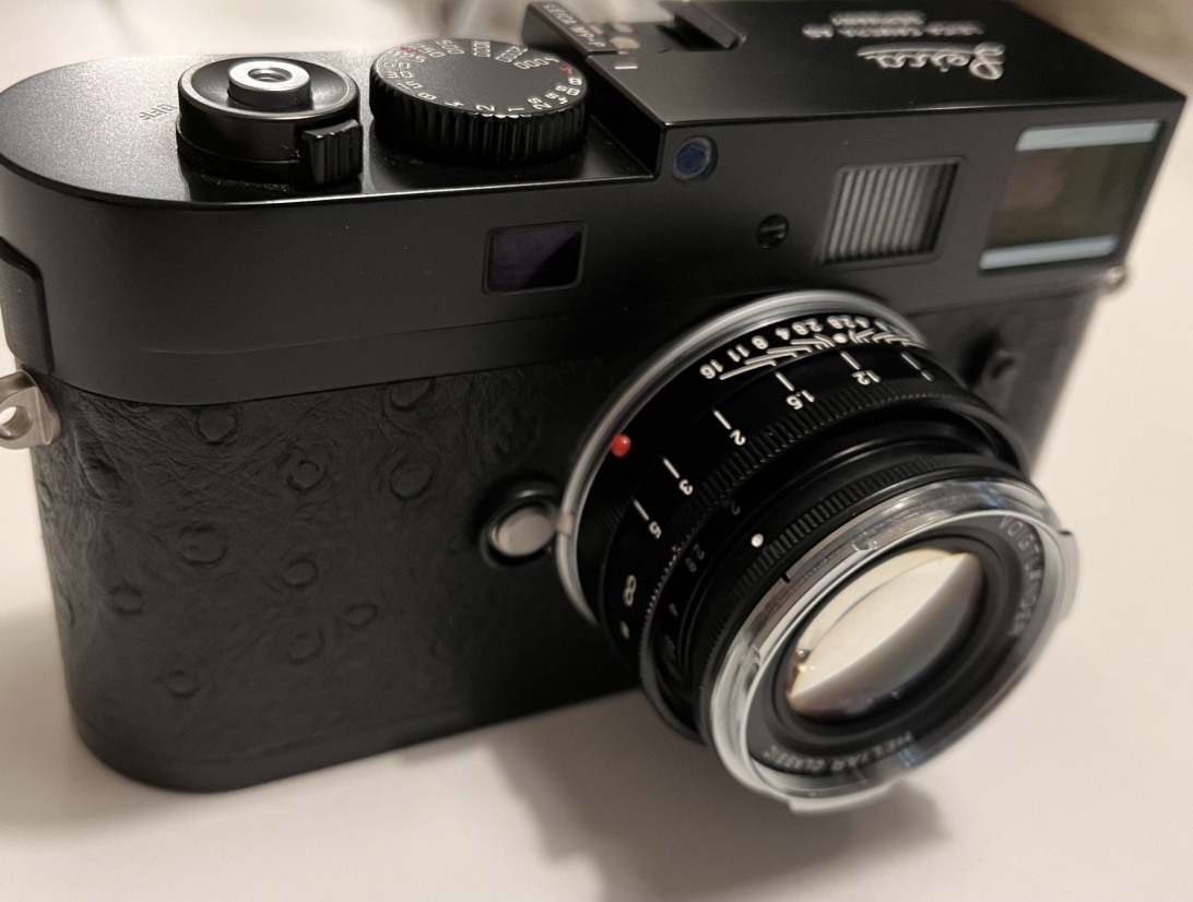

Pyrogallol Posted October 17, 2023 Share #17 Posted October 17, 2023 40mm Voigtlander Heliar, available in screw or bayonet. Take the hood off and it’s even smaller. Welcome, dear visitor! As registered member you'd see an image here… Simply register for free here – We are always happy to welcome new members! Link to post Share on other sites Simply register for free here – We are always happy to welcome new members! ' data-webShareUrl='https://www.l-camera-forum.com/topic/383010-tiny-50mm-f2-lenses-recommendation/?do=findComment&comment=4876982'>More sharing options...
